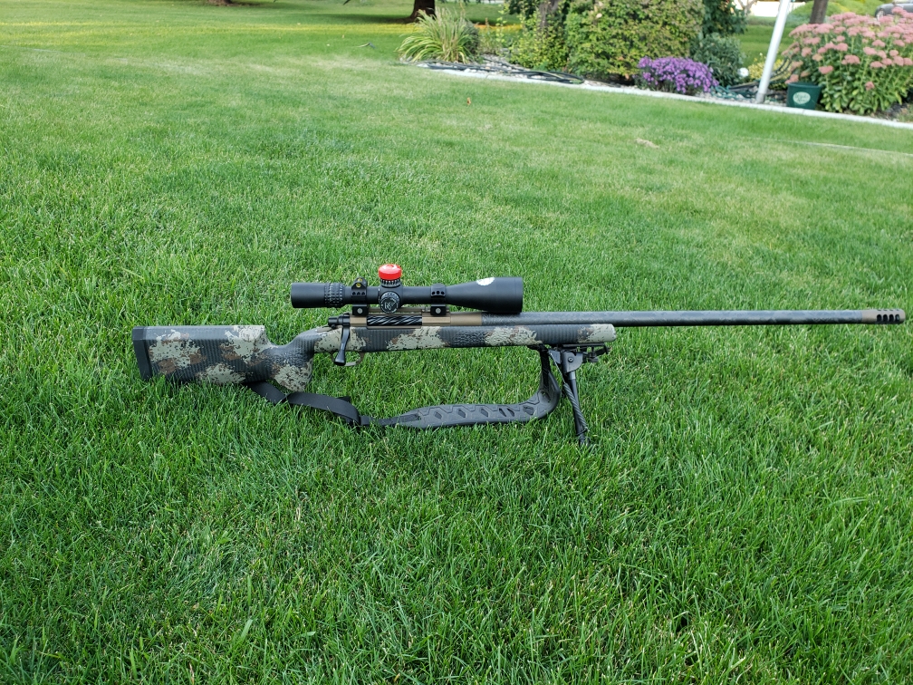

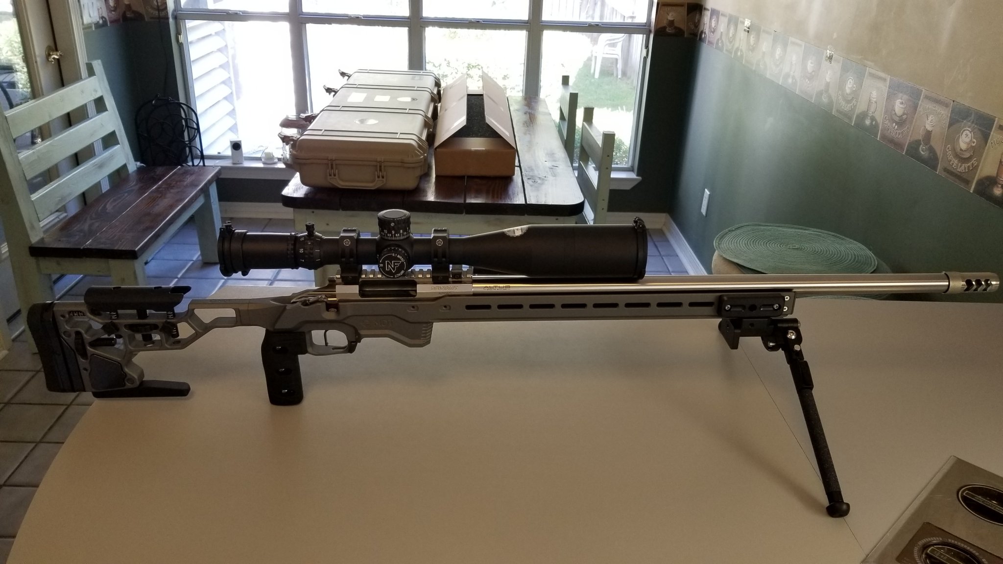

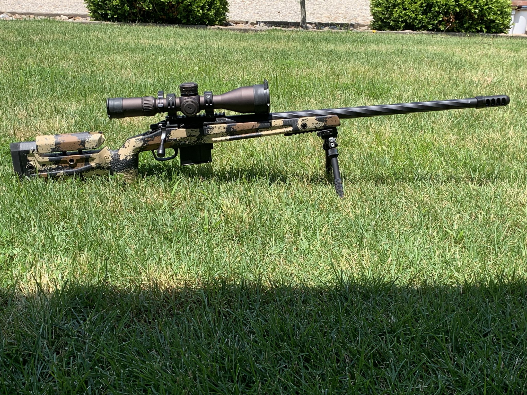

6.5 CM & 223
Waiting on another Manners stock to add a Defiance Deviant Elite 6BRA.

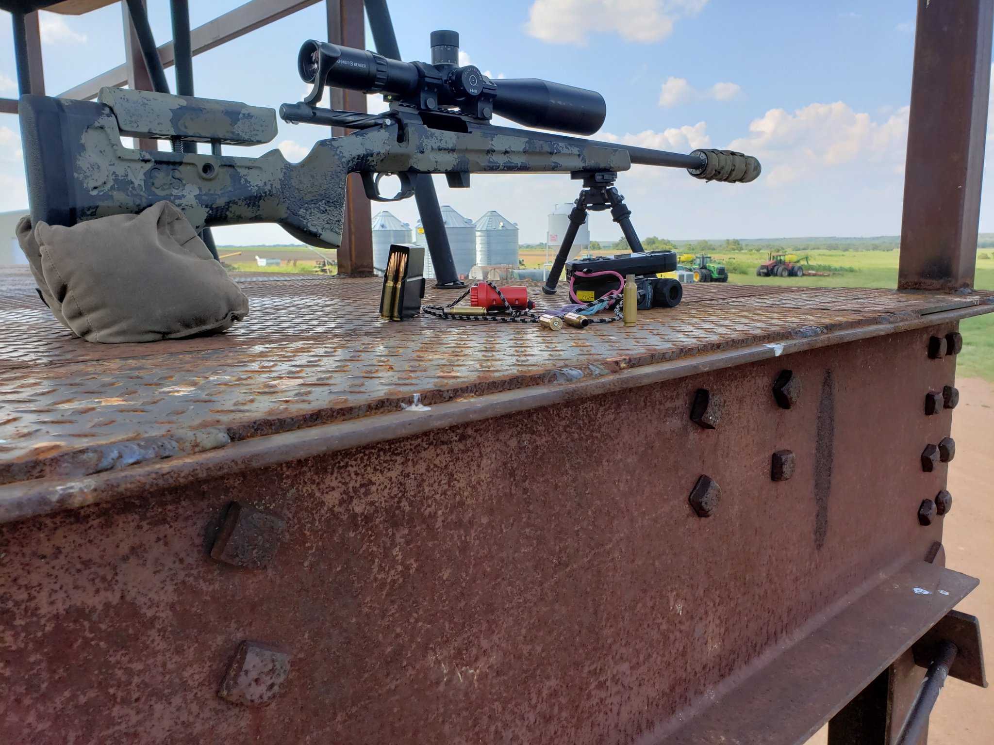

Robert's Precision Rifle 6.5 SAUM
GA Hunter - Salt bath Nitrided
Trigger Tech Special DLC
Proof Research
Area 419 Sidewinder break
Manners PRS Carbon Elite
140 Berger Elite Hunter in ADG brass , ammo by Brad at Sendero Ammo in Spring TX
Reactions: Defiance Machine

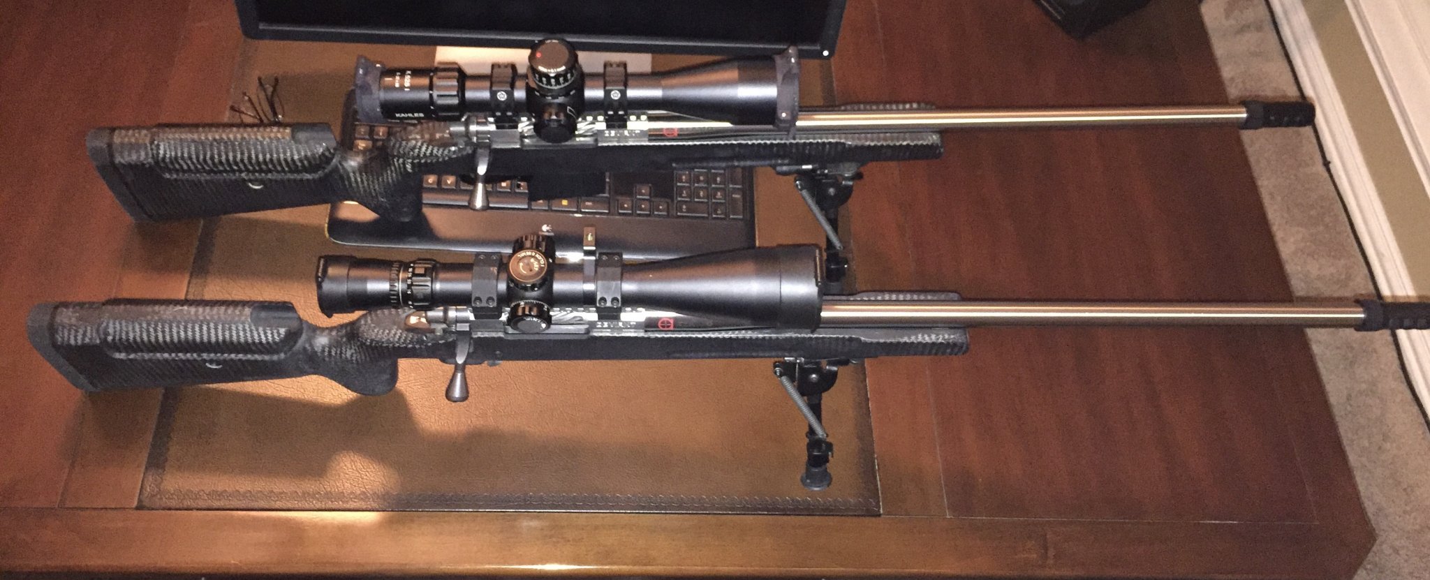

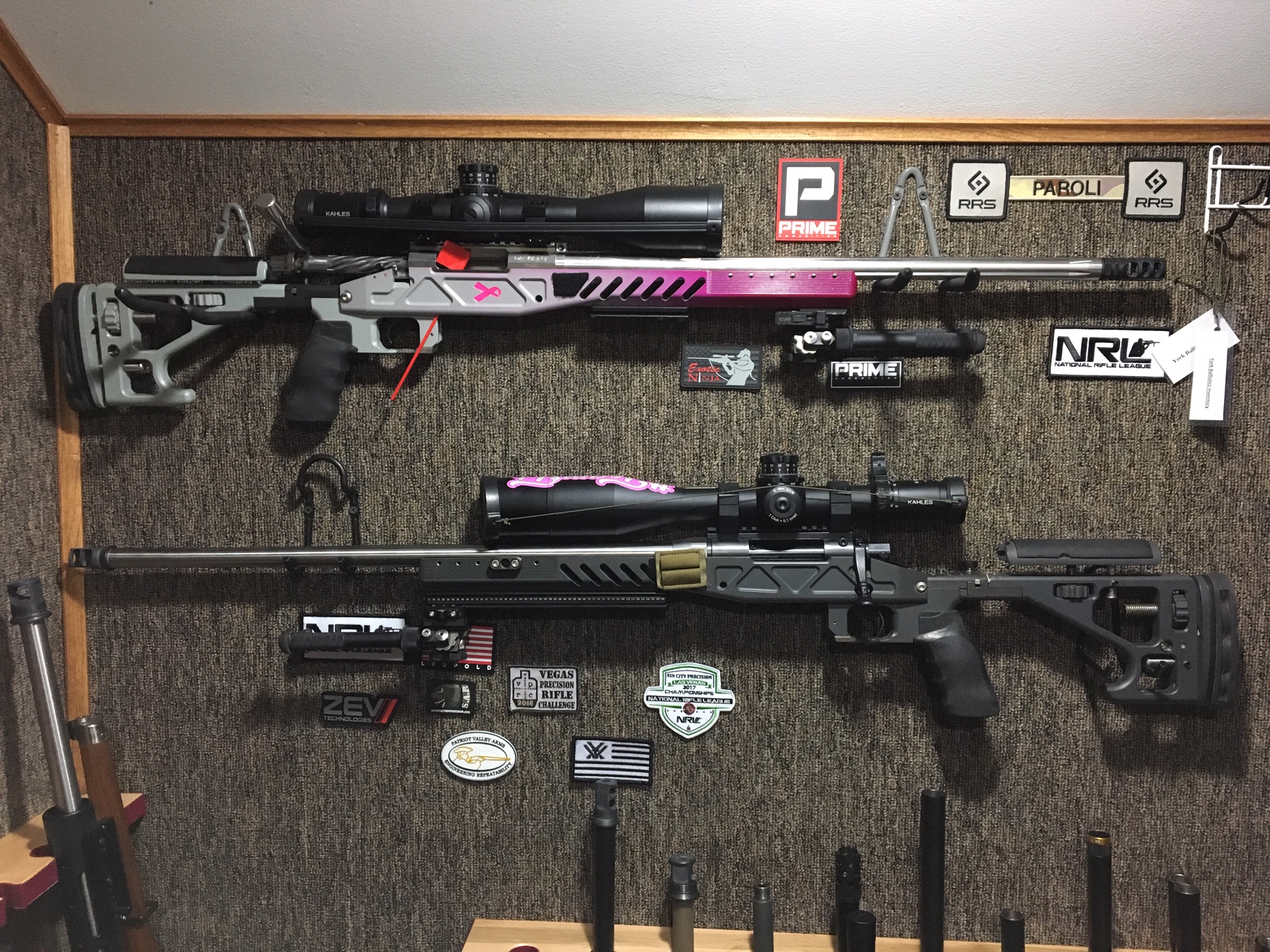

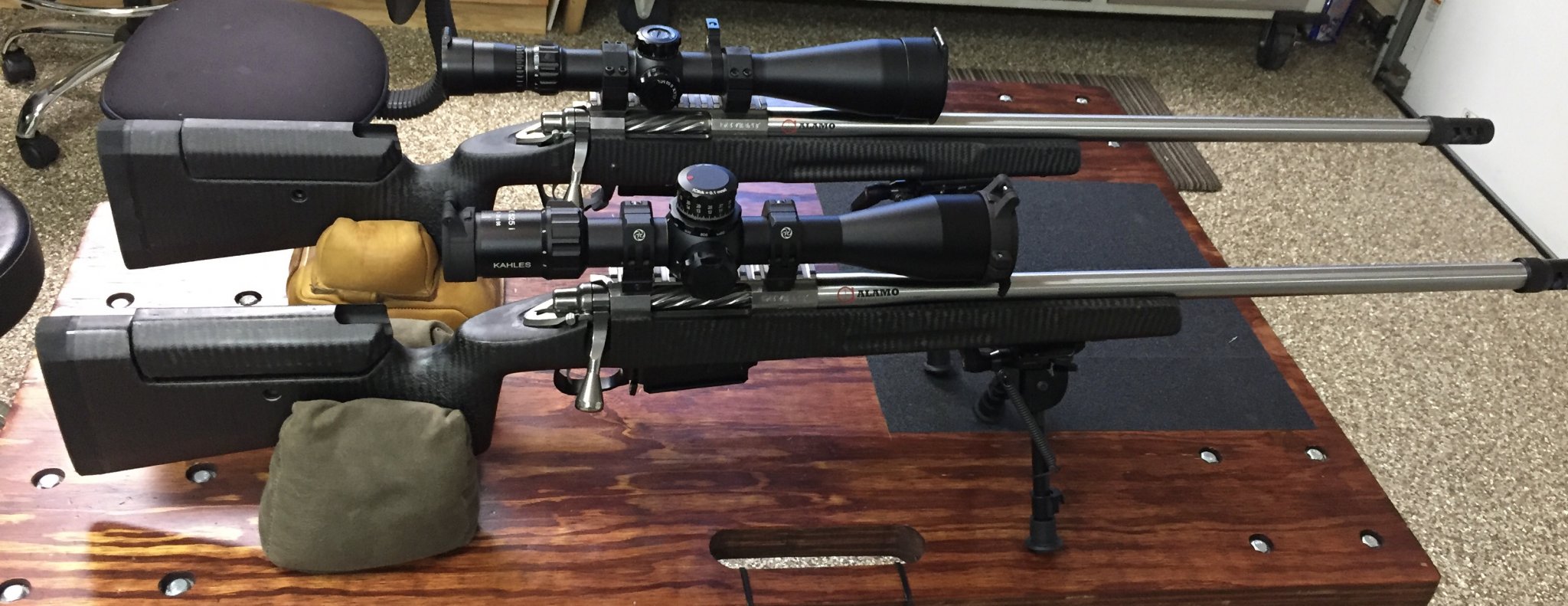

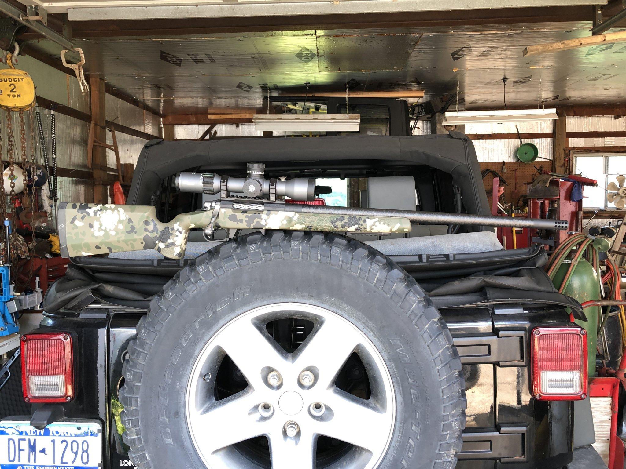

1st 6.5 cm LRI build
2cd 22-250 MCR build
3rd LPR build

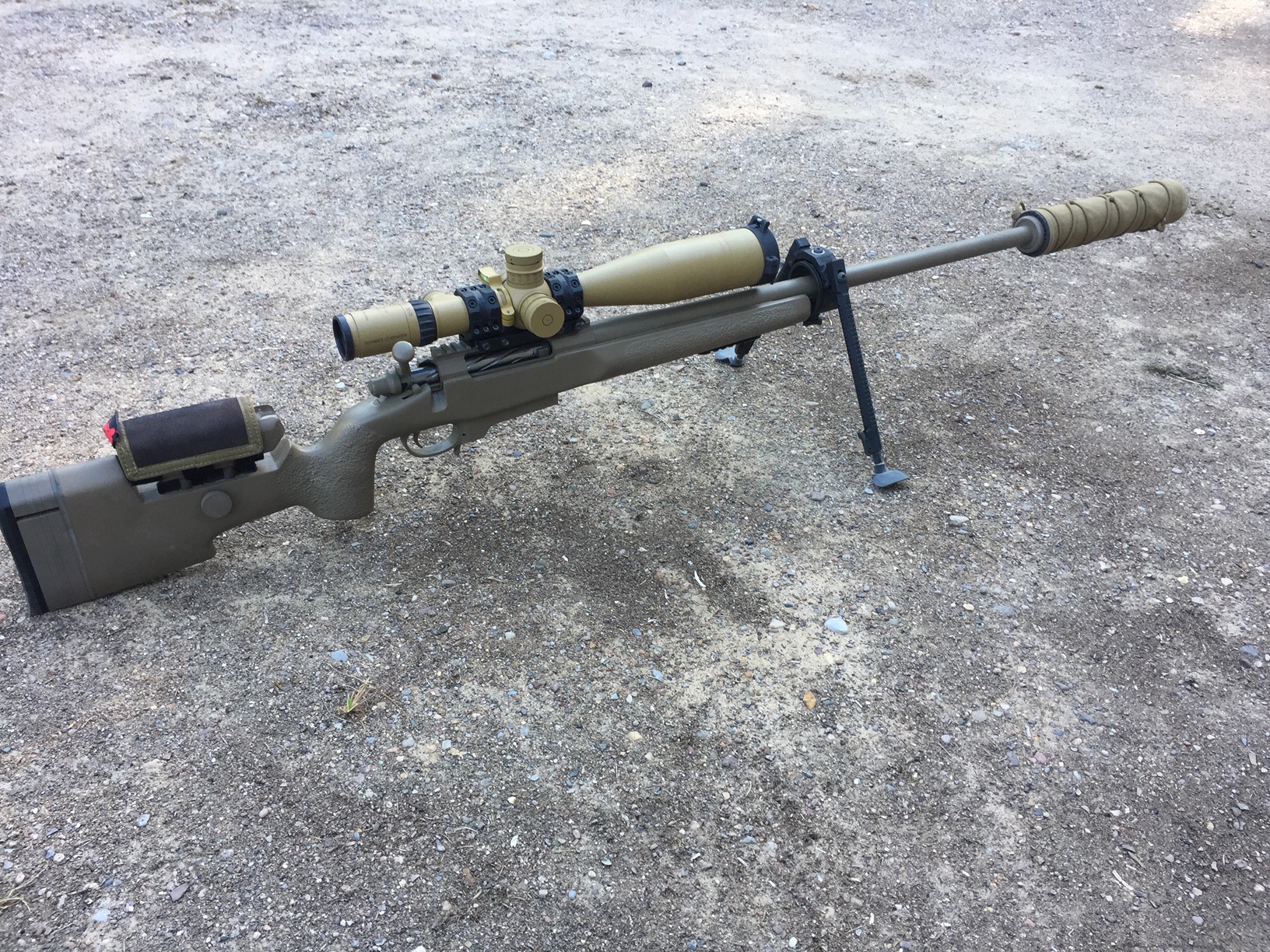

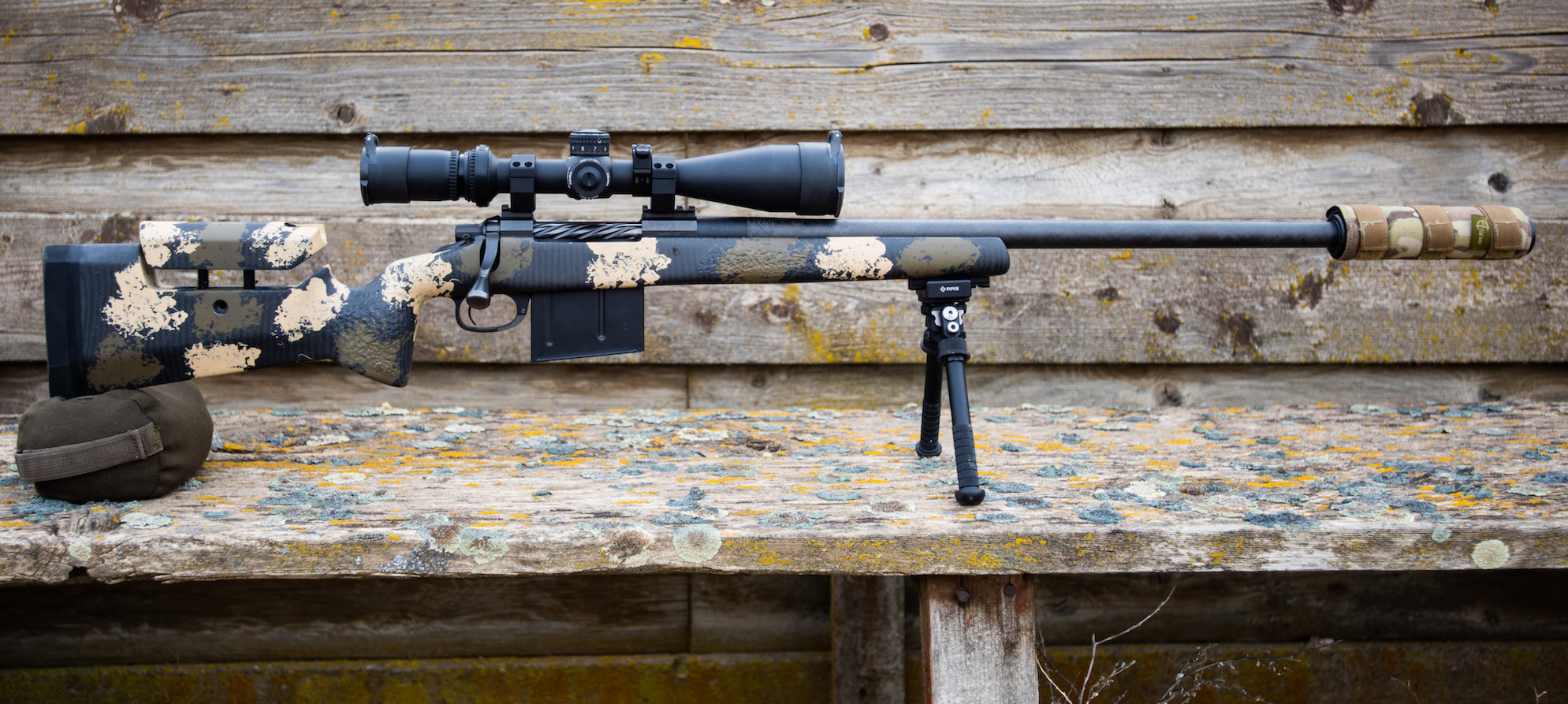

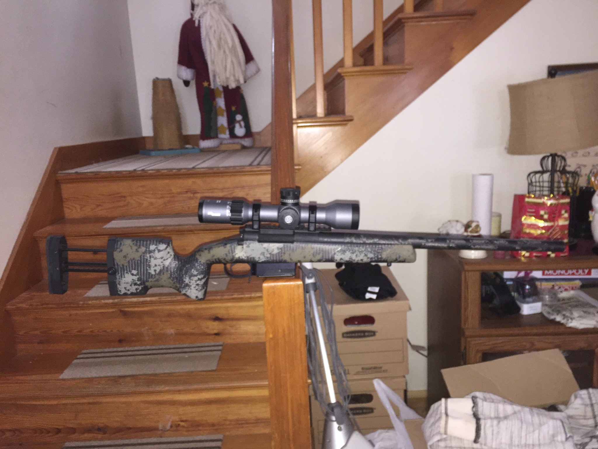

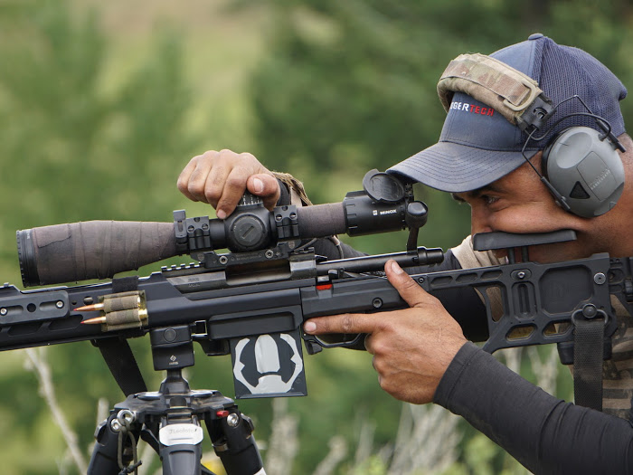

Defiance tenacity in 6.5 creedmoor chambered by John Beanland,
Manners t4a in saltwater camo
24” bartlein
Arca rail
Atlas
Tt diamond trigger
419 hellfire brake
Razor hd 4.5-27
Sphur mount
Details of the build please?

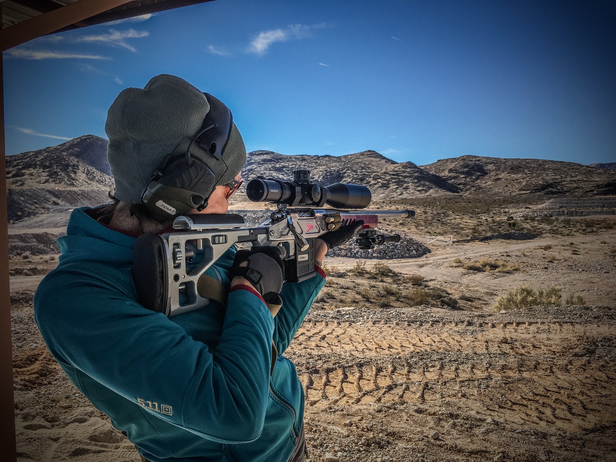

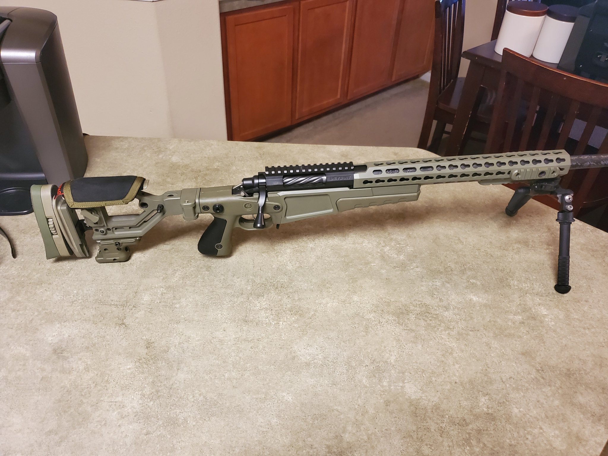

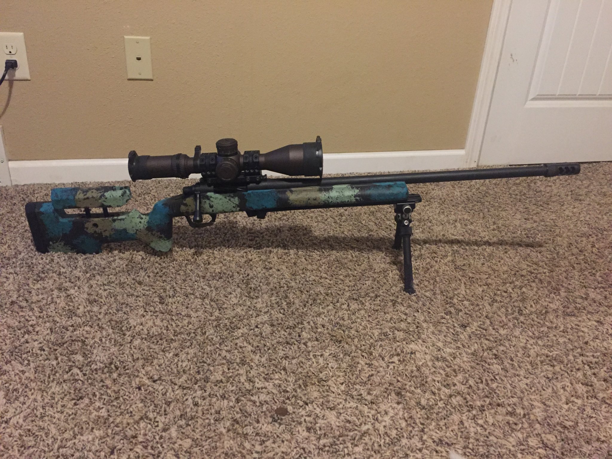

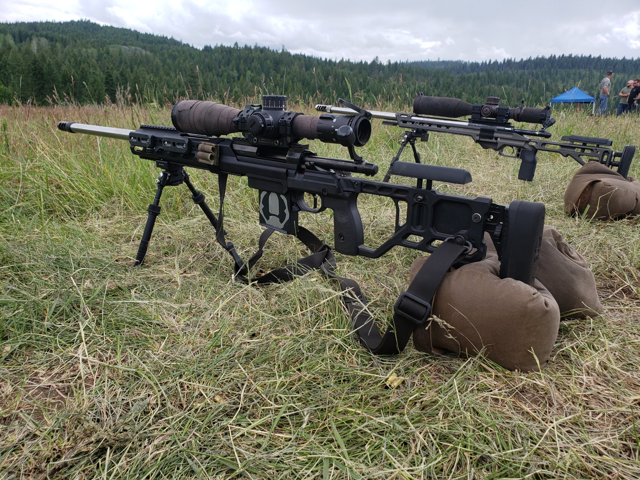

Defiance Deviant Tactical SA stainless
Proof Research 1:10 26inch barrel .308 carbon fiber
Trigger Tech Special DLC Flat shoe
MDT AAC hydrodipped by Applied Hydrographics
Atlas bi pod
MDT 12 round mags
Leupold Mark 5 5-25×56 there is. Kahles 6x24i AMR

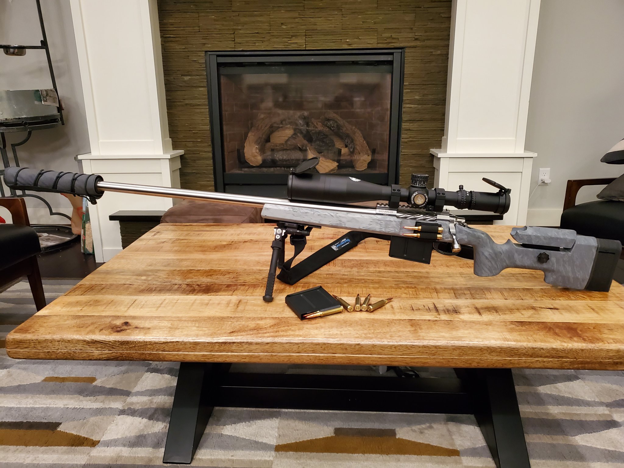

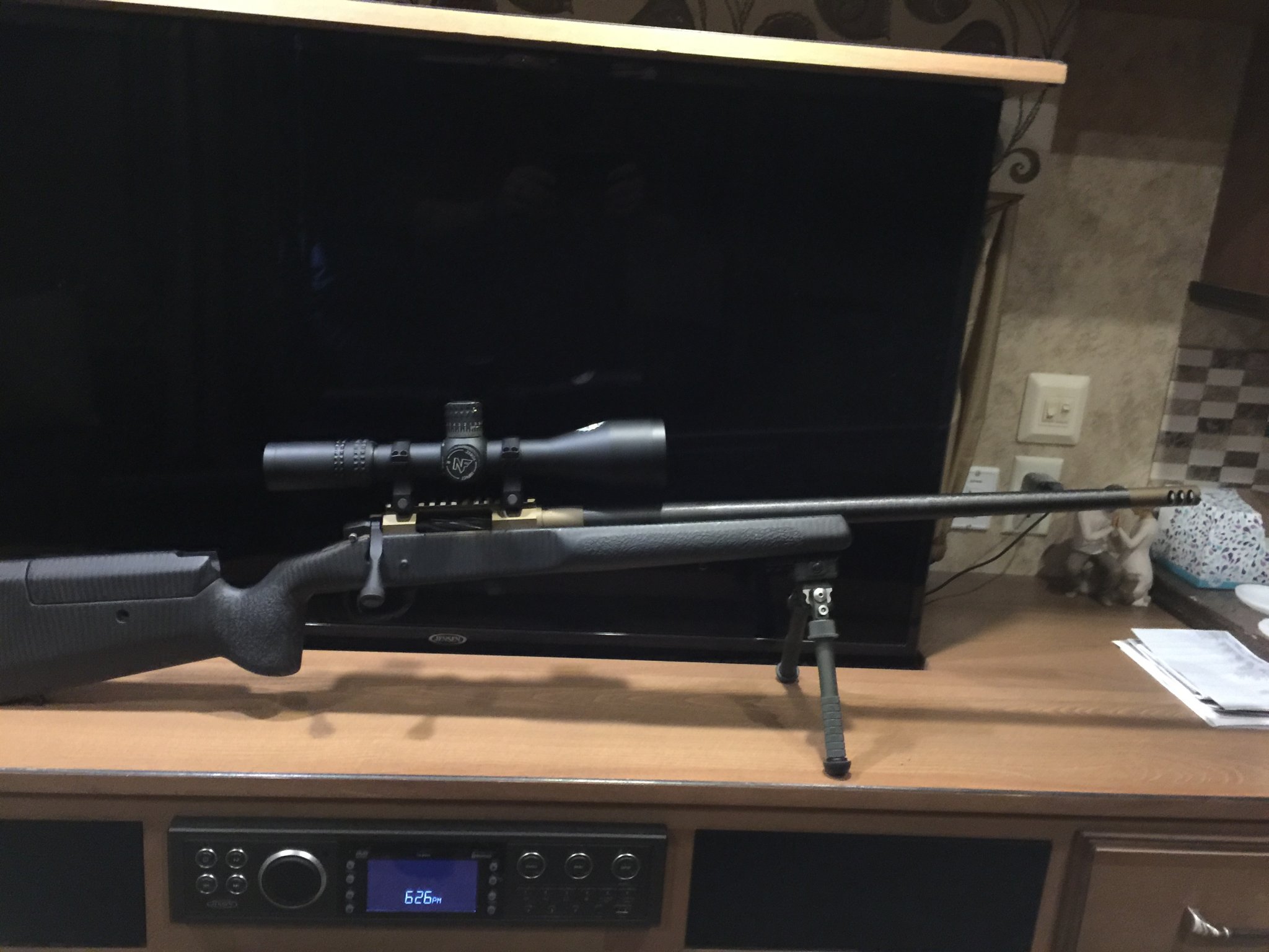

Defiance Deviant Tactical LH in 7RM w/ 30MOA rail
McMillan ADJ-A6 w/ ghost flame pattern
Nightforce ATACR F1 7-35 MIL-XT in Seekins rings
Krieger 28” bbl 1:8.5/M24
Bix n' Andy TacSport Pro trigger @ 14oz
APA RTG bottom metal w/ CIP length mag well/mags
Atlas-CAL
SAS Arbiter (9”) w/ Rifles Only MAD

Nice build. How much clearance do you have between the barrel and scope? What height Seekins rings?
Not much. I'm using high rings (1") and I still had to shave off a little bit of the plastic off the bottom of the objective flip cover so that it cleared the barrel. I haven't measured, but I'm guessing I have ~.100"-.150" clearance now
Thanks for the info. Was curious since i have a Deviant Elite with MTU barrel coming that I will be topping with the same NF scope in ARC Medium (1.1”) rings. Will definitely be a tight squeeze, but planning on running without the front cap.
Mine is an M24. I think between no cap, and slightly higher rings, you should be gtg
Reactions: Gunfighter716
My rifle is the first pic on this thread and that is a mtu barrel with arc medium rings. Perfect height for me, any lower You would have to trim the caps a little

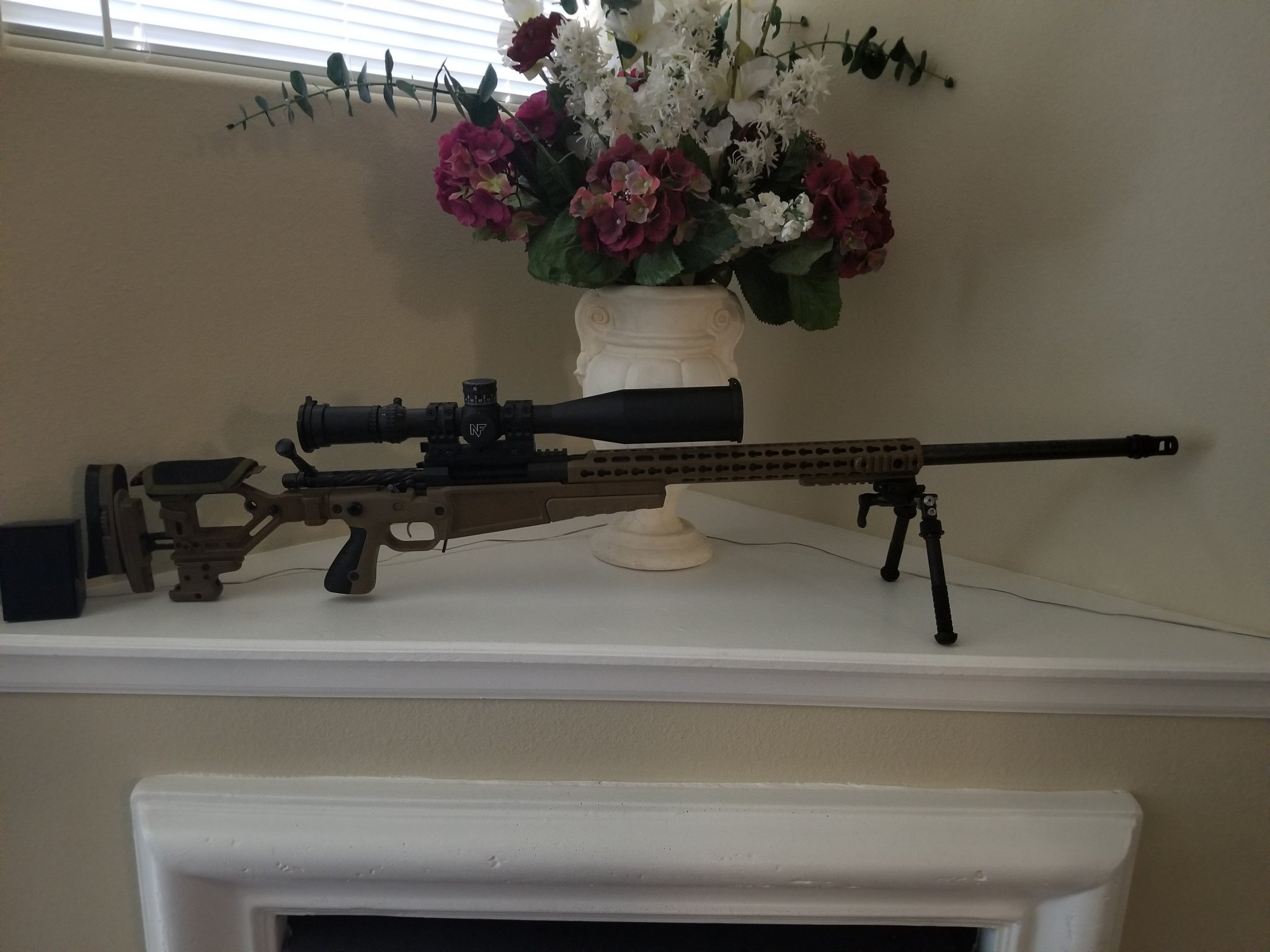

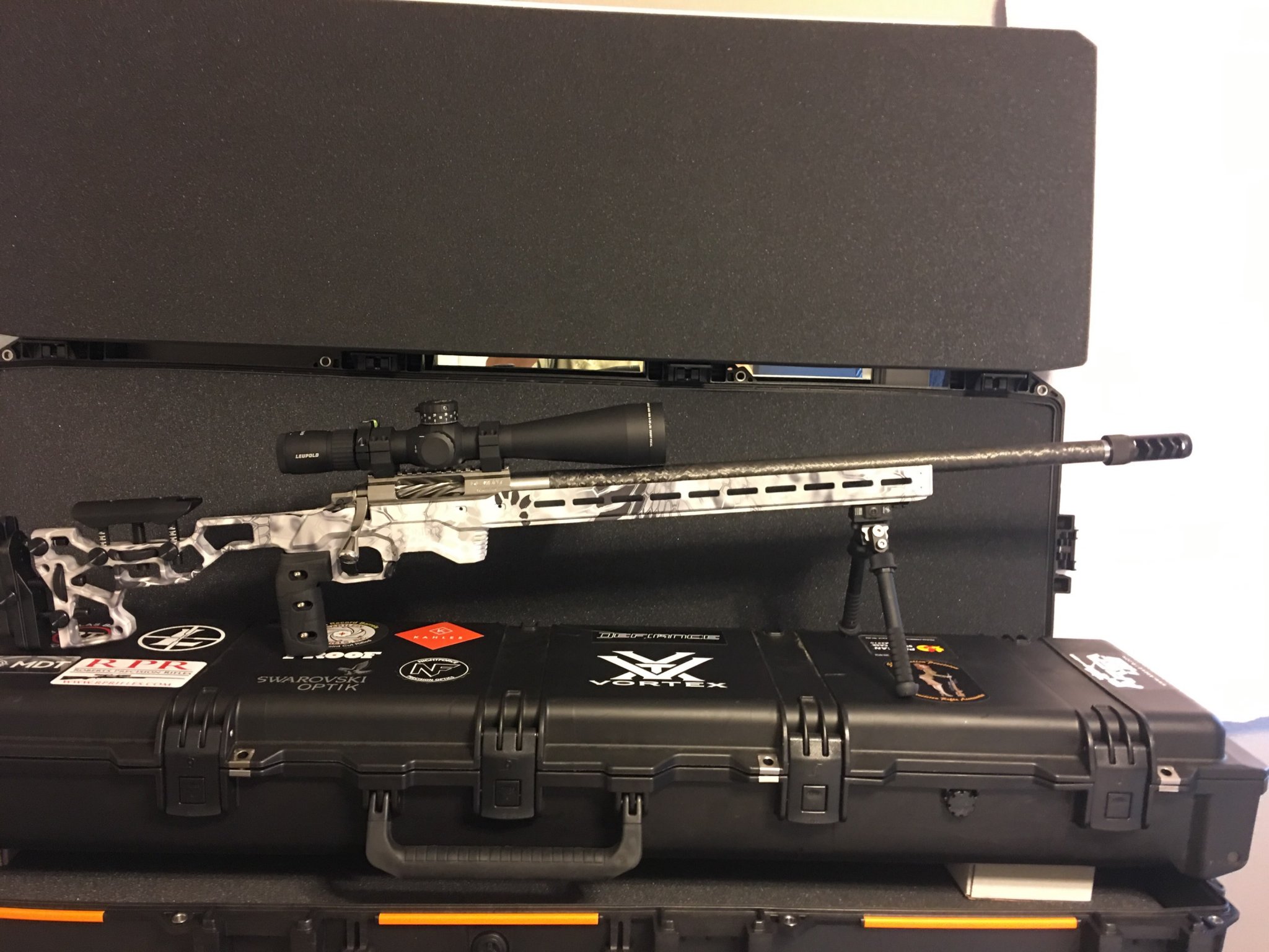

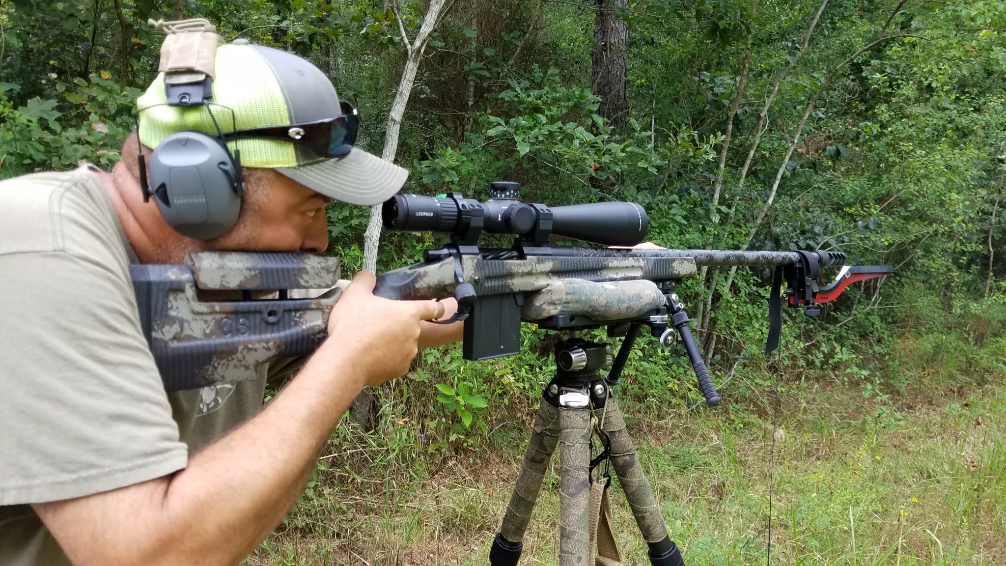

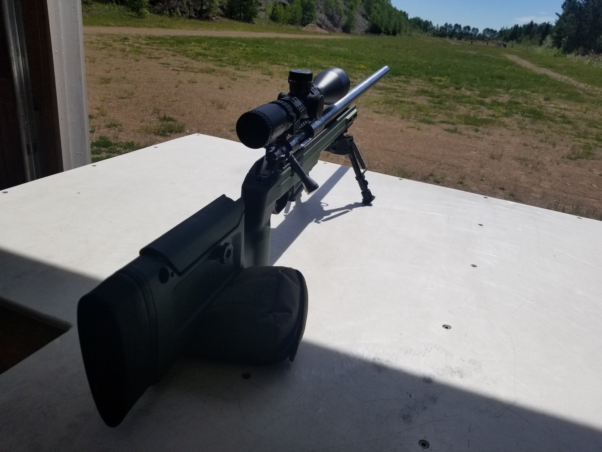

Defiance deviant hunter 20 moa rail
Defiance bottom metal
Proof barrel chambered in 338 Lapua Ackley Improved
Christensen Arms titanium side port brake
Manners EH1 stock in scorched earth
Nightforce NXS 5.5-22x50
Nightforce 6 screw rings

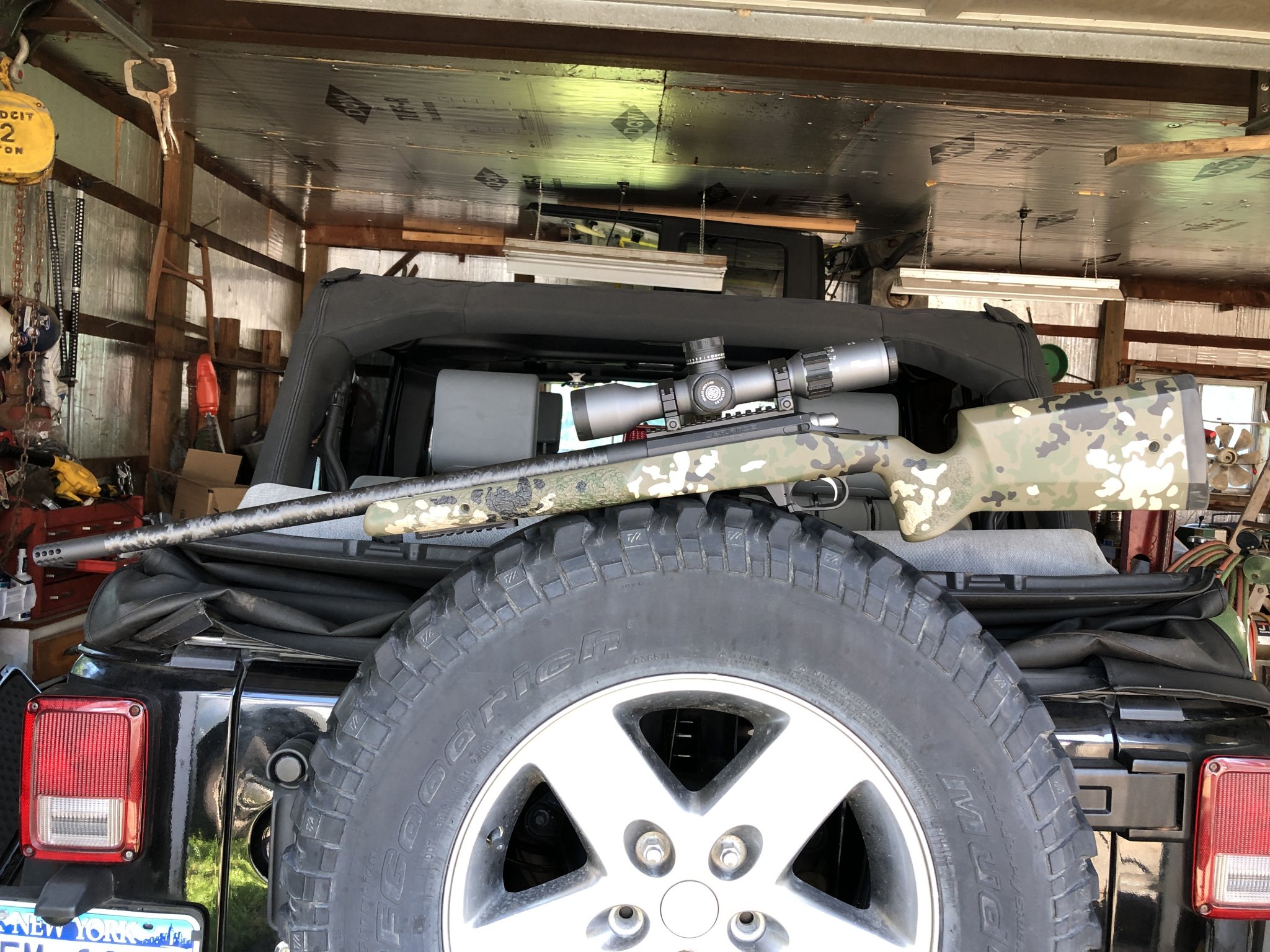

Just about done. Deviant Elite, Bartlein 6.5 CM, and Nightforce ATACR 7-35 sitting in an MDT ACC. Ended up not needing to trim the front flip cap on the Nightforce with the MTU barrel. Waiting on the Area 419 bolt knob which I was hoping would show up today and then she'll be done. Just need to pickup a case of Berger 6.5 CM ammo and it's range time.
