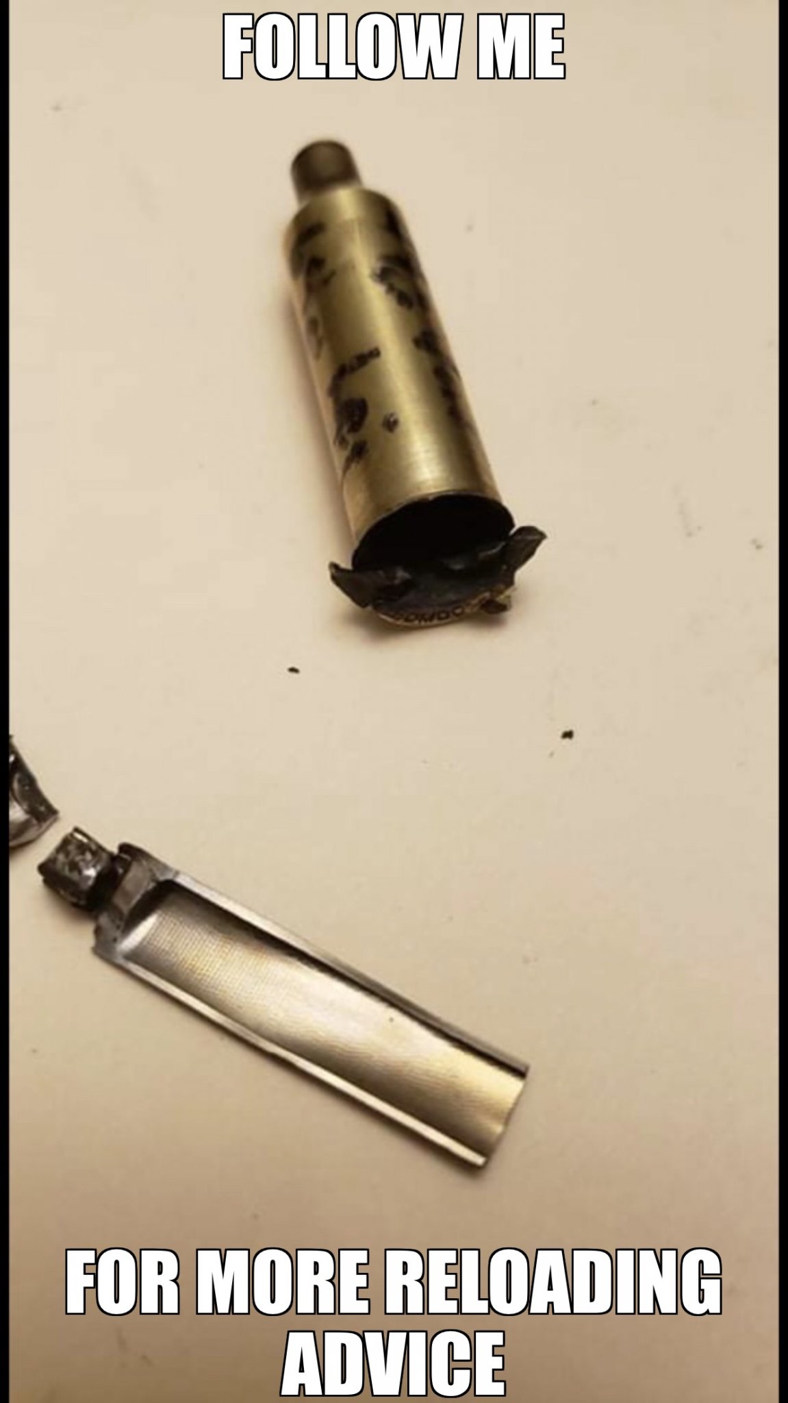

If you try to replicate their performance in your rifle not understanding how they got to where they are, you will damage things: brass, bolt, your face maybe… There was a thread on here where a guy sheared off both lugs of his bolt and by the grace of God didn’t die. You might say it won’t happen to me but why risk it? That extra 100 FPS isn’t worth it.
