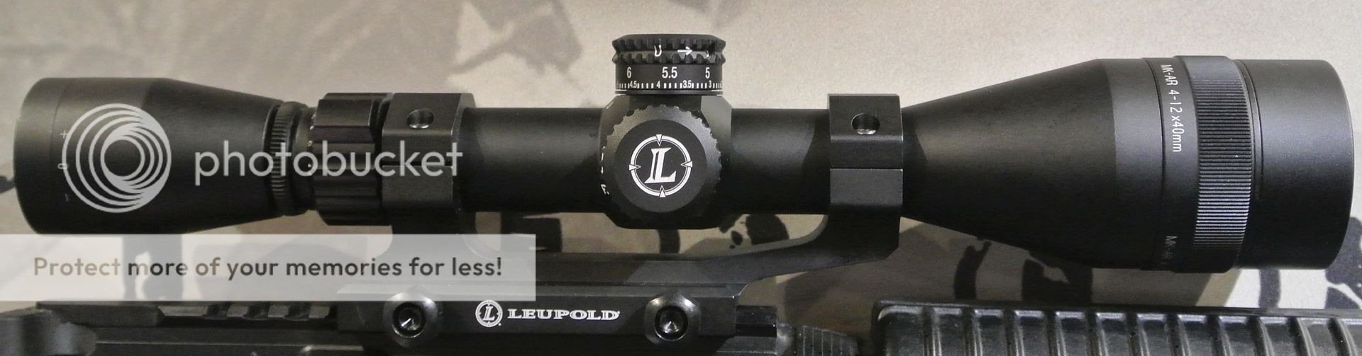

Leupold Mark AR 2-12x40mm SFP rife scope:
The last scope that I want to discuss before leaving Leupold is their 4-12x40mm MK AR. As I mentioned in my earlier Bushnell article, I was on the lookout at Shot this year for passable .22lr training scopes. Close focus, manageable cost, and matched reticles to clicks are the guiding features for this optic. The 4-12x Mark AR is Leupold's contribution to this search. It can be had with a simple mil dot reticle and has .1 mil clicks with 6 mils per rev. The focus is on the objective and gets a bit closer than 25 yards. It also comes with engraved bdc turrets for a 55gr .223 and 168gr .308. I'm sure someone will appreciate that, but I am equally sure that that someone is not on SnipersHide. While the glass looked a bit sketchy (I am told it is VX-1 glass) and certainly wasn't edge to edge clear, at $500 it is not a very costly optic and being a Leupold, will probably hold up well. I think this scope offers a lot for the .22lr trainer. It may also be the ticket for a great many of the po-boys out there. Matching turrets and clicks in a $500 scope that will probably hold up well: that is actually something quite unusual.
