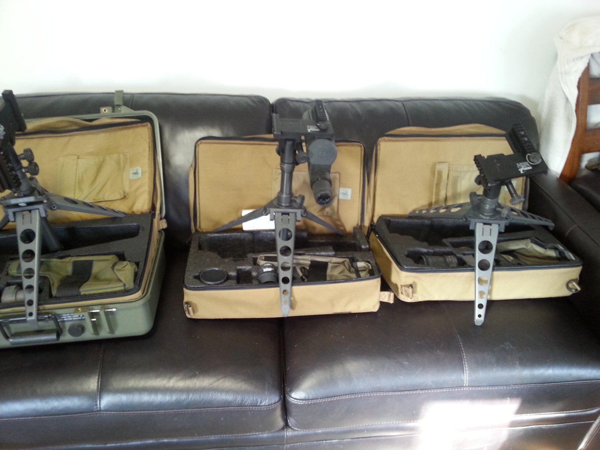

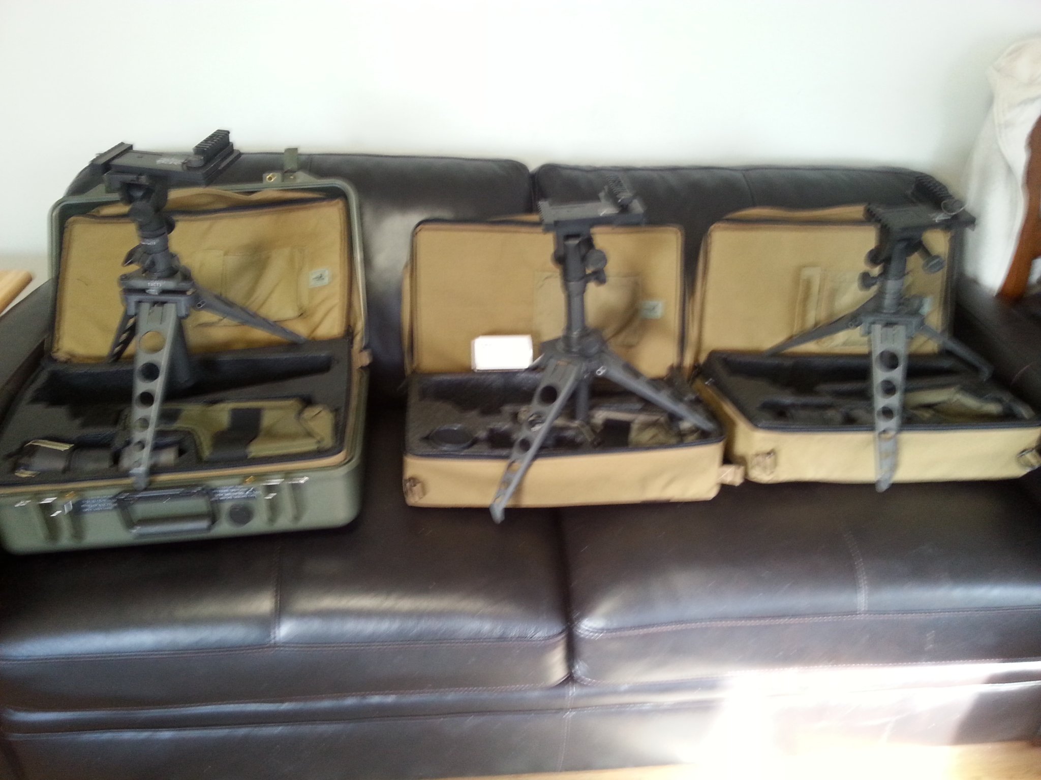

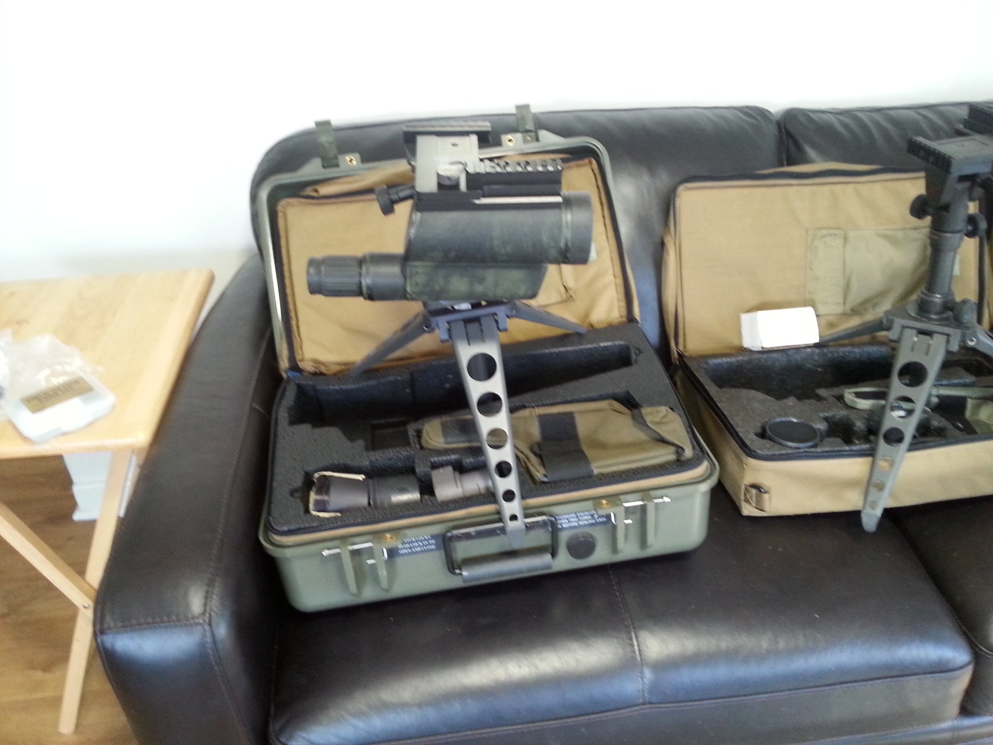

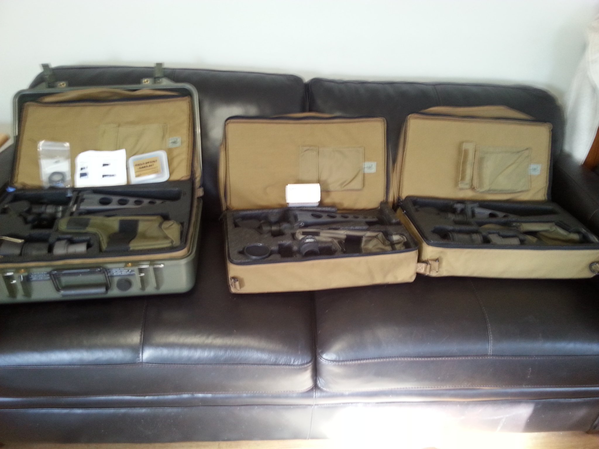

Hello I ordered the MK4 H32 last night and already have the MK4 Mil dot and 3 Ashbury Precision tripod kits one of the tripods is for a range finder with compass non magnetic that is next on the list , geoff3

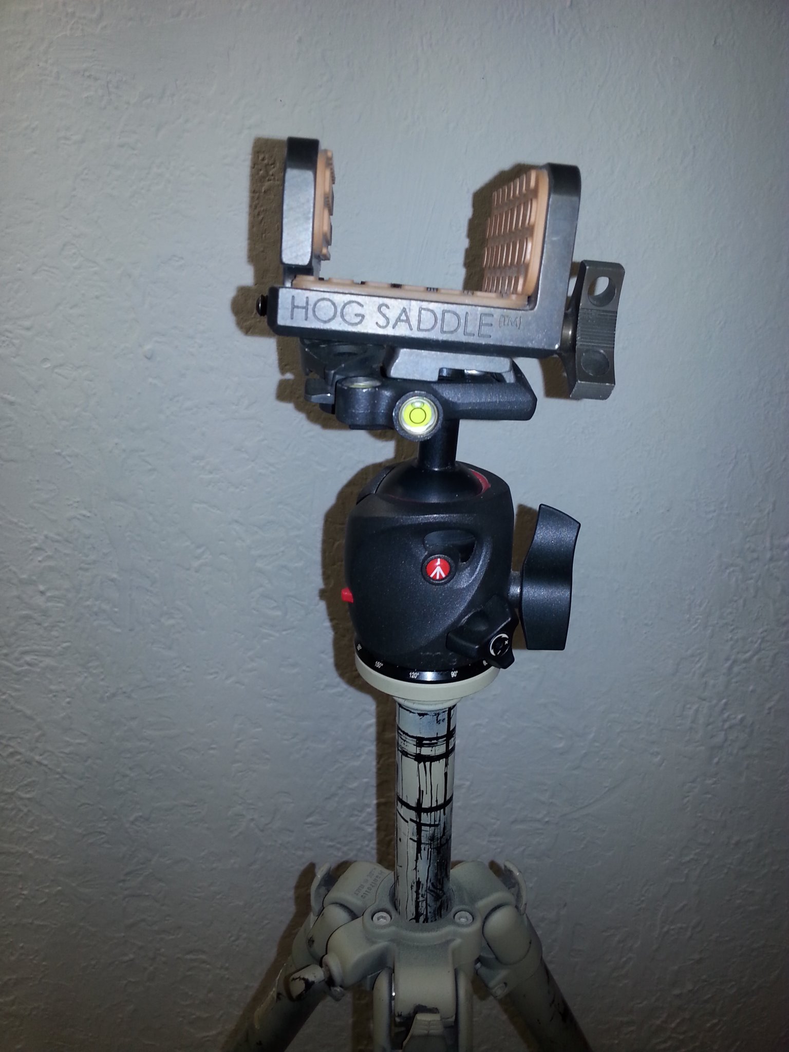

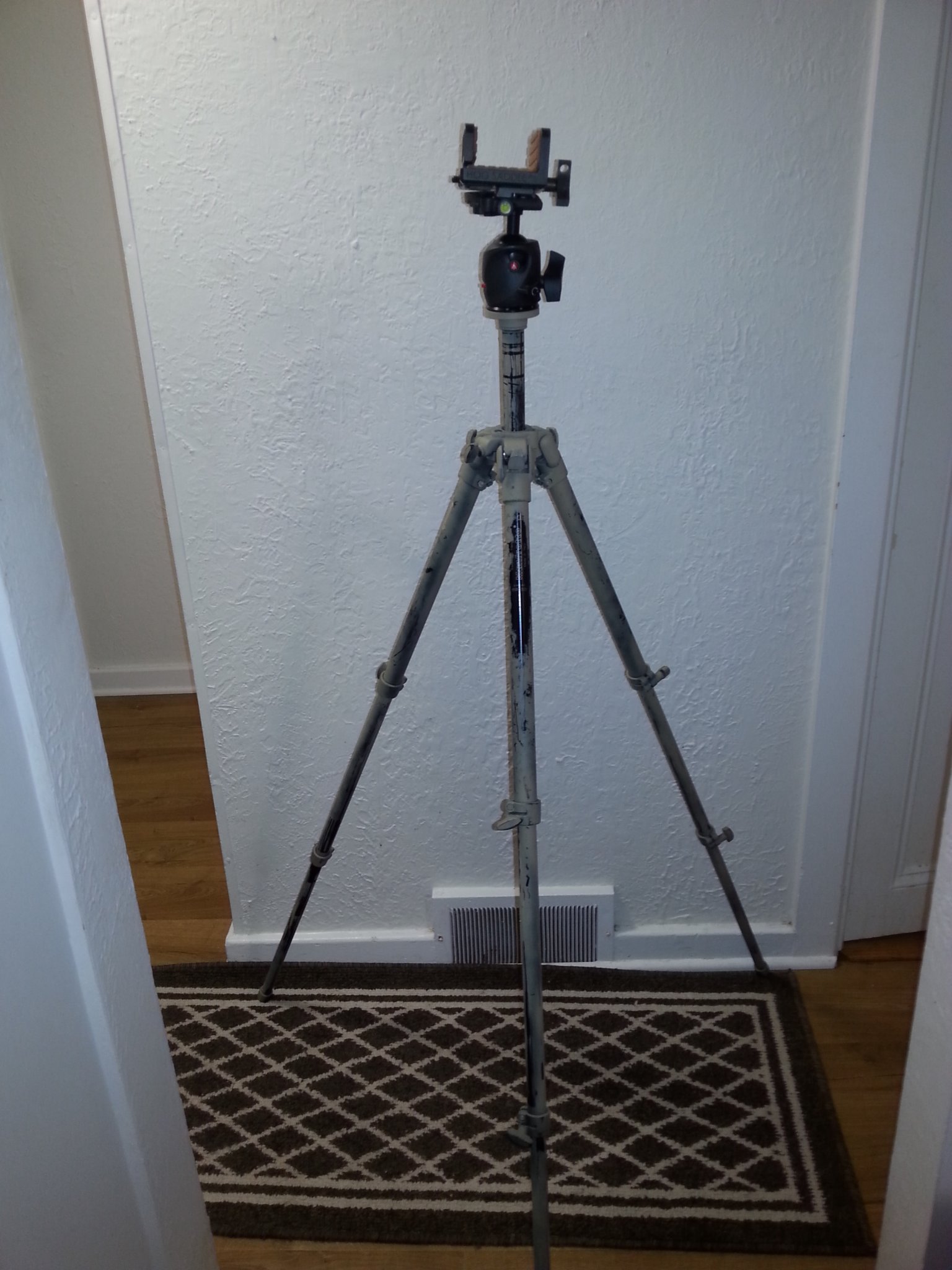

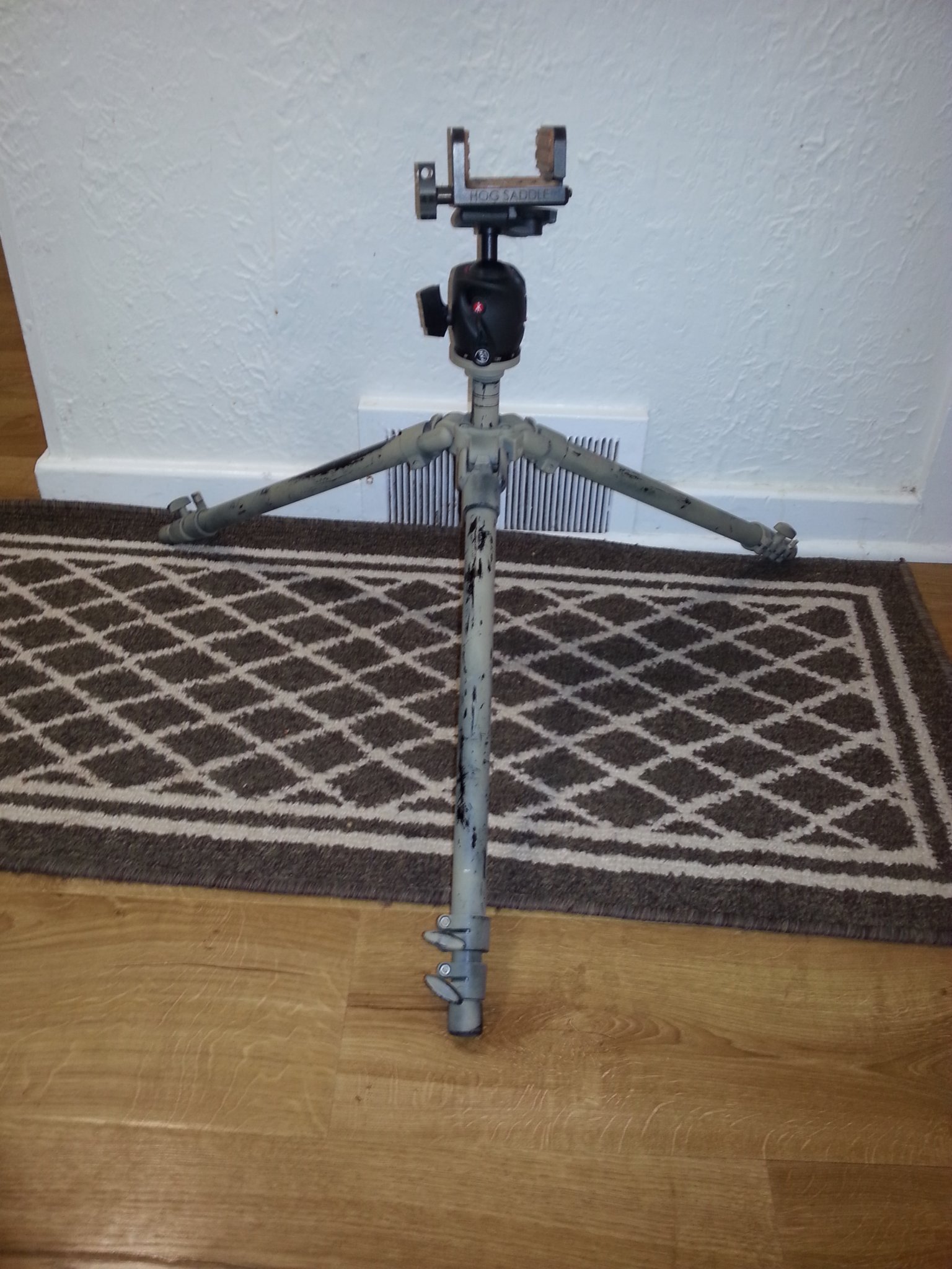

Hello I have a Manfrotto 190B with Hog saddle I use that for spotting or holding my rifle , I didn't know what type shooting I would be doing so I bought the Manfrotto 190B first and moved forward from there ,geoff3
Reactions: Trek
Hello here are some pictures of the Manfrotto 190B with Manfrotto Magnesium Ball head and MOD7 HOG saddle sometimes when spotting I use the Hog saddle to hold the spotting scope, geoff3
