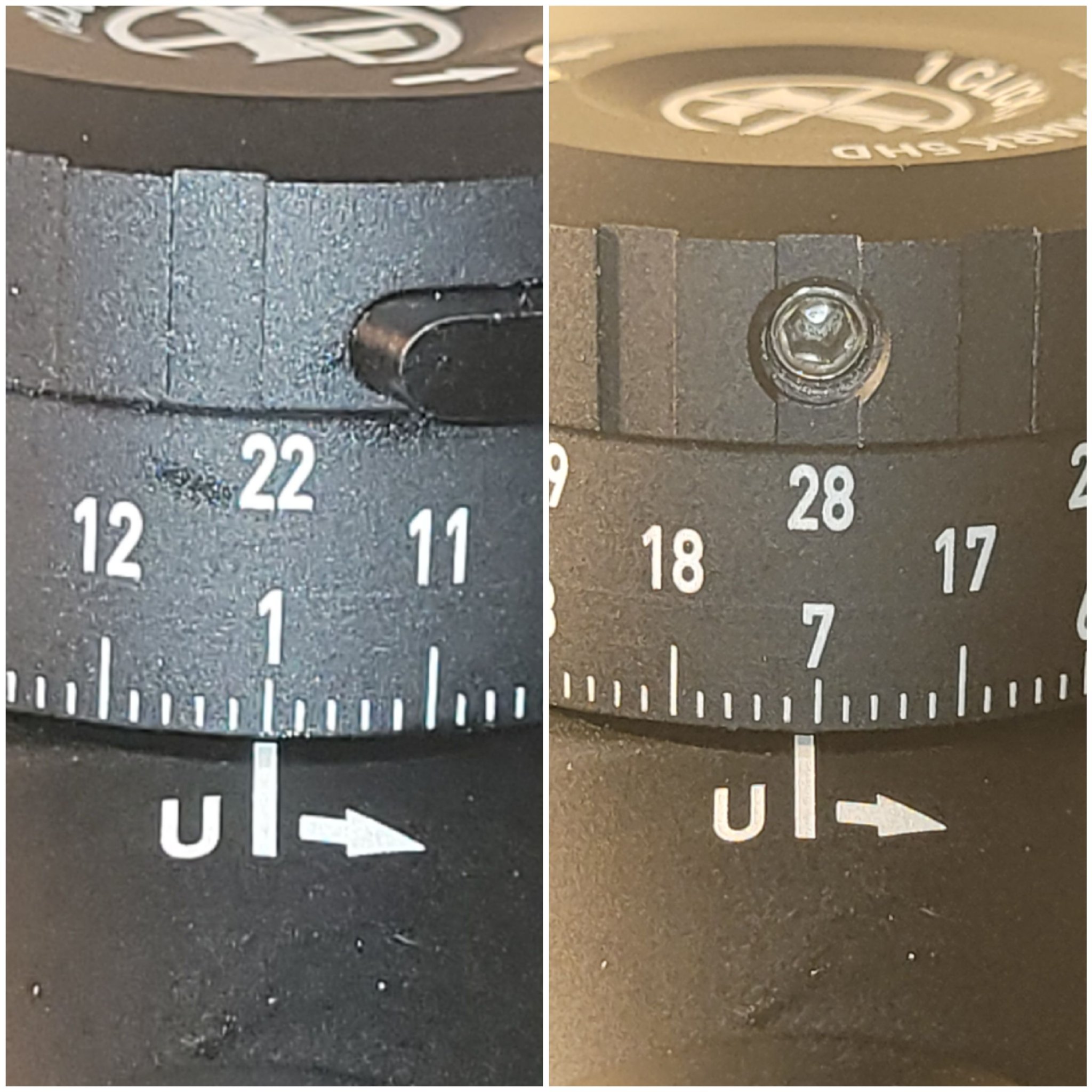

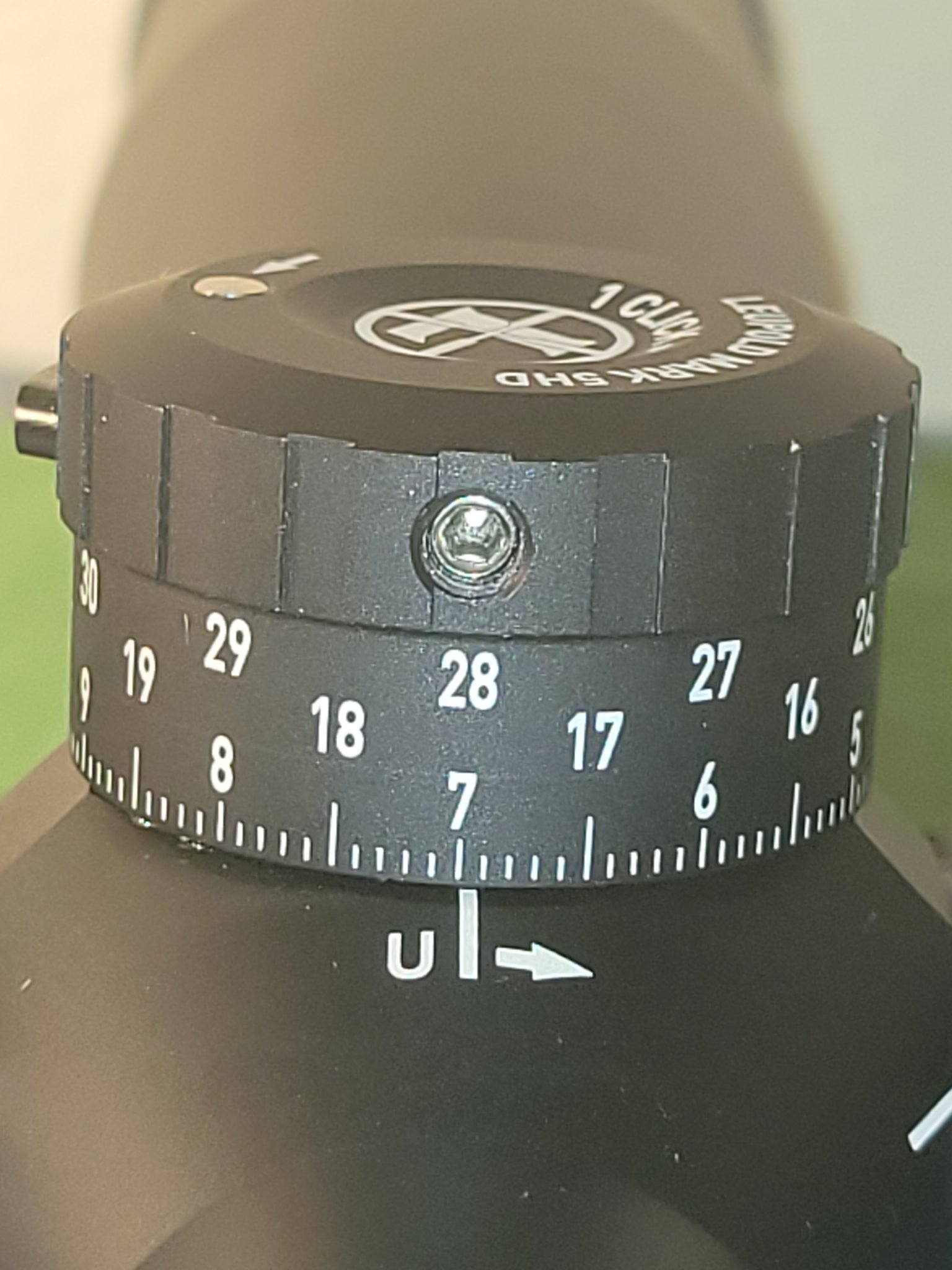

Am I correct to contact Leupold to warranty this brand new scope? I got a great deal on it, $1600, but I've used another identical Mark 5 and it didn't have this issue.
I tried removing the turret cap and correcting the alignment but couldn't clean it up. There is some play in the dial when not locked at zero as well.
Or am I nitpicking? I have high expectations for a Made in USA $2,400 MSRP product.
Thank you, this is my first time here so I apologize if I did something wrong.

My mark5 5-25 is the same, it is a little annoying. I'm sure leupold would fix it but I'm too lazy to send it in.
contact Leupold - see if they'll send you 2-3 turret caps. try all of them. chances are one will line up better than the others. then send the rest back to them.
mine did the same - it started off lined up well then as i dialed up further it got worse and worse. i tried a few different caps and found one that worked much better
also when installing the cap - try to hold it firmly lined up when tightening the screws evenly back and forth.
there will always be a tiny amount of slop unfortunately - that's just the nature of the mk5
it worked for me.

That would annoy me enough to send it in.
it worked for me.
Thank you will do
