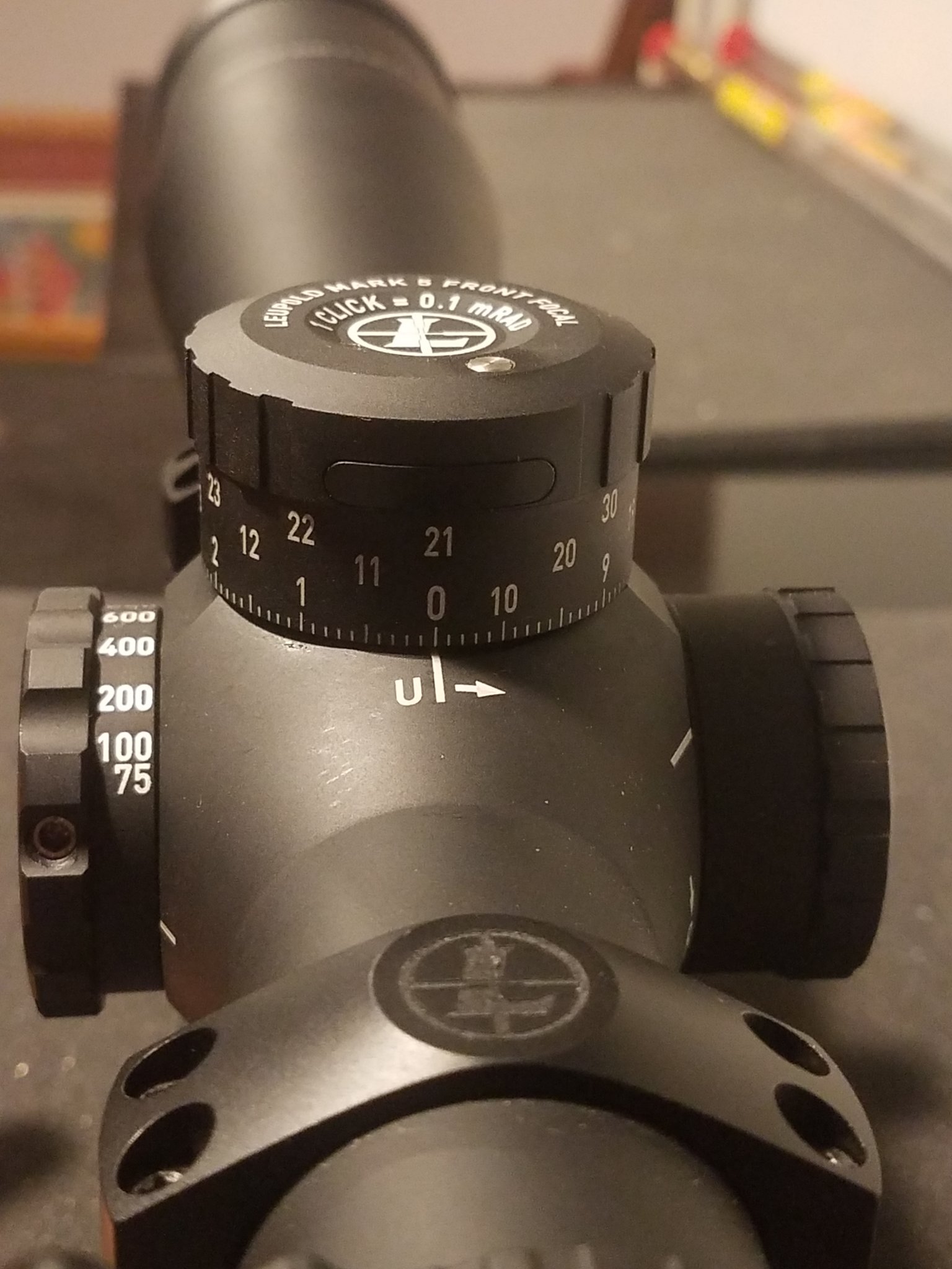

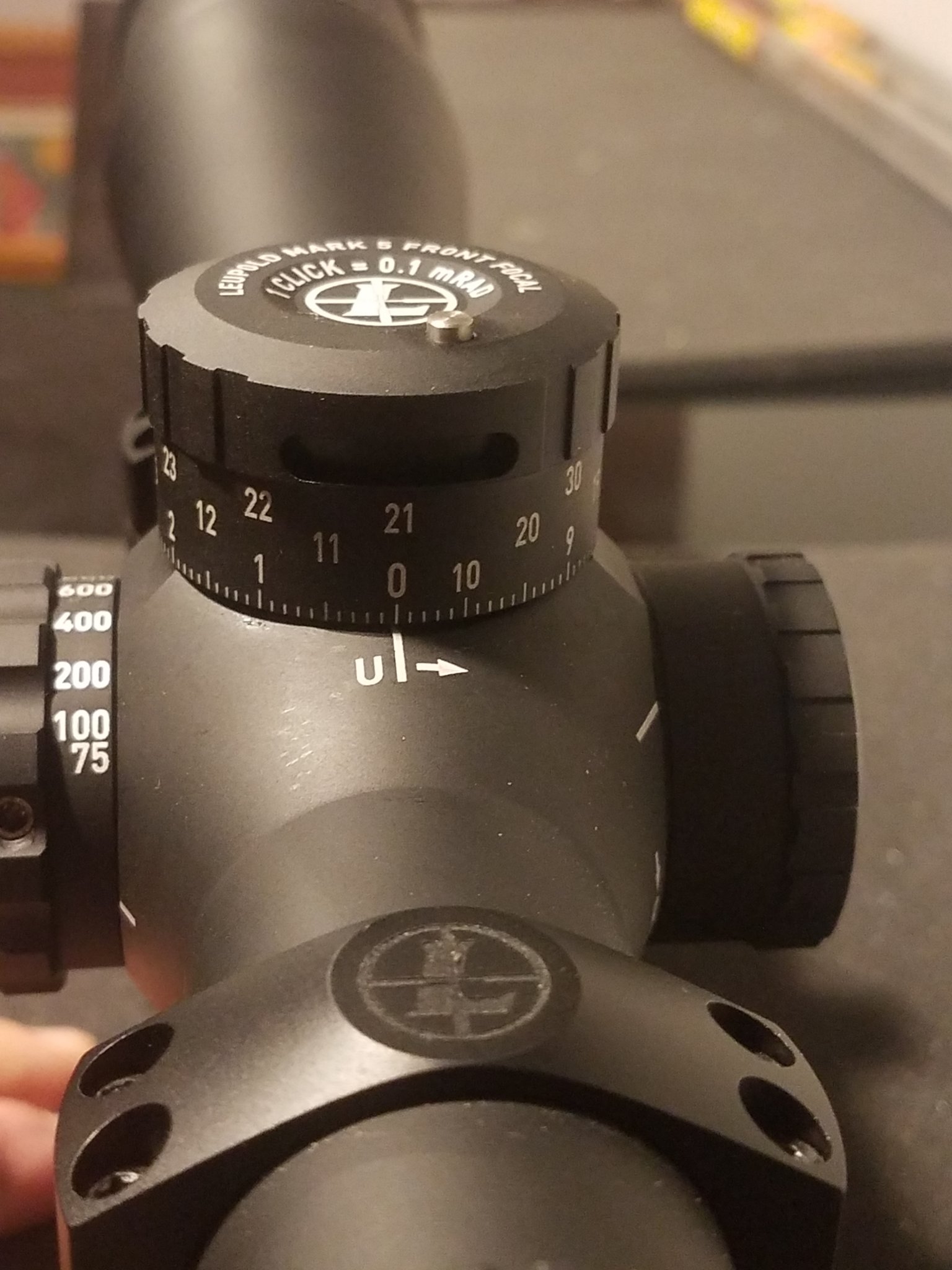

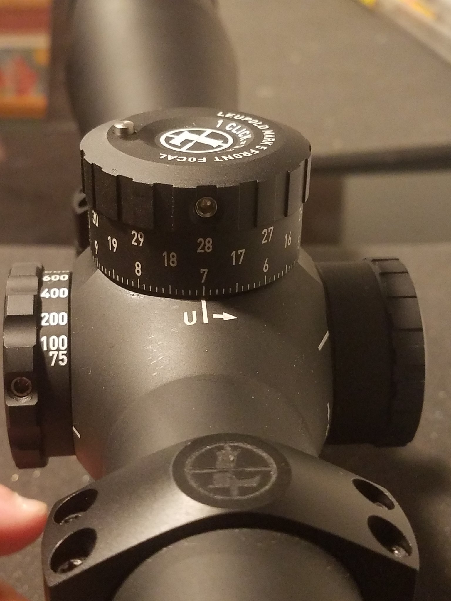

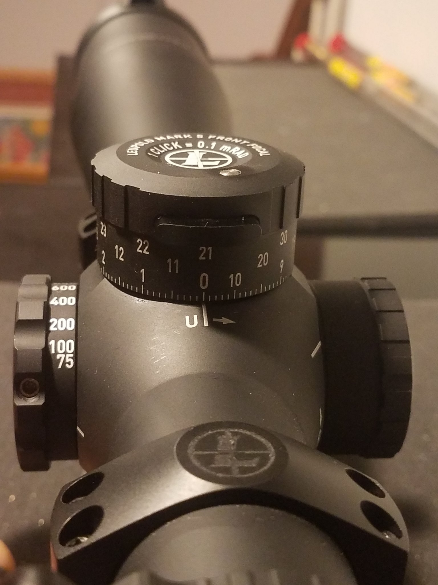

my mark5hd is sitting on a 20 moa base on top of a bergara hmr pro 6.5creed. From zero I have 28 mils of elevation to play with. that's on the third set of numbers
10.510.5mils.jpg.
2828mils.jpgmaxxed out (for my setup)
