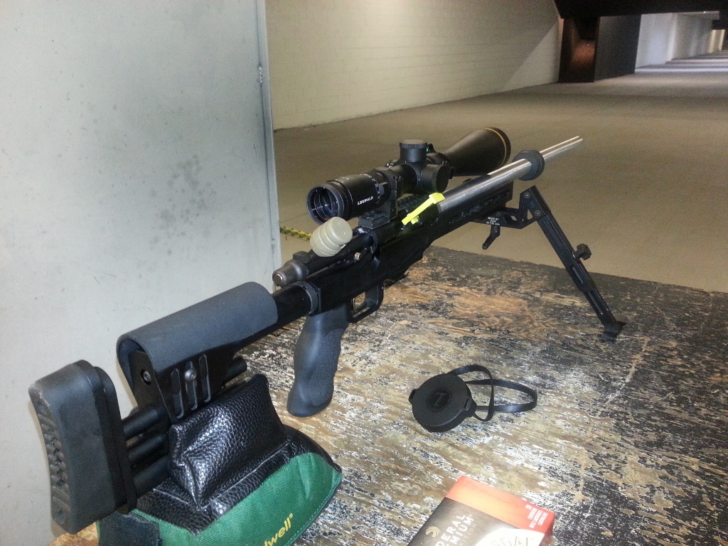

Look like I will have to re Zero my rifle tomorrow. As long as the UPS truck does not chrash on it's travels to my house. :D;) I will have Photos Later today.
Got it today and zeroed it at 100 yds.
