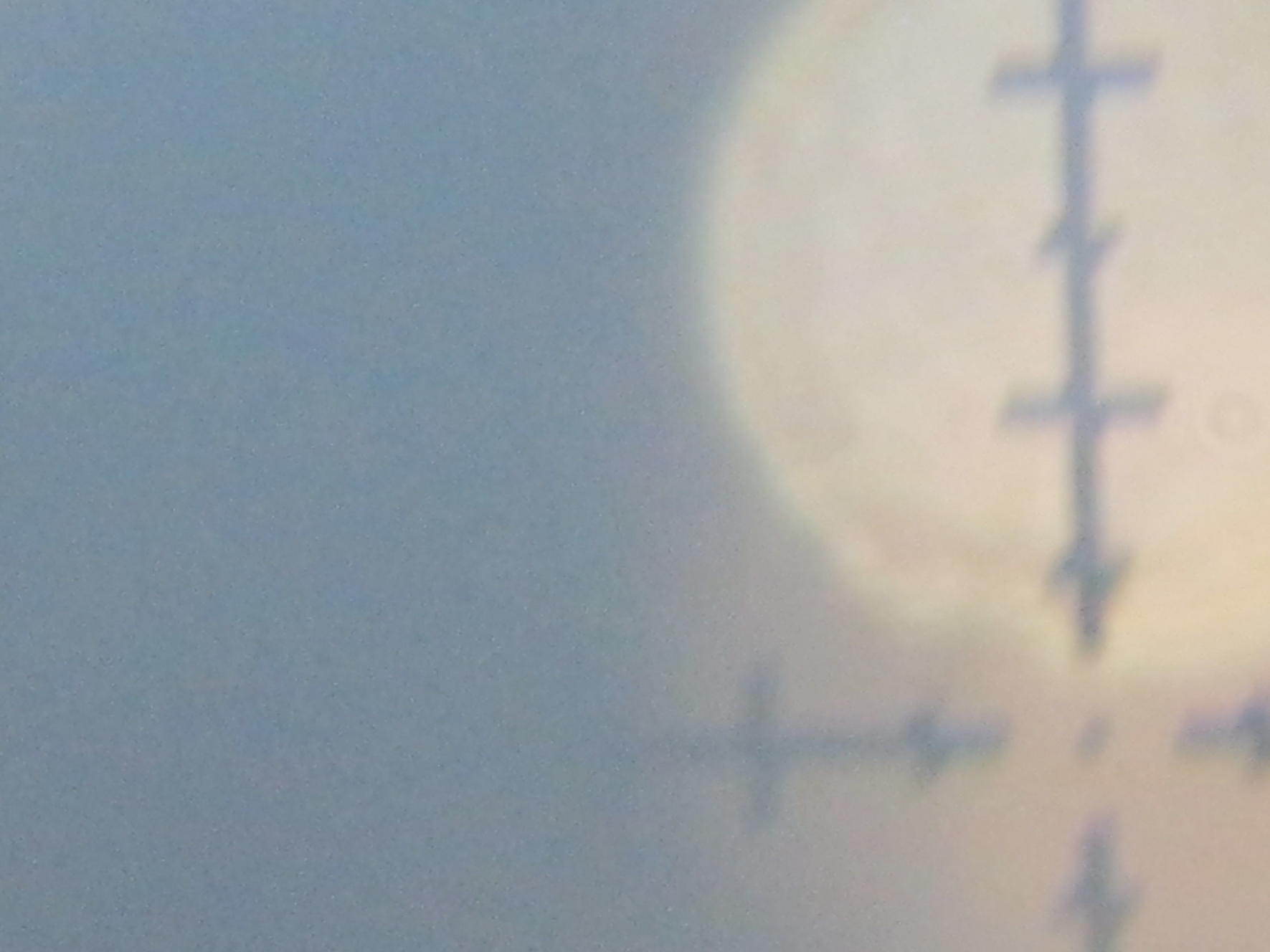

I'm with you. If this reticle actually came to a true crosshair in the middle, I'd buy one. But for long range work, I can't imagine leaving an open center area.
the TMR in the mk6 that the NZ army got for it's DWM has a dot in the middle.

The opening in the center is a little less than the size of a 7mm bullet hole at 100 yards on 24x. I have the 4x24 on my hunting rifle and its an excellent reticle... I was having the same reservations
