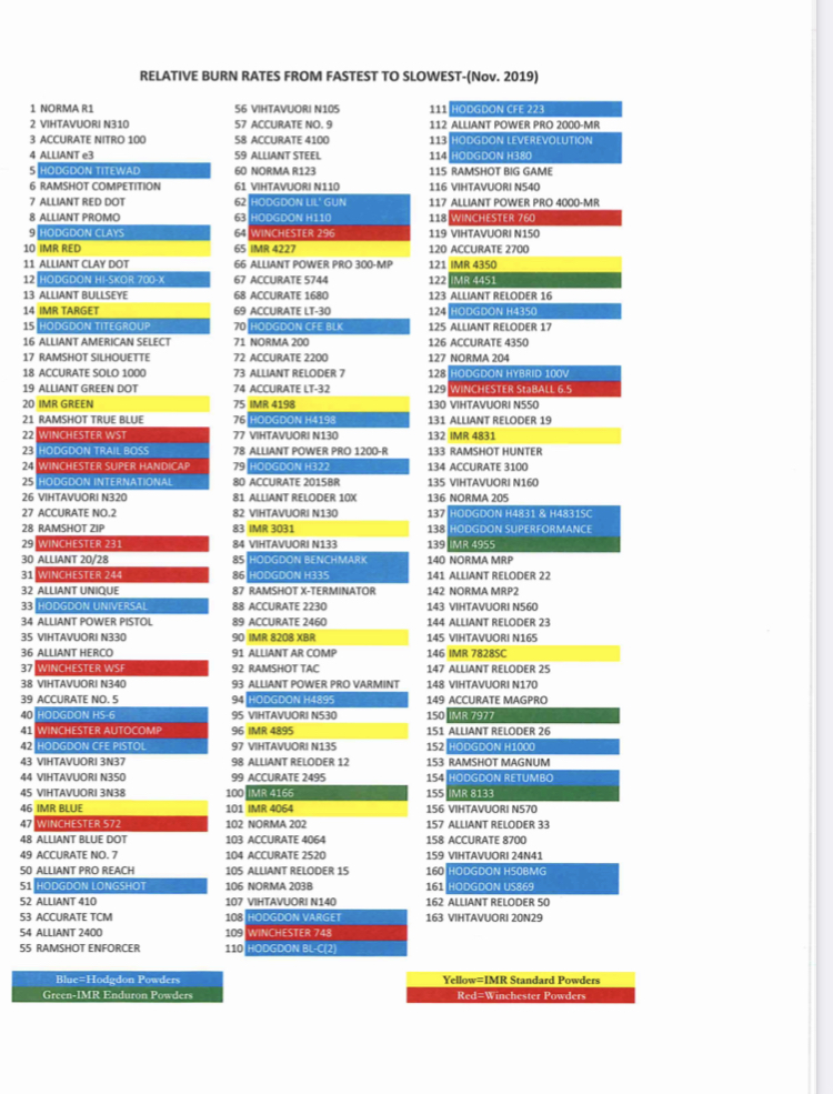

    I happen to have a jug of LEVERevolution, per Hornady it can be used for heavier 6mm ARC projectiles.
    I current run my 109gr 6 Gay Tigers at 2950.
    Has anyone had any experience with LEVERevolution with 6mm GT?
    I would hate to hurt my Tigers feelings…
    Burn rate chart. How close is it to what you currently use. Just a quick reference, will still need some due diligence

    I bet it would work pretty well, falls right between the Varget and H4350 burn rates that the GT likes. You'd just have to try it out and see if you find a good load, Hodgdon has load data for CFE223 (LVR is very similar), so I'd use that to figure out a starting load and work up. I use LVR in my ARC, but haven't tried it in my GT yet.

    Yup! That’s why I got the LVR, for the ARC, but since I am mainly playing with my GT, I’d thought it would be a good? Idea.
    I also have some CFE223, maybe experiment with that too?
