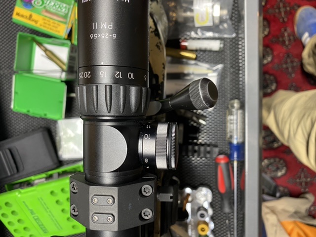

I have multiple lefty rifles with SB PMII and the all work fine. Stiller Tac30 pictured, Bighorn TL3 and a BAT TR, all work fine with the illumination knob.
1.4" era-tac and Spuhr and ARC M-BRACE, 1.5" height mounts.
Scott
Reactions: 1luckeyt/a

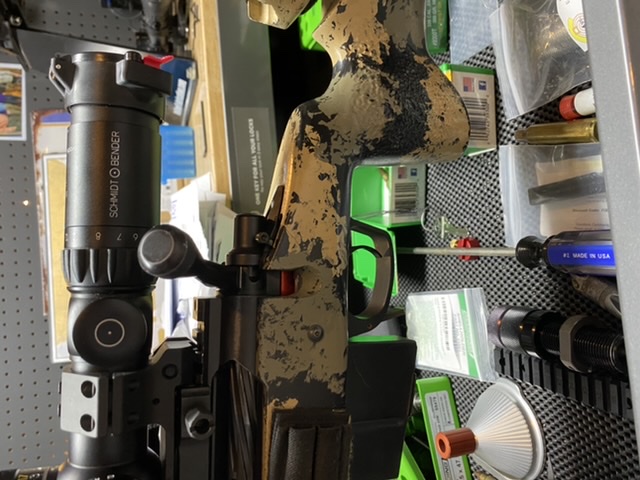

It depends on a lot of factors. The illumination knob doesn’t interfere with AI rifles, but it does interfere on a Tac Ops and on a custom rifle with a Defiance Ruckus lightweight action in a light fiberglass stock. I could use taller rings to help it clear, but that would throw off other elements of overall fit. I ended up snagging a PMII 6-36 for the Tac Ops rifle.
Scott
This is my experience as well. My S&Bs have been on both of my AIs and my Anschutz...no issues at all. I have used 36mm tall ARC rings in all applications.
