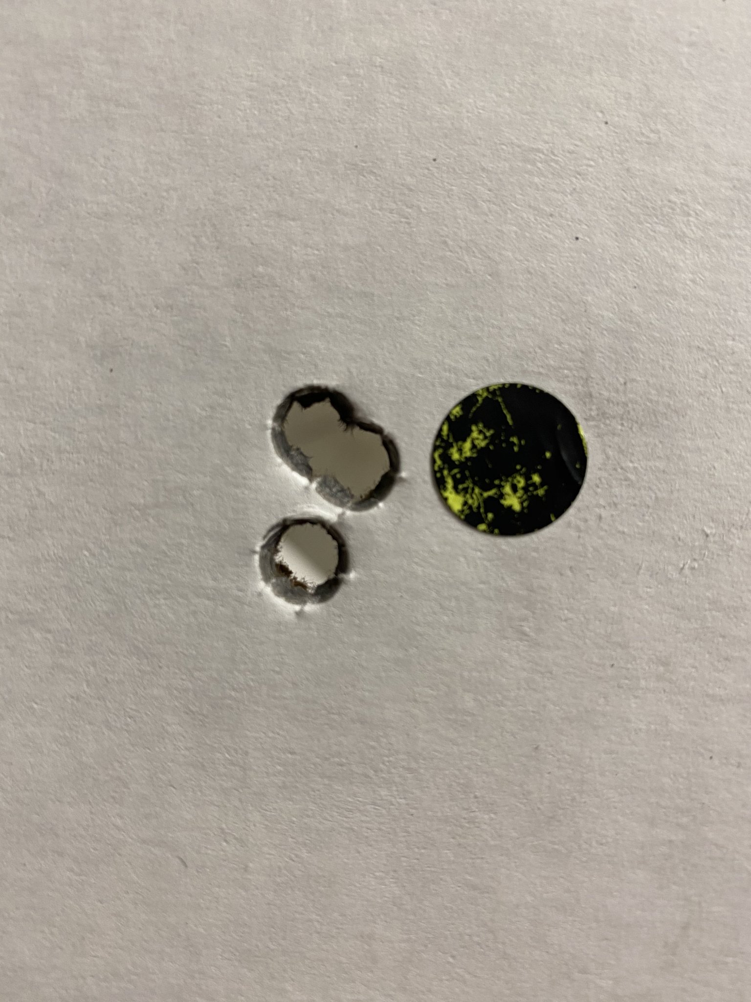

    Serge sent me this group of his LH GT 300PRC with factory ammo group
    here is the other thing, cause LH GT Is super easy to load for, but this is factory ammo according to @hic28
    This is a feature of GT Barrels, super forgiving

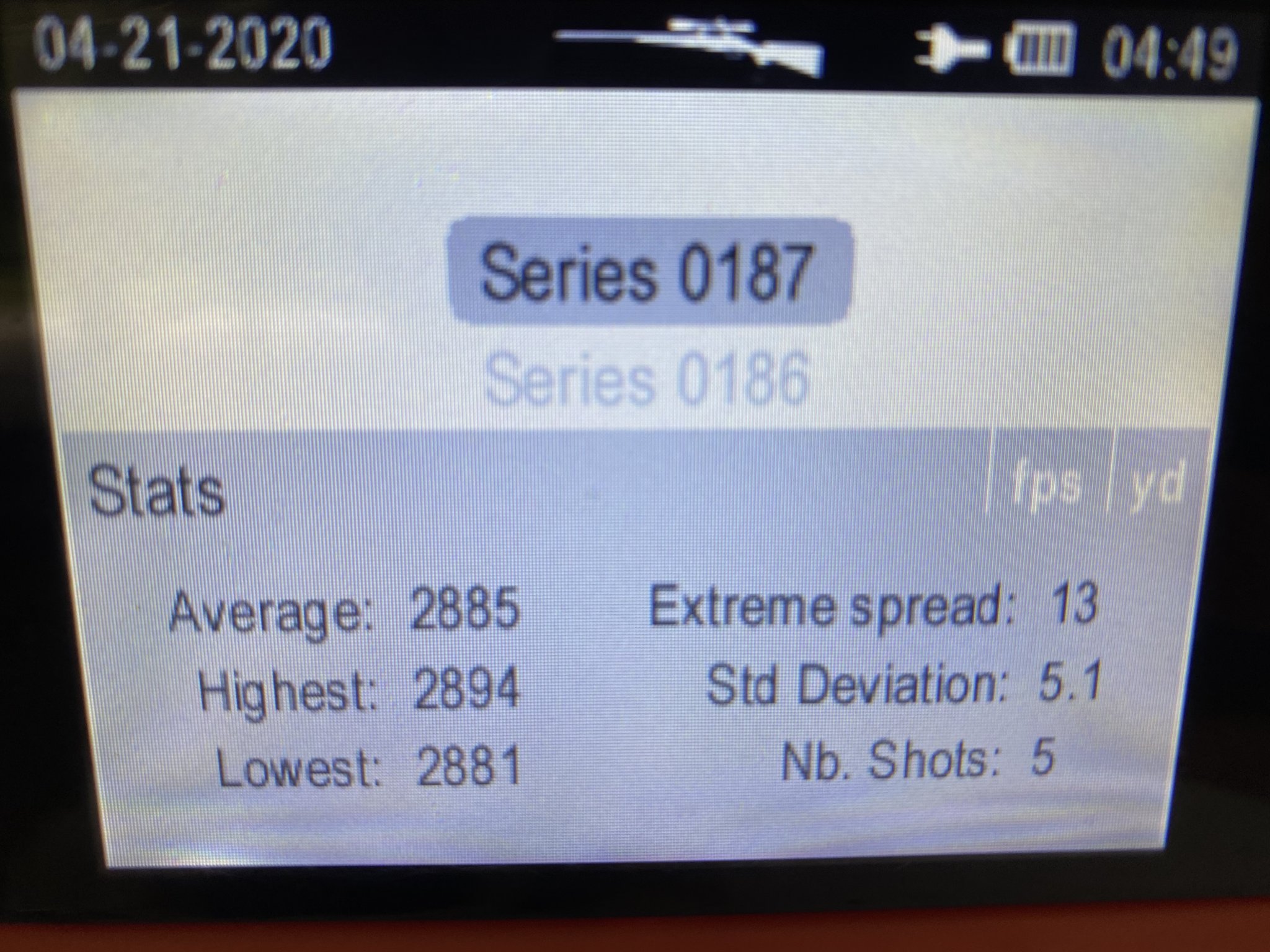

    I'm liking it. Hopefully I'll be able to get the same results as my last barrel. 2900 fps & bug hole groups. Now if the 4DOF app would let me click something for a LH twist...

    Yup. I’m impressed so far and only had time to put 20 rounds through it.

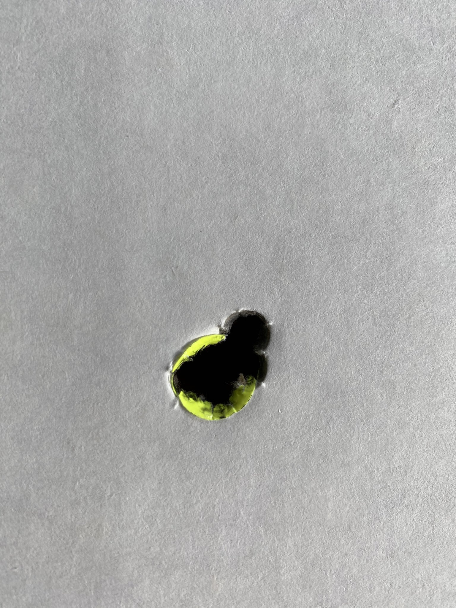

    while zeroing, first round low, came up a 10th then next 3 through a hole that looks like 2
