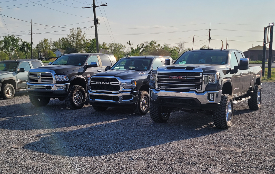

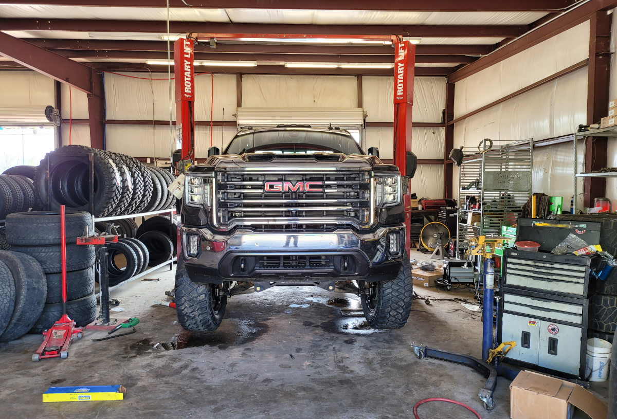

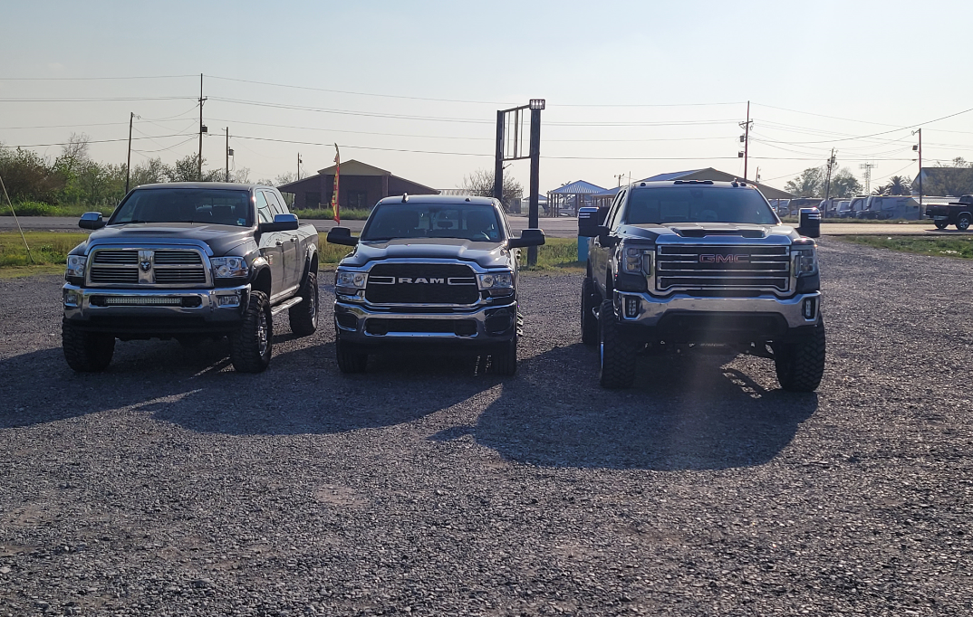

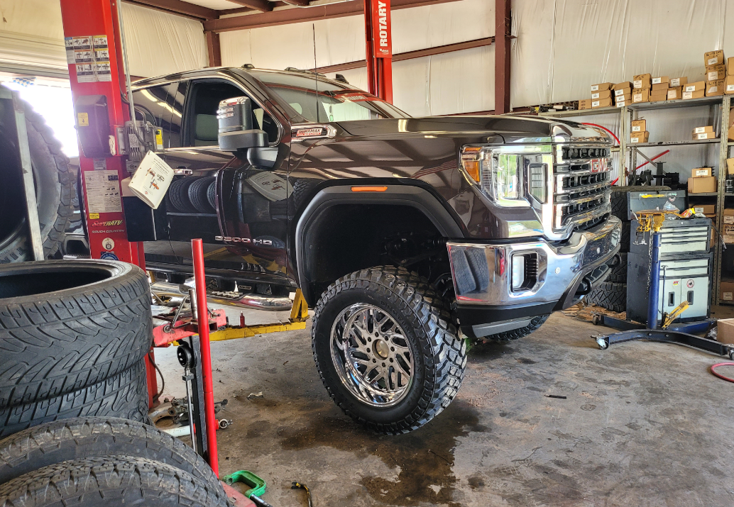

    Procomp 6" with 37x13.5" Firestone destination MT2 tires. Rims are Fuel Triton 22". The dodge mega cab 2500 on the far left with a Fabtech 5" and 37s is also mine. I thought they would be similar in size, but the GMC towers over it.
    I seriously considering a delete and tune. But not sure yet.

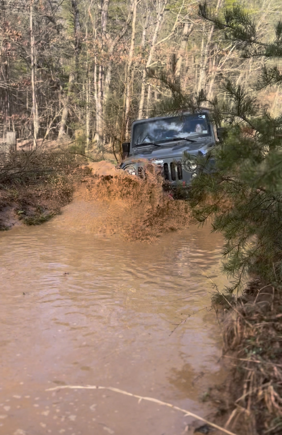

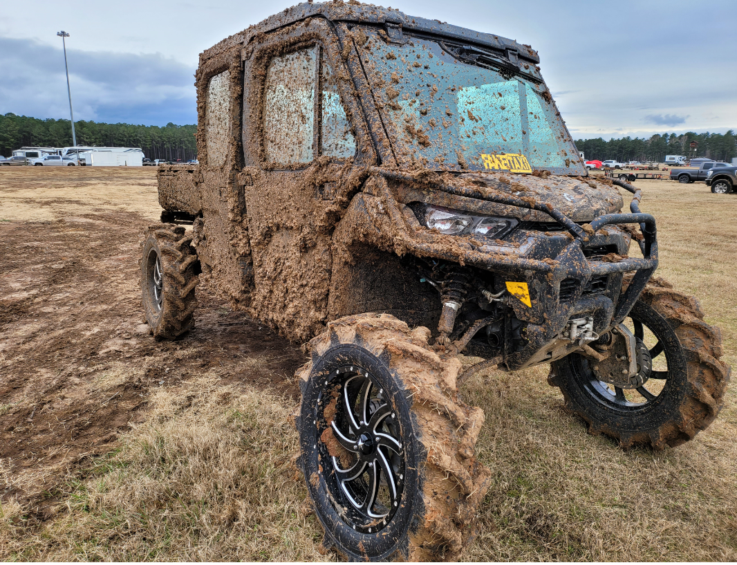

    If you're going to big gay truck status the least you could do is park it door deep in the mud.
    I lift my trucks so they can work. 35s are the smallest tire that works. Anything smaller is for the street.

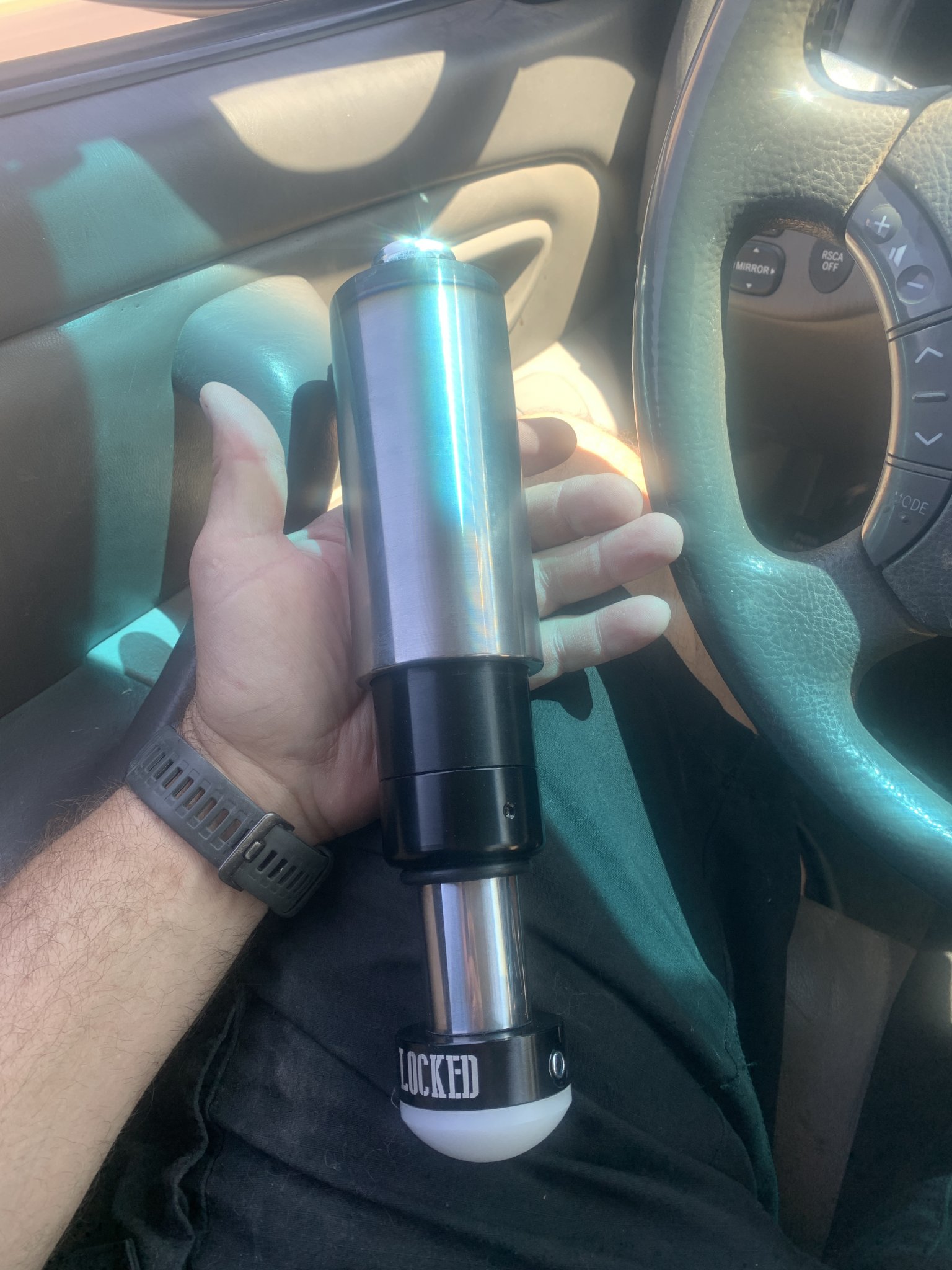

    I just got my 37’s on my land cruiser today. Had faulken wildpeak mt and went to goodyear mt/r. It’s technically a bigger tire, and i rubbed before, but some 14” fox dsc coilovers and 2.5” bumpstops from locked. Redline cruisers has plates that move the radius arms forward 1.3” so i ordered that and some tmr customs 14” towers. Inhave to rework my steering to be high steer/front steer which i have most of the parts installed for it, but going to go to 1.25”’heims instead of 7/8” so they have more articulation on the 3/4”’bolts, might have to notch the frame a hair.

    Is that… could that be… any chance that is…
    What I think it is???
