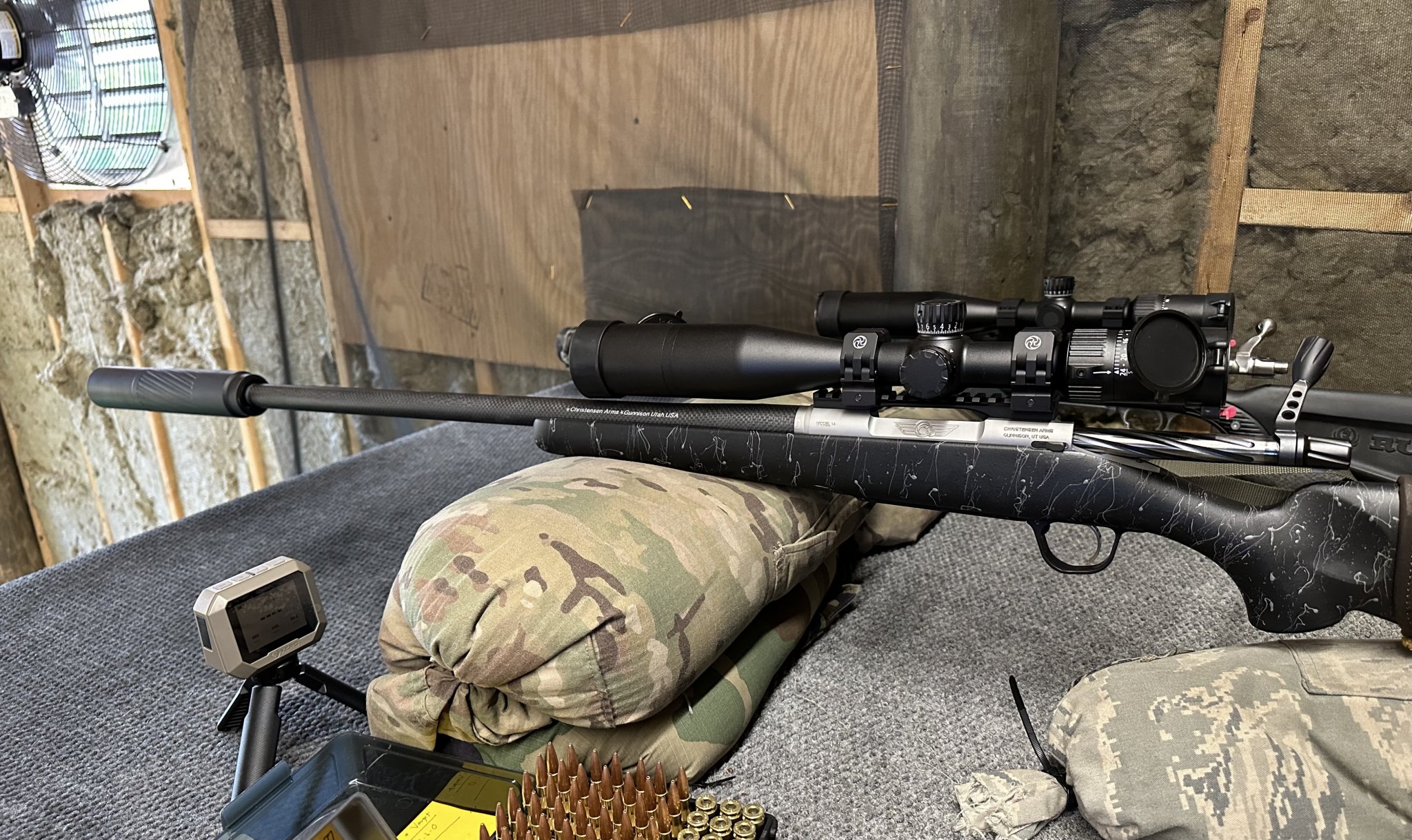

Here you go... This should get you exactly what you're hunting for to end up around 10 lbs or less. 5.7 lbs... Bare rifle weight...
I have the 24" version, and with Berger 175 Elites it shoots under 1/2 MOA @ 100 with handloads. My setup is well under 10 lbs. with the big TBAC Magnus on the end. The Zeiss V4 6-24x50 ZMOAi-T20 scope is only 23 oz. and has exposed turrets (locking windage), and the beefy ARC rings and factory 20MOA rail are rock-solid. If need-be I can weigh the whole rig for you, if you’re curious to know? I know I actually kind of am.

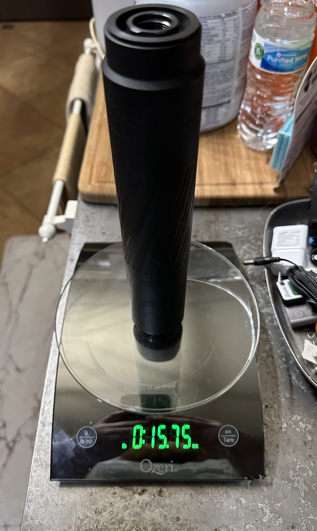

Magnus HUB w/ Otter Creek Labs ZR0-DTA 5/8-24 mount…

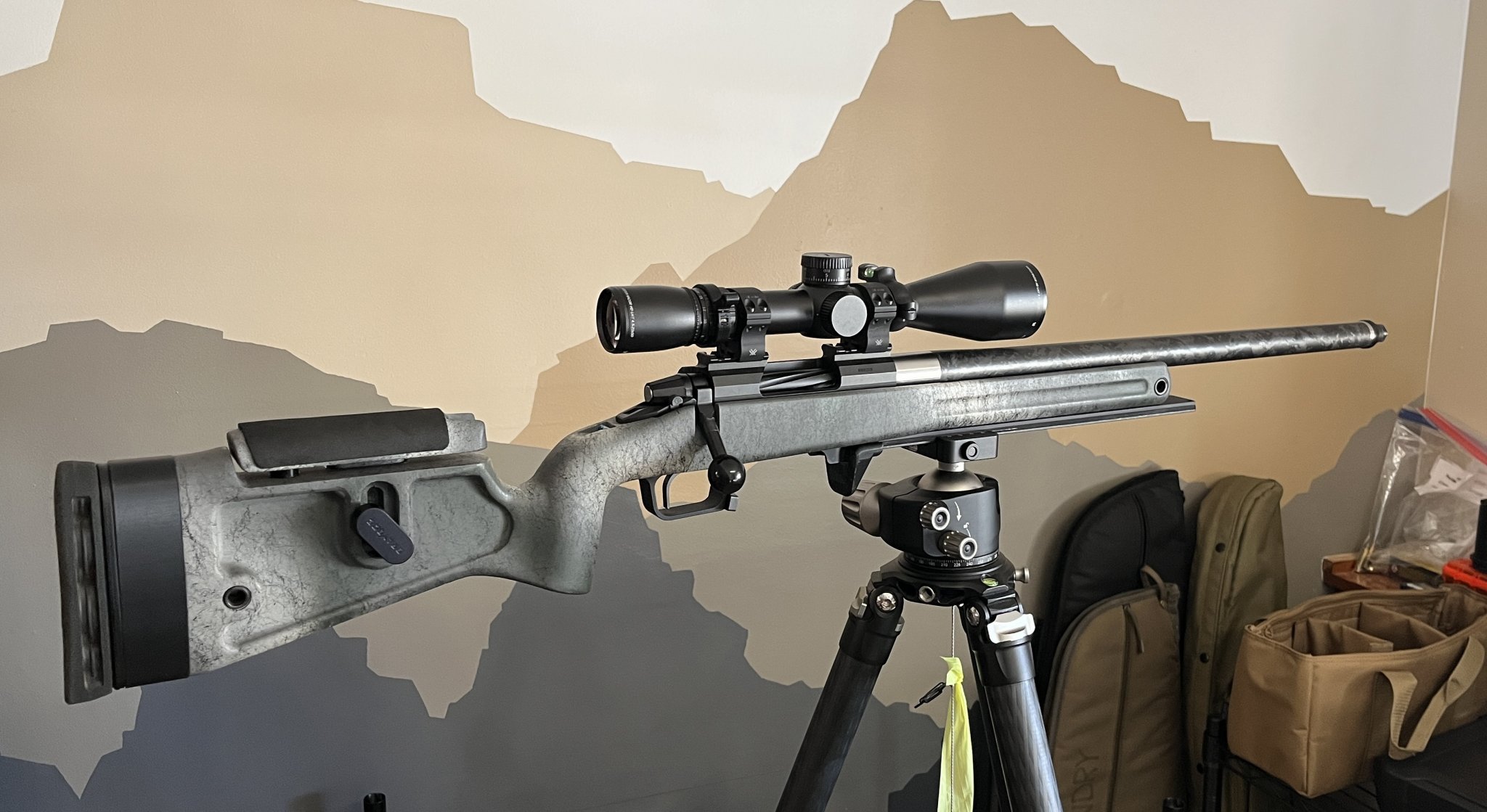

Here’s my 12lb NRLH rifle in a similar config. NBK, 22” Proof 6.5C, LHT 4-22, nomad Ti & Atlas CAL. I’m switching to a 16lb build for next year though.

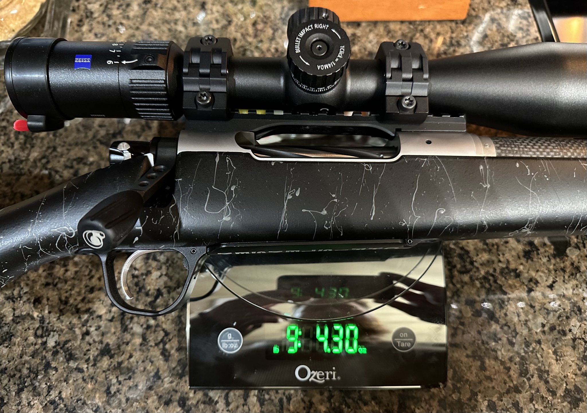

Ok, so the rifle rigged up, minus the suppressor is 9 lbs. 4.3 oz.
The Magnus + OCL ZR0-DTA mount is 15.75 oz. Which is only 1/4 oz. shy of 1 pound.
So, total rig weight of a 24” CA Ridgeline .280 Ackley with a Zeiss V4 6-24x50, ARC M-Brace 30mm rings, a CA 20MOA base, with the quietest .30 caliber can currently on the market is roughly 10 lbs. 4 oz. So, under 10.5 lbs total. 👍🏼
