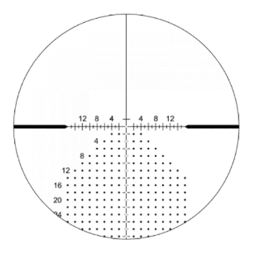

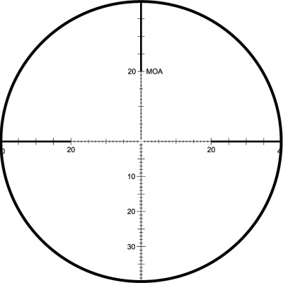

Yes, the Mk5 now has the option of the PR-1 MOA reticle & 25 MOA/rev turrets, which is a relatively basic hashed crosshair with a center floating dot.
I would agree that the AMG is worth looking at. The FoV of the AMG @6 is approximately the same as the Mk5 @5. Unless you are planning on shooting a lot at 3.6-5 power, I think the AMG is worth considering. I own a Mk5, but have only looked through an AMG at stores, so take this for what it is.
Edit to include image of PR-1 reticle that I mistakenly referenced
Edit#2
Looks like Mk5 is also available with Impact-60 reticle, which includes a tree
Sorry for all the confusion.
Edit#2
I was just about to post this with a link
Good point. I forgot about the Impact-60. I played with that reticle in the VX-6HD and while it worked well, I did get lost in the dots occasionally.
ILya
I could definitely see getting lost in those dots. I like the empty space at the intersections..
