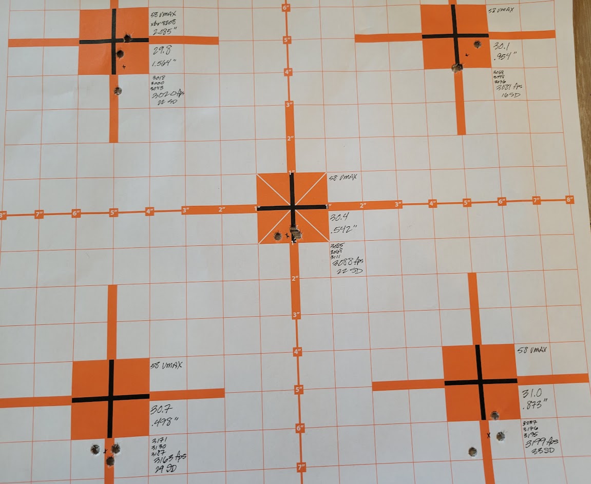

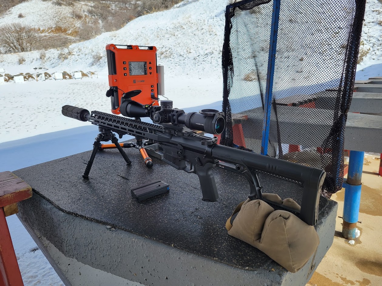

Here's my maiden voyage - shot in round robin style one shot at each target from the magazine TL, TR, M, LL, LR, three times. What would you run with? SDs aren't great, but this would be a 0-400 yard load for varmints. Temperature was 24 degrees.
....FWIW, I'd go with the 30.4 with it being the "middle" between the 30.1 & 30.7 which are the next best groups. Granted the 30.1 may appear to be large, but that high right hit could be shooter error. The 30.7 is beginning to open up, but still pretty tight. By loading at 30.4, you have +/- .3gns margin for powder drop variation (assuming you aren't meticulously trickling each charge). Seating depth testing may not be worth the effort & components if these are intended for varmints, but your call on that.
I think I'd keep pushing it. If there wasn't pressure signs. Seems slow for 58gr. Curious what you ended up doing
