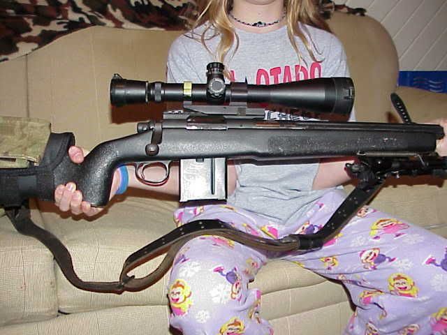

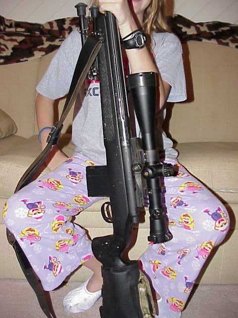

here you go....subtle and demure ....lite enough to hunt with and heavy enough to drive in a tactical comp....its killed a lot of stuff already...pigs suppressed and deer from my kiddos..

What is it and what does it weigh Bolt?
ETA- not trying to tell you how to be, bro, but you need to a hair cut. And some protein, man.
Re: Light weight precision rig
ah....its an old picture....thats one of my daughters...the one that paints toes
the .308 barrel is fluted and threaded, got HS bottom metal and sports different rings and base....weighs about 8 1/2lb dry.
