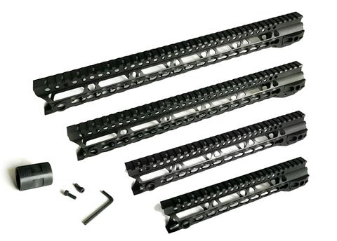

best lightweight AR 15 handguards
Free floating M-Lok Lightweight AR 15 Handguard
AR-15 Custom C-Cut Handguards

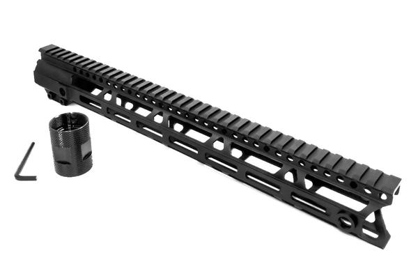

15 Inch Mach 2.0 Free Float m-lok Handguards
