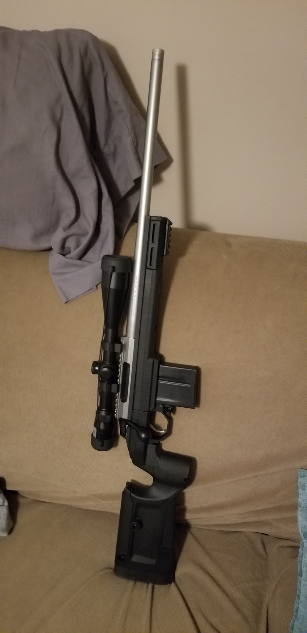

Weight is subjective, a well balanced 11 lb rifle can feel better than a poorly balanced 8 lb rifle. YMMV. I have a CTR in a bravo chassis and love it. Well balanced but I can't remember weight off the top of my head. Be advised it only accepts metal AICS mags, not that it matters these days with plenty of companies making the metal mags (Accurate mag, etc) I am also a KRG fanboy and have a few chassis.

Weight is subjective, a well balanced 11 lb rifle can feel better than a poorly balanced 8 lb rifle. YMMV. I have a CTR in a bravo chassis and love it. Well balanced but I can't remember weight off the top of my head. Be advised it only accepts metal AICS mags, not that it matters these days with plenty of companies making the metal mags (Accurate mag, etc) I am also a KRG fanboy and have a few chassis.View attachment 6886654
