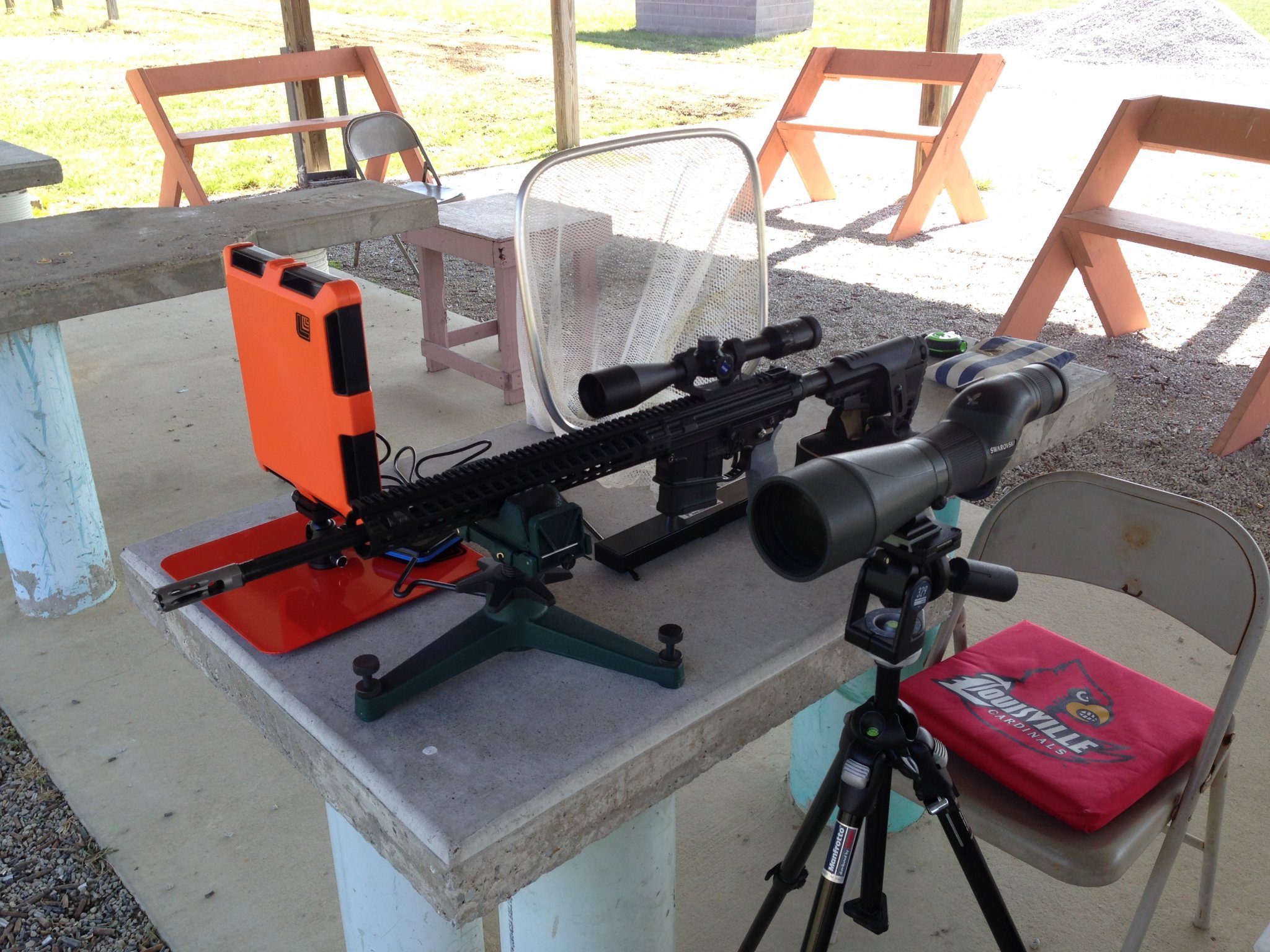

    With my test scope, Zeiss Conquest 4.5-14x44 Rapid Z-800, in Aero Precision lightweight mounts and a 10 round loaded mag, I’m right at 8.5 pounds. With a lighter scope I would be closer to 8 pounds. By now you might be thinking felt recoil could be a problem, but you would be wrong. It does not have a recoil pad and several days ago I put over 60 rounds through it and didn’t notice the recoil at all. Breastroker mentioned in his threads the combination of the lightweight bolt carrier, light weight buffer, good muzzle brake, and adjustable gas block makes for a shockingly light felt recoil impulse and he was correct; my experience is the same.
    BTW….I was in Boise, ID in January, and was able to stop by 2A Arms to see their manufacturing facility. They are not really set up at that location for sales, but since I had called ahead, they did give me a great tour! Their machinery is state of the art and mostly automated; it was very impressive. In addition, like many smaller manufacturers, they are passionate about their products, they use them personally, and they can innovate without the headaches of a large bureaucracy. Their products are a made to the highest level of quality on the latest machinery; I highly recommend them.
    https://2a-arms.com
    Its did the copper equalization barrel break in procedure with Nosler 123 CC bullets handloaded in Starline SR brass. After that, I began doing OCW testing with Nosler 129 Accubond LR and Barnes 127 LRX bullets; I plan to use it on an upcoming pig hunt, so target round testing will have to wait till later. Below is a picture of my results with the Nosler 129 Accubond LR, Starline SR brass, Reloader 16 powder, and Federal Match AR primers. This is the first time I have ever done the OCW method. I'm thinking my OCW is between the bottom two groups in the picture. When you look at each 3 shot group, the black diamond below it was actually the diamond I was aiming at when I shot the rounds. The Barnes 127 LRX performed in a similar way. I can't wait to see what this thing will do with a Berger or Nosler RDF!
    I know, I know, I need to do more testing and shoot some 5 shot plus groups, BUT, this appears to me, anyway, to be a good start and indicates it has good accuracy potential. The group in the bottom left of the pic had the following velocities: 2886, 2884, 2879. Most of the extreme spreads that day were in the low teens with a few like this one in the single digits.

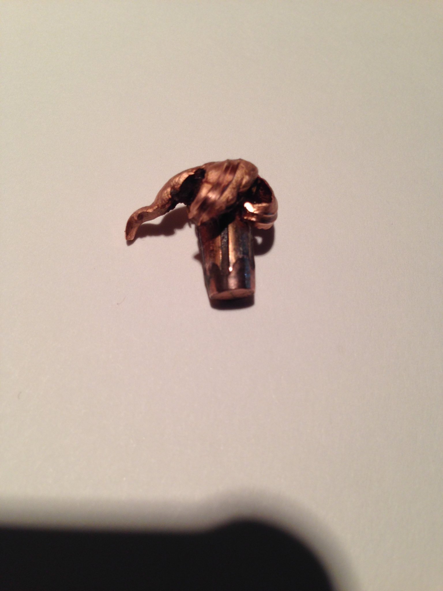

    I took it hog hunting last week and ended up shooting three boars. The Barnes 127 LRX worked perfectly and I was only able to recover one bullet. That was on a 203# boar facing me about 12 steps away headed my direction. I found the bullet under the hide in front of the back left quarter.

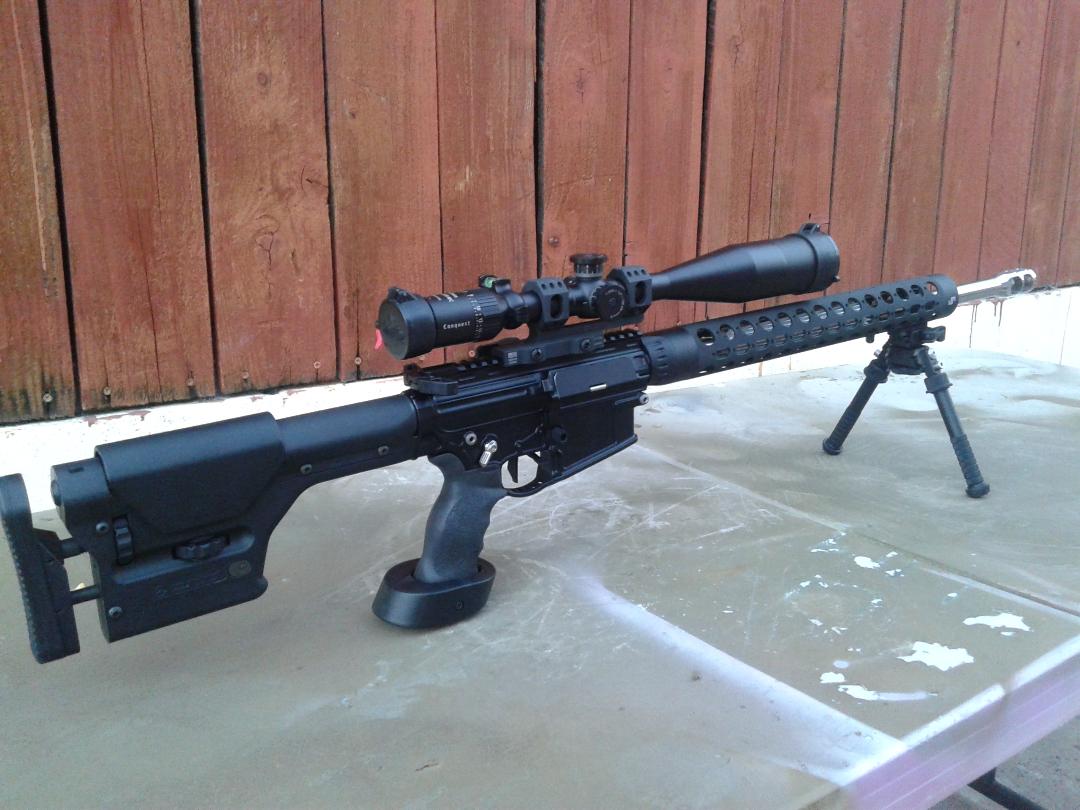

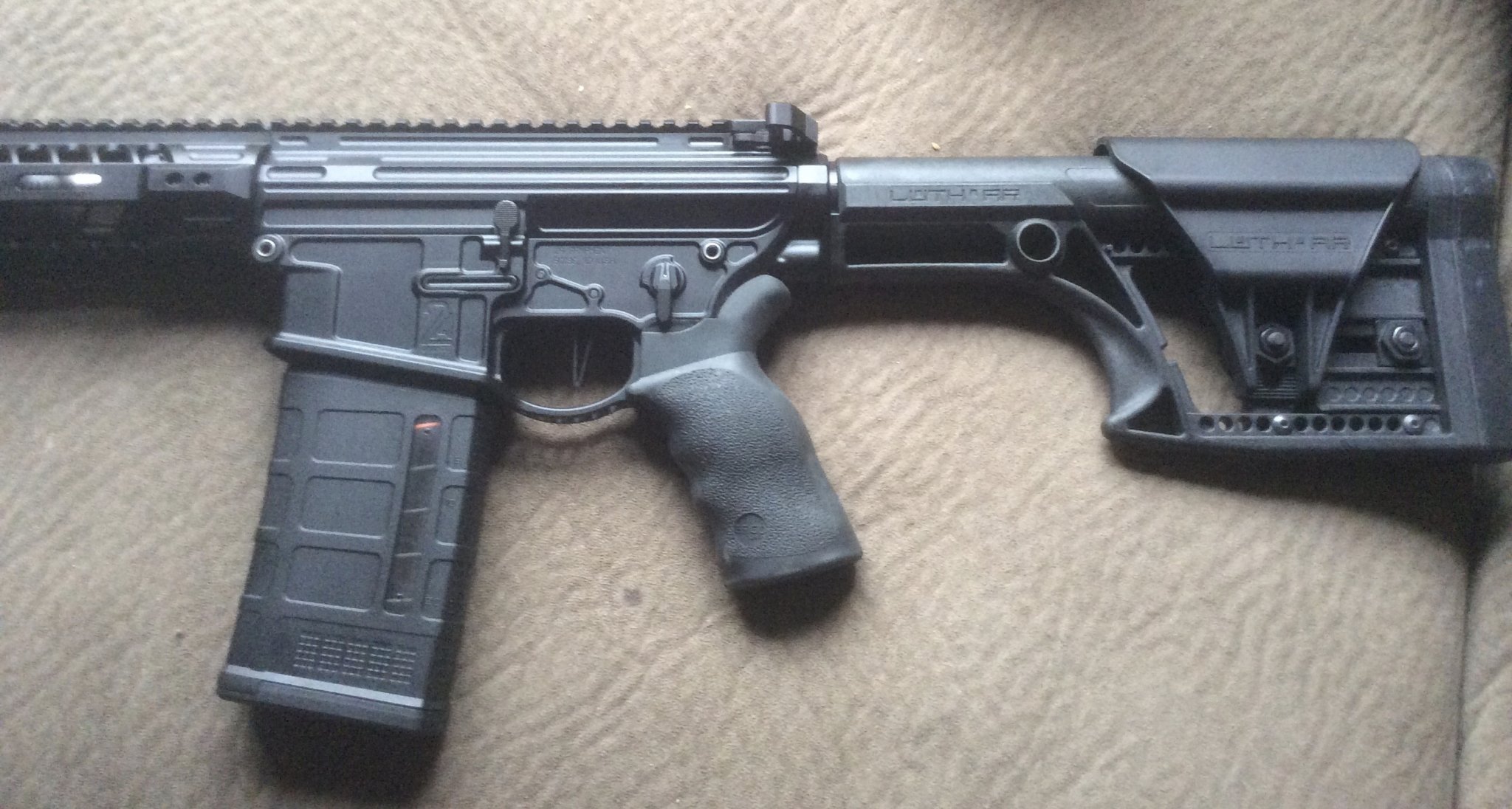

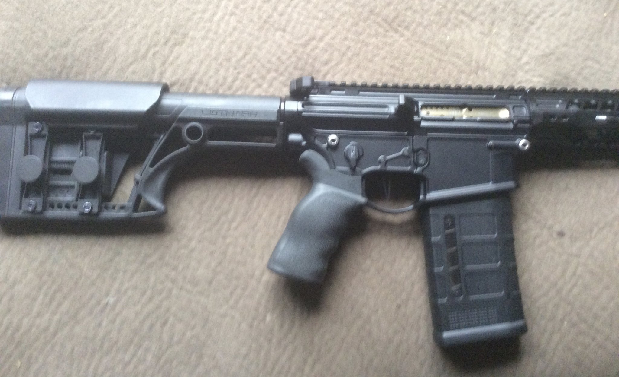

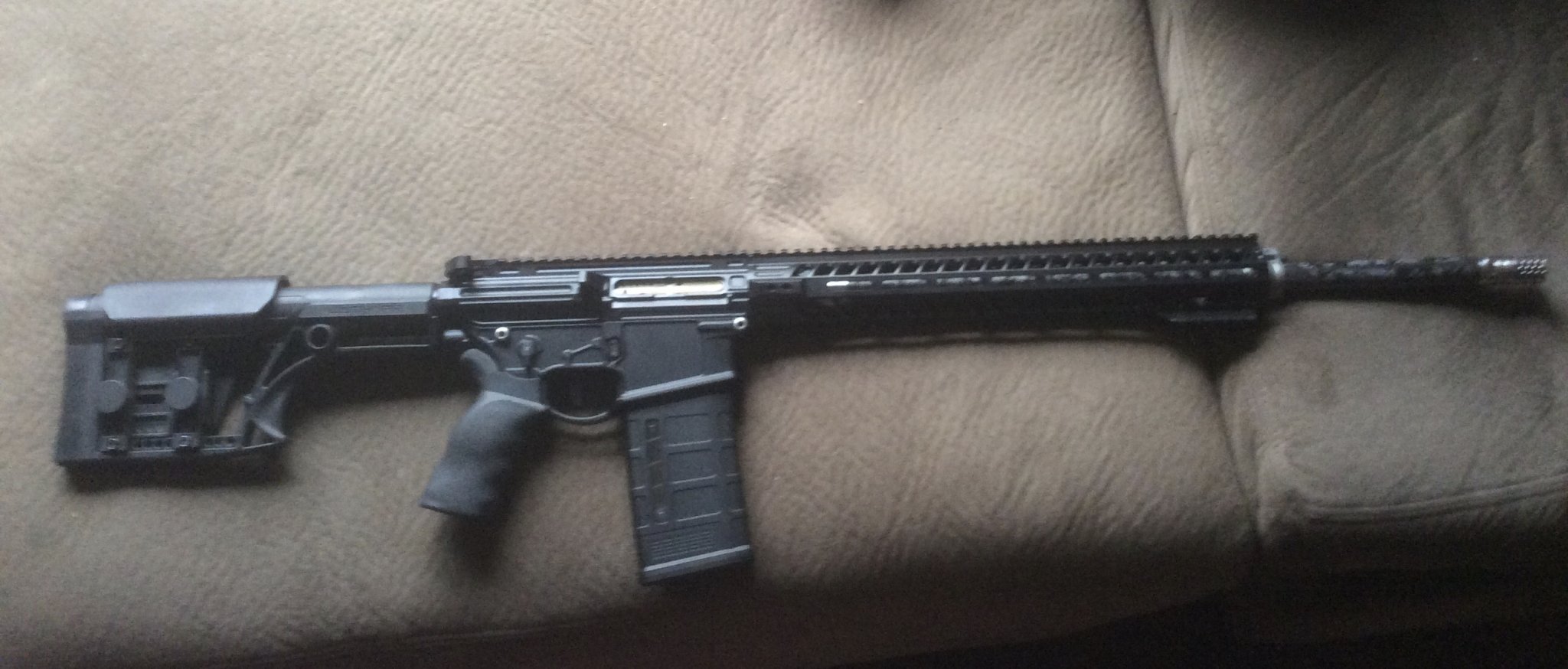

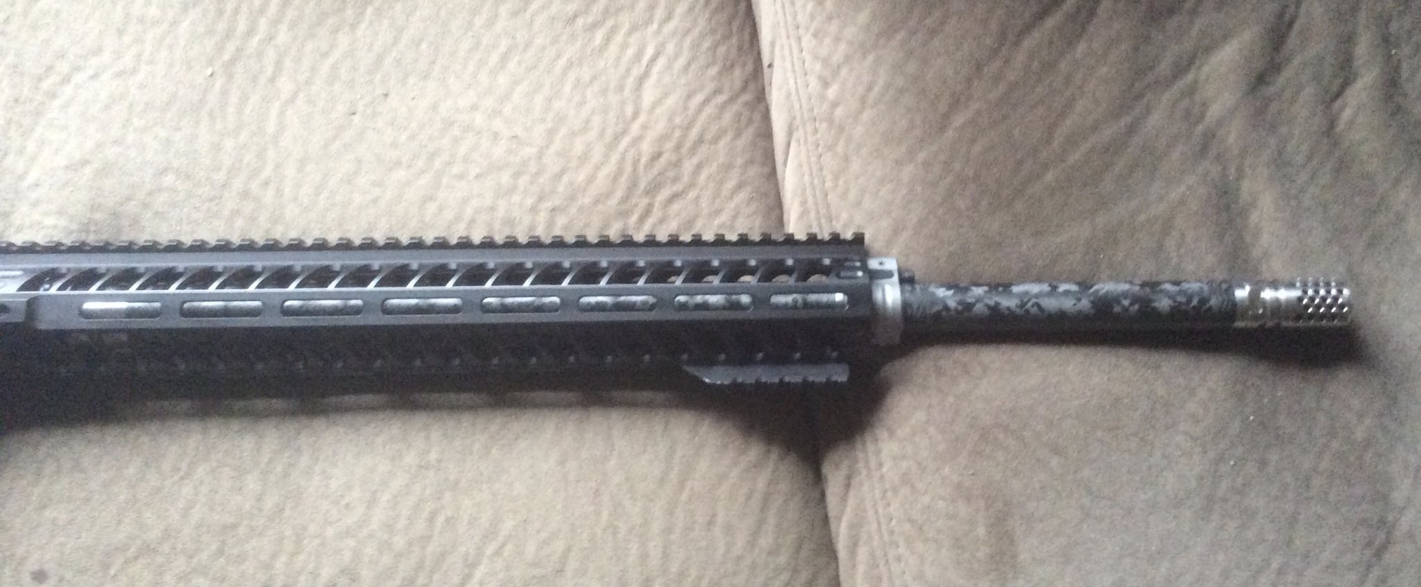

    Your build sounds a lot like mine!!!
    2A Xanthos upper lower
    Carbon fiber Proof 22" 6.5 Creedmoor Barrel
    JP Vmos and bolt
    Silent capture gen 2
    Luth AR Stock
    2A titnium gas block adjustable
    Slr titanium Break
    2A rail
    Titnaium take down
    Ambi safety
    Elfman trigger
    Very similar indeed! How's it shooting? 2A makes some very nice stuff. Which Elfman trigger did you use and how do you like it? I looked very hard at those, but was afraid they would be too much like my Geissele 3gun which is easy to bump fire if you are not careful.
    Man I absolutely love it! Everything about it. It’s the elfman AR10 trigger. Not the 3 gun or match and yes I love it as well.

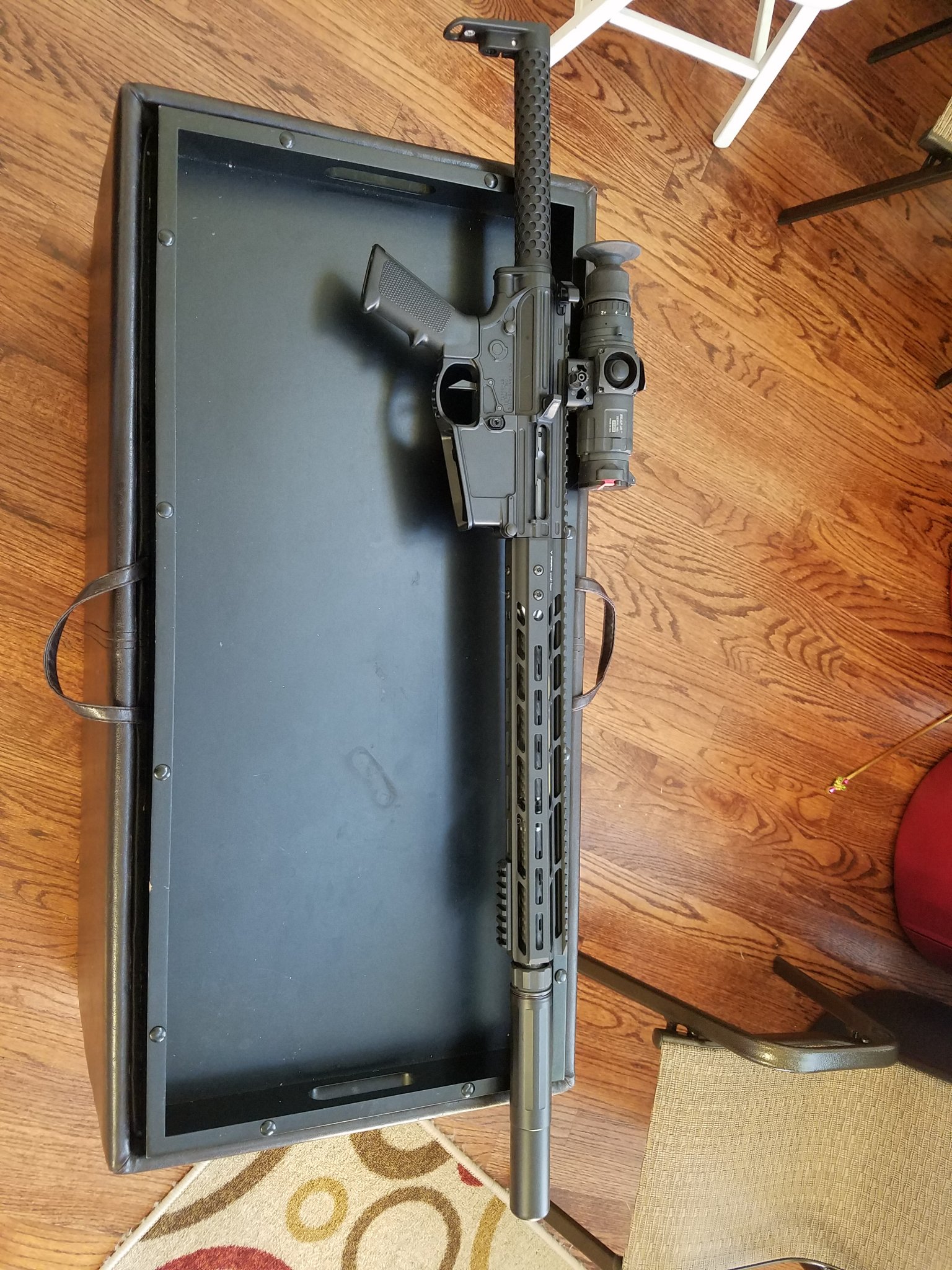

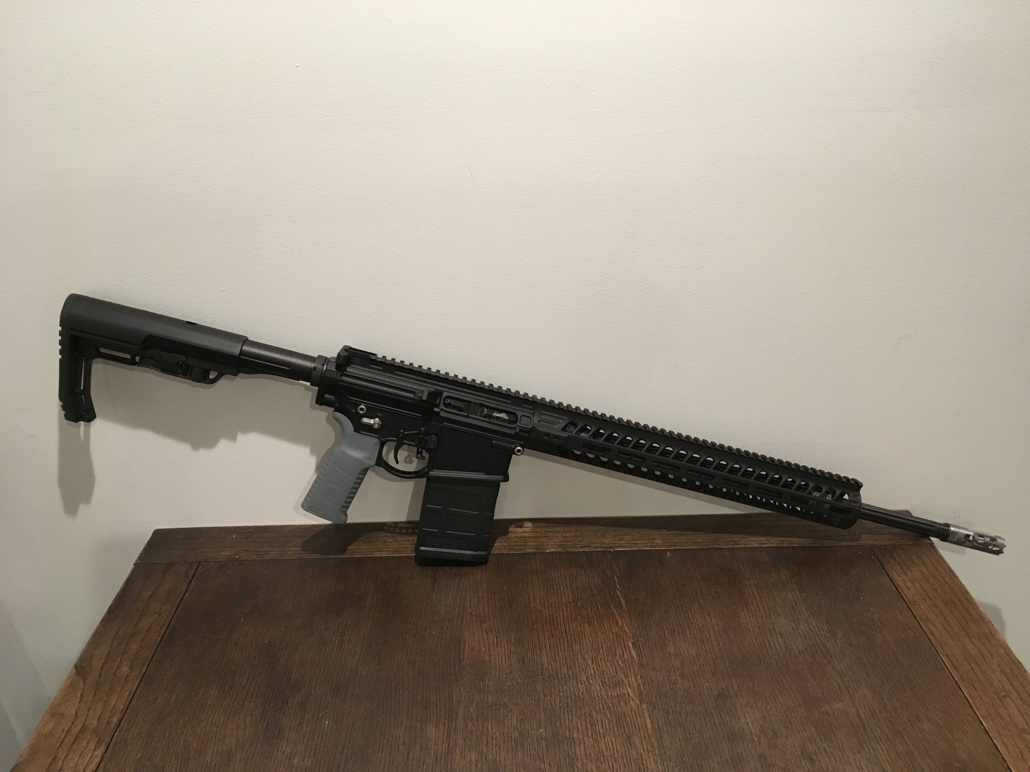

    Finished mine up and works great, recoil definitely more then my other 308s, probably due to the the sabertube stock but it cuts weight. 5lbs 14 oz without brake or scope.
    2A Xanthos
    BSF 16" barrel
    SLR Sentry 8
    V Seven Titanium BCG
    V Seven Ultraligte handguard
    Raptor SD Charging handle
    Geissele trigger of some sort
    6.5oz Heavy Buffer
    Pricey but will be worth it for hunting with my Reap-IR at night.
    Might try a lighter buffer later to try and reduce recoil if it doesn't affect reliability. Have it tuned with my Sandman L right now with no issues.

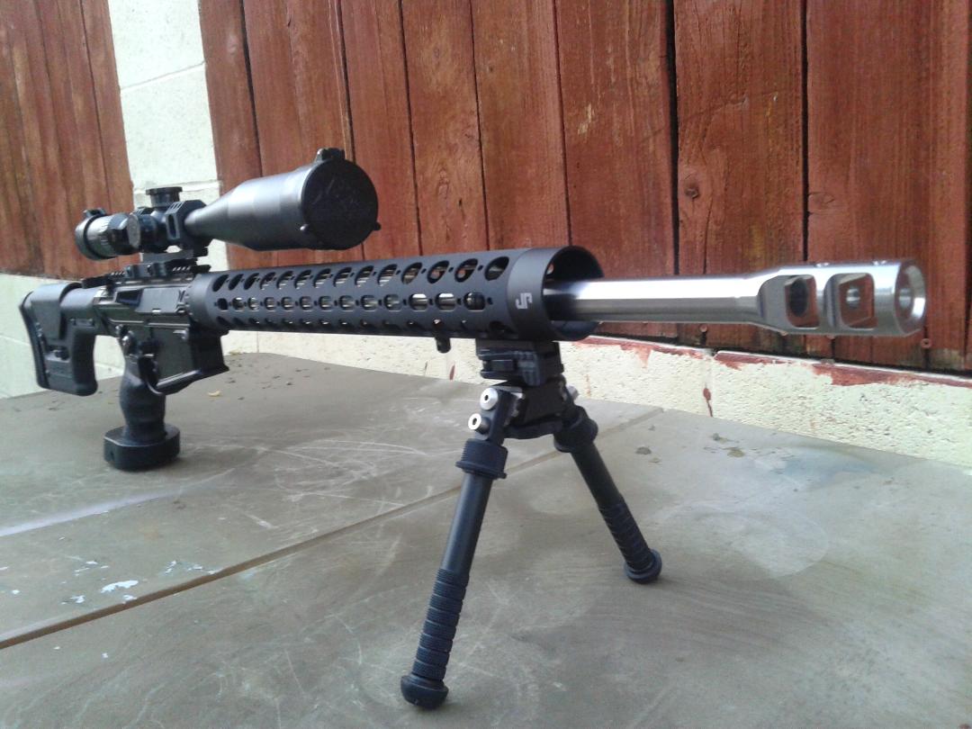

    The JP barrel weights, 3lb 5oz. It does shoot great with 39.4Varget and 123 AMAX/ELDs. The rest of the weights are as follows:

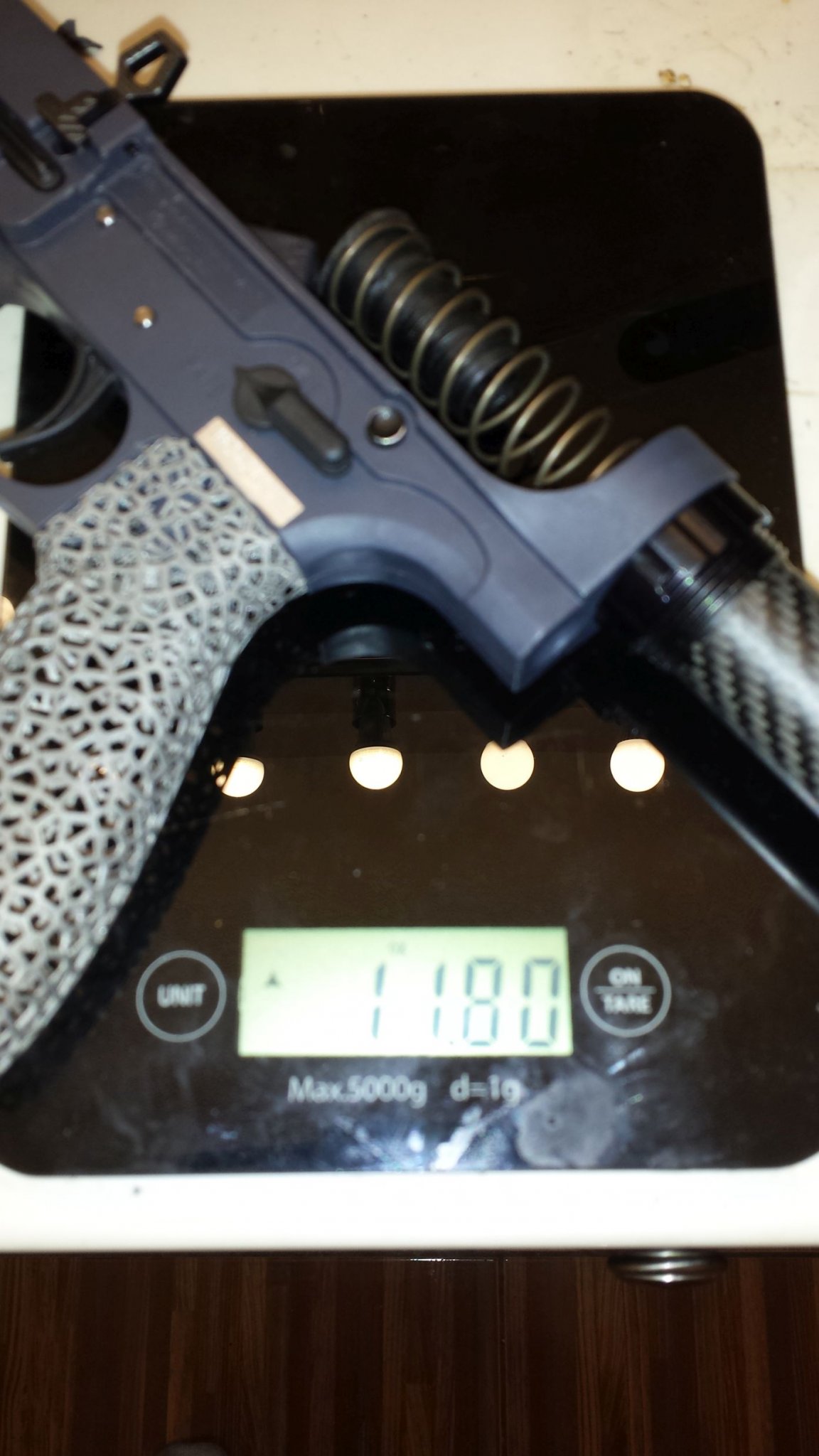

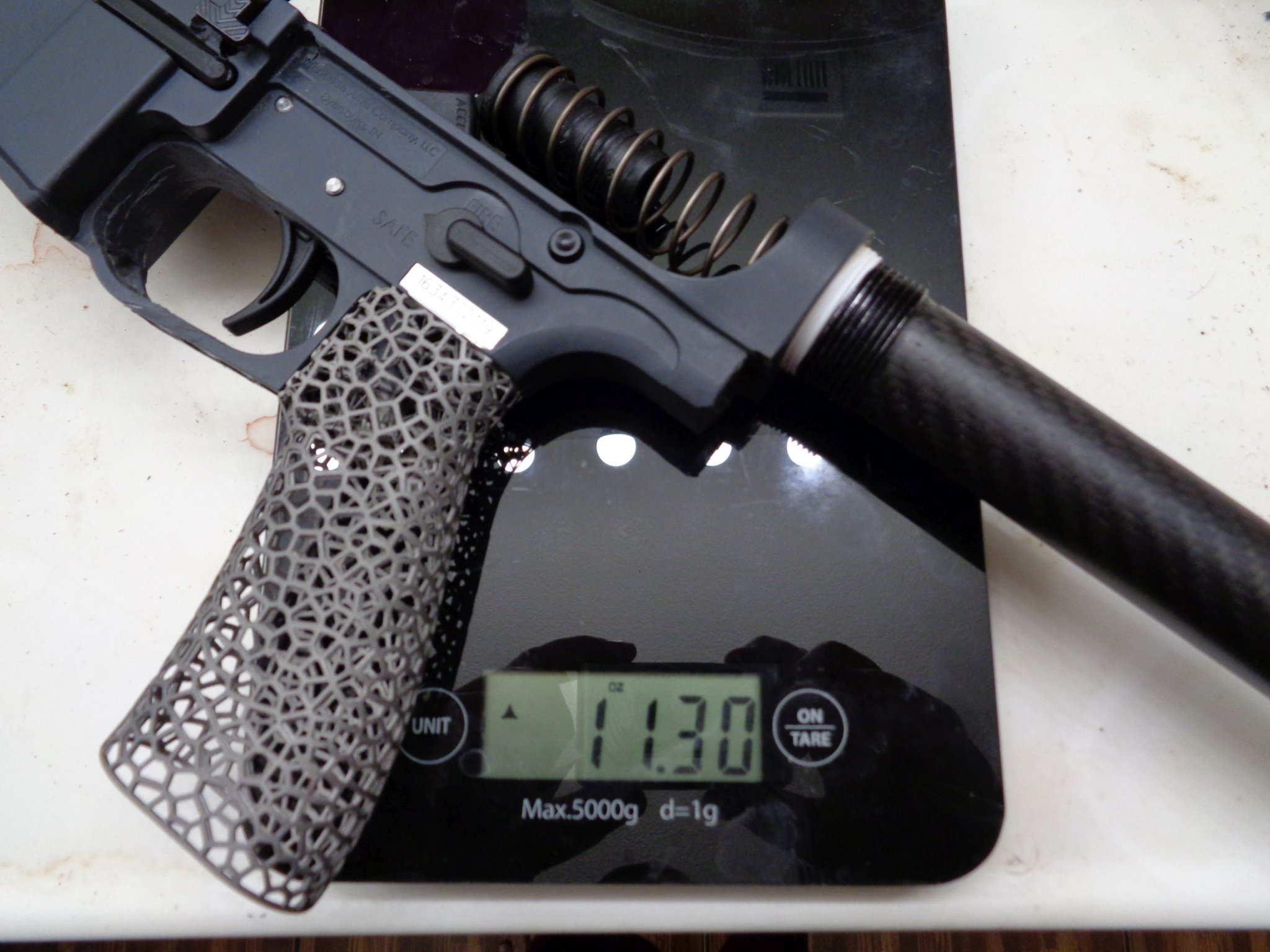

    2A upper/lower. 16.5oz
    JP Heatsink 5.2 oz
    JP large comp 5.6 oz
    JP handguard 17.25" with nuts etc.. 17oz
    Gas Tube 1.1oz
    JP SCS with spacer 6 oz
    JP LMOS w HP Bolt 14oz
    SLR GB 1.5oz
    ready to shoot with PRS stock/Ergo grip no scope/rings/bipod/rails it's 10.2lbs
    I could've def make it a lighter weight rifle but really wanted the 17.25" JP handguard so decided to just go all JP except GB. Between the PRS stock,ergo grip and JP heatsink i can easily drop another lb but its mostly a range toy so it hasn't bothered me so far.

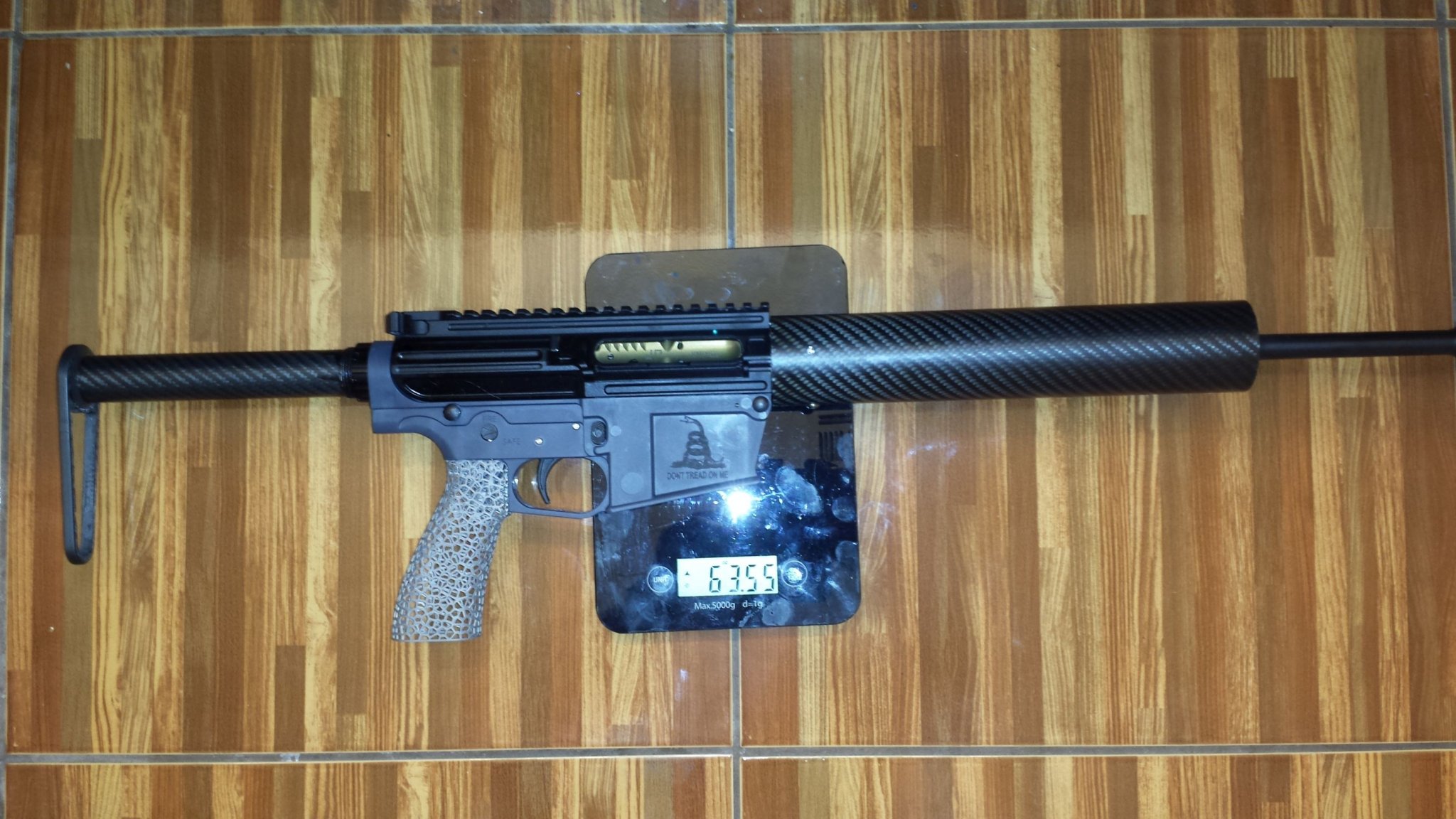

    JP Vmos and bolt
    Luth AR Stock
    Slr titanium Break
    2A rail
    Titnaium take down
    Ambi safety
    Elfman trigger

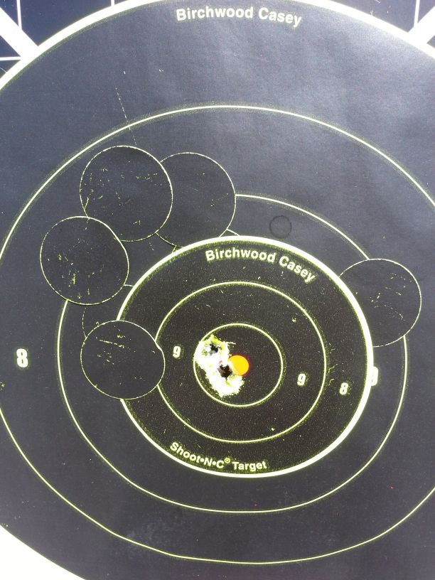

    I'm curious if anyone ITT has completed accuracy testing? Something in the 5 shot+ group range?
    I ask because I was/am considering a very similar lightweight .308 build with the 2A Xanthos set, but I'm a little worried after seeing the responses here. Granted they are discussing AR15s, but it seems like a lightweight upper is asking for MORE problems with POI shift when the handguard is loaded.
    Holy !@#$!

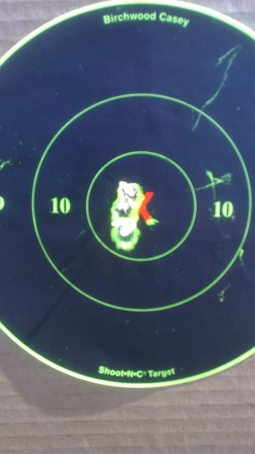

    I cant believe I finally figured out how to post pictures!
    Next test pic...left target 6.5CM Savage TA vs. right target 6.5 CM Xanthos (same pic as above) all groups are 4 shots.
    Xanthos has a 24" CF Christensen barrel. 140 grn Hornady ELDs with RL-16 powder. I had to change out the bolt and firing pin to HP, because the RL16 @ 2800 fps and up was popping primers.
    Reactions: Srikaleak
    Ok...I cant figure out how to edit posts (frickin newbies...)
    But the question was asked earlier if contact with the Xanthos forearm caused the groups to move...When I was shooting factory Hornsdy 140 eld's at 500 yards I noticed if i really put alot of pressure on the forearm I could get the groups to move. The reason the groups on the right target are moving is these are different amounts of RL16 and I was changing the seating depth...but I cant find that info for the life of me...I normally add it to the targets like I did with the Savage TA target on the left...
    D'OH!
    Earnhardt those are some damn good results. You say you noticed you can shift POI by really loading the bipod. About how much would you say you have to load it to really notice a difference in POI? Would you ever load it that much under field conditions is basically what I'm curious about.
    Also, edit is on the bottom left of your posts :).
    On my phone the edit button isn't there...on my desk top computer the edit button is there....weird...
    I was shooting from a Lead Sled with no weight.
    I just wanted to try and see if I could get the groups to move...and I could but I really had to crank on the forearm and grip.
    Would that happen in a real would hunting or target shooting scenario...I don't think so.

    View attachment 7021359View attachment 7021360
    Here are some of the groups from the pencil barrel
    Starting my first 6.5 Creedmoor AR build, using the 39.4 ounce Faxon 18" Match barrel. Got another 2A Xanthos upper receiver (9.0 ounces) coming Monday 2/22/19. Using my Toolcraft carrier and a JP bolt, the carrier has been cut down some total weight with Ti firing pin is 11.18 ounces. Will be using one of my custom CF hand guards @ 2.9 ounces complete. Hoping for under 5.5 pounds. Only have the one 3D printed titanium pistol grip at 0.75 ounces, so will be using a Hogue grip at 1.1 ounces
    Reactions: KYAggie and Potss
    Breastroker, you rule in making AR10’s lightweight! Your posts on M14forum in 2017 set me on my path and really took my eyes off the M14 platform. Looking at your groups, I wish I had gone with the pencil weight barrel instead of the 16” Gunner; I would have saved a few oz. I don’t have my 308 put together yet, but I’m estimating it will be 5.9# which seems like a boat anchor compared to yours. That grip and CF hand guard really make a huge drop in weight! I do love my Faxon Fluted 5r 6.5 CM barrel. Hope to get it out and see what it can really do this spring/summer with good match bullets. Got sidelined the second half of last year going through the bid D and I don’t mean Dallas. Hung onto my guns at least. Man when a woman goes crazy they go full on damn the torpedoes. At least my life is considerably less chaotic these days, my home has never seen this level of peace.
    Nice job on the 3.9#er!
    What’s that Frontier lower weigh? Just wondering how many ounces you drop with a Xanthos upper and Frontier lower compared to a Xanthos upper/lower set.
