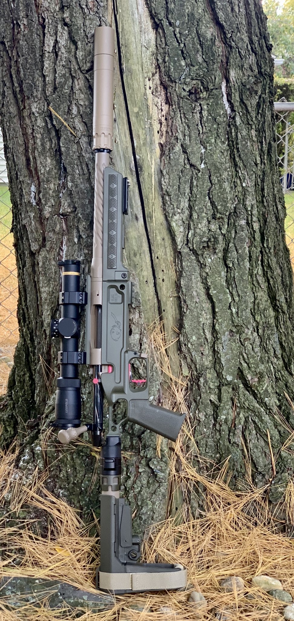

MDT LSS Gen 2. Takes carbine buffer tubes so you throw a lightweight folder on and keep it as a pistol or a Black Collar Arms Pork Sword. I have a 10” 450bm pork sword pistol on big horn origin
Reactions: Memberberries
Yeah the LSS is a slick little chassis. Almost went with it over the pork sword chassis but with a name like pork sword I had no choice.
There is an LSS pistol chassis on Brownells, it was discounted last I saw. Looks to be the same except the forend. Add the folding AR butstock and go.
