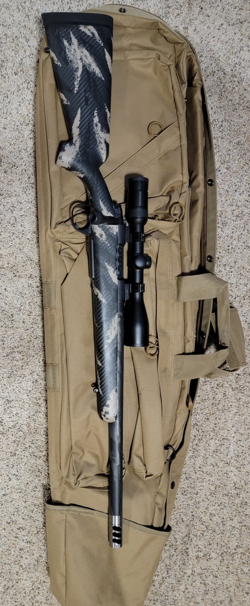

I put together a 6.5 PRC with the 24” proof sendero prefit, anTi-X action, Hawkins hunter DBM and flush mag, and AG Alpine hunter stock. It weighed 6 lb 7 oz if I recall correctly.
That seems like a very manageable weight to carry in the mountains. I haven’t gotten my hands on a antix action yet how do you like those when compared to a Curtis or terminus? Thank you to all for your feed back
I wouldn't be able to compare, I've never owned a Curtis or Terminus or Kelby. All my customs have had Defiance actions (or GAP Templar which is made by Defiance). The anTi and anTi-X are very nice actions. The one I have pictured was coated with cerakote. I have a few that were black nitrided and I now prefer that to cerakote (for the action and bolt). Much smoother action cycling.

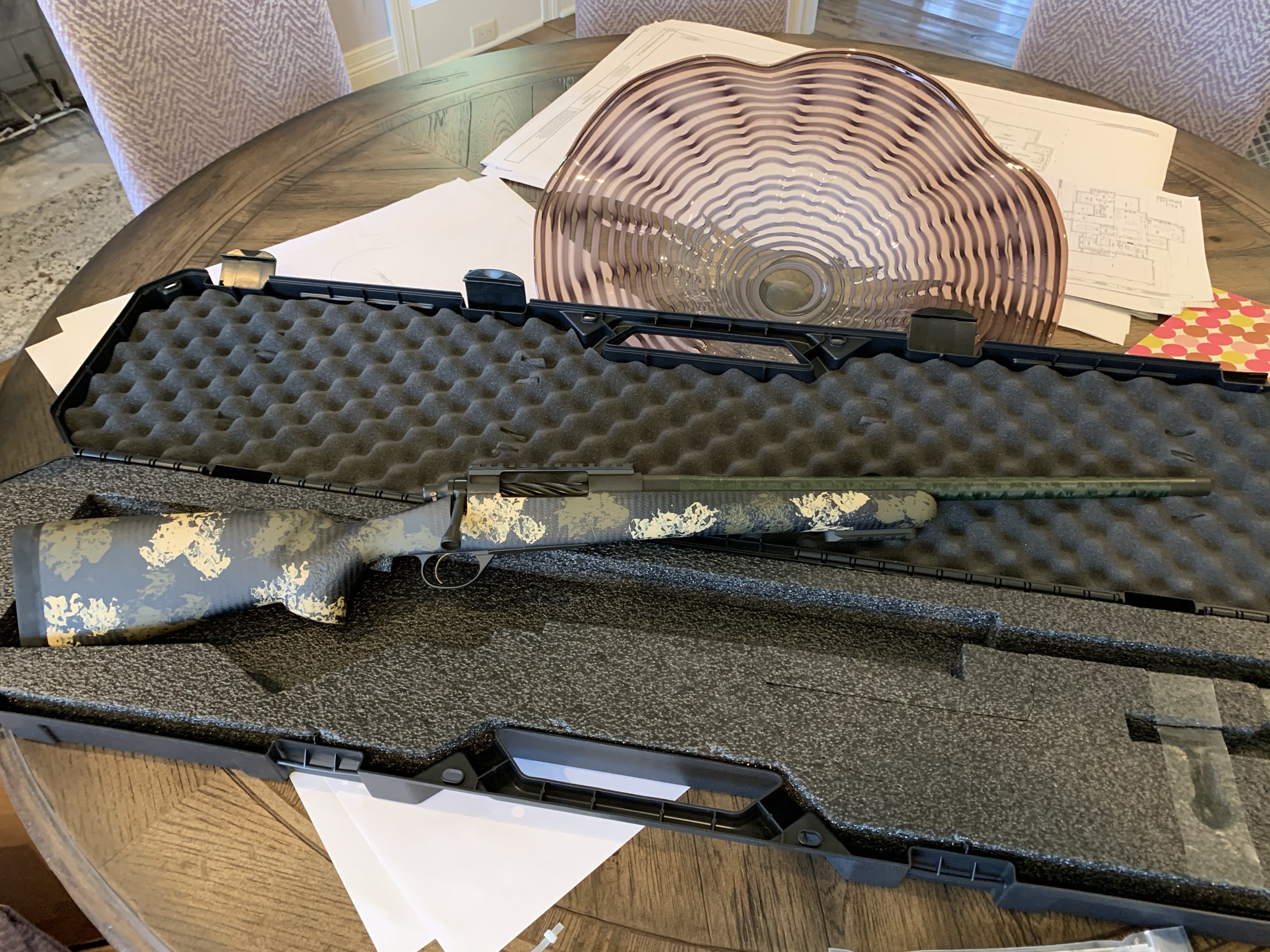

My experience is that the lighter you go, the more all the small things matter. Those small things cost money. Here's a 6.5 CM that's headed to sumfikistan to hunt this year. 6lbs. all in. Shoots in the .2 to .3 area. But the lightweights are harder to shoot accurately.

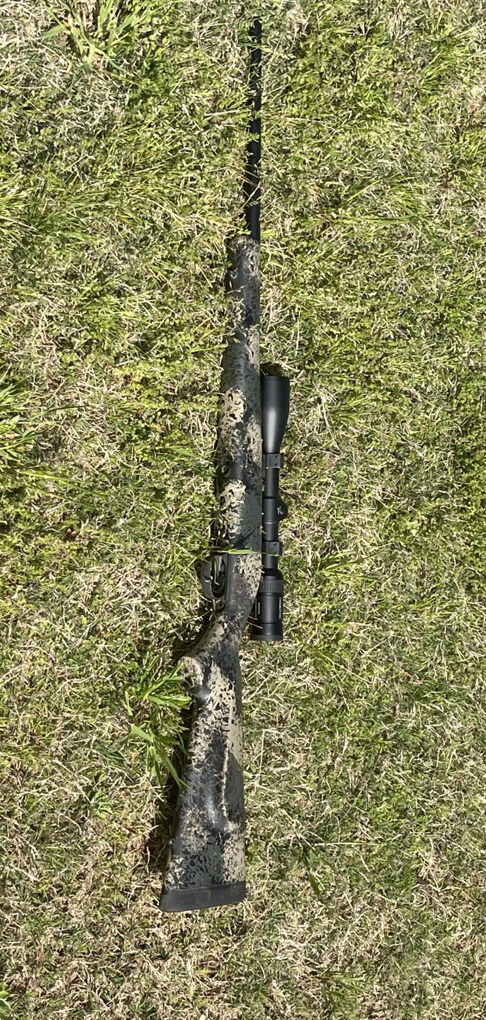

I bought a Forbes 20b and had Southern Precision fit a Bartlien featherweight profile since the original barrel shot like shit.
It’s 6lbs total with the z3 3-10x and a diy rattle can paint job.
I probably have 2k into it excluding optic and honestly wouldn’t sell it for twice that.
