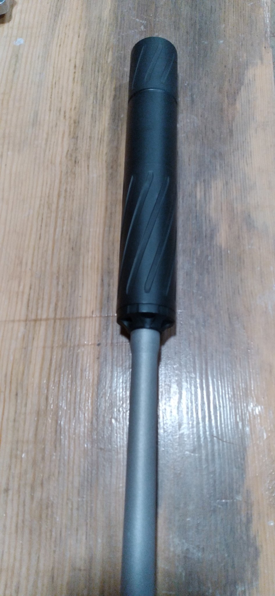

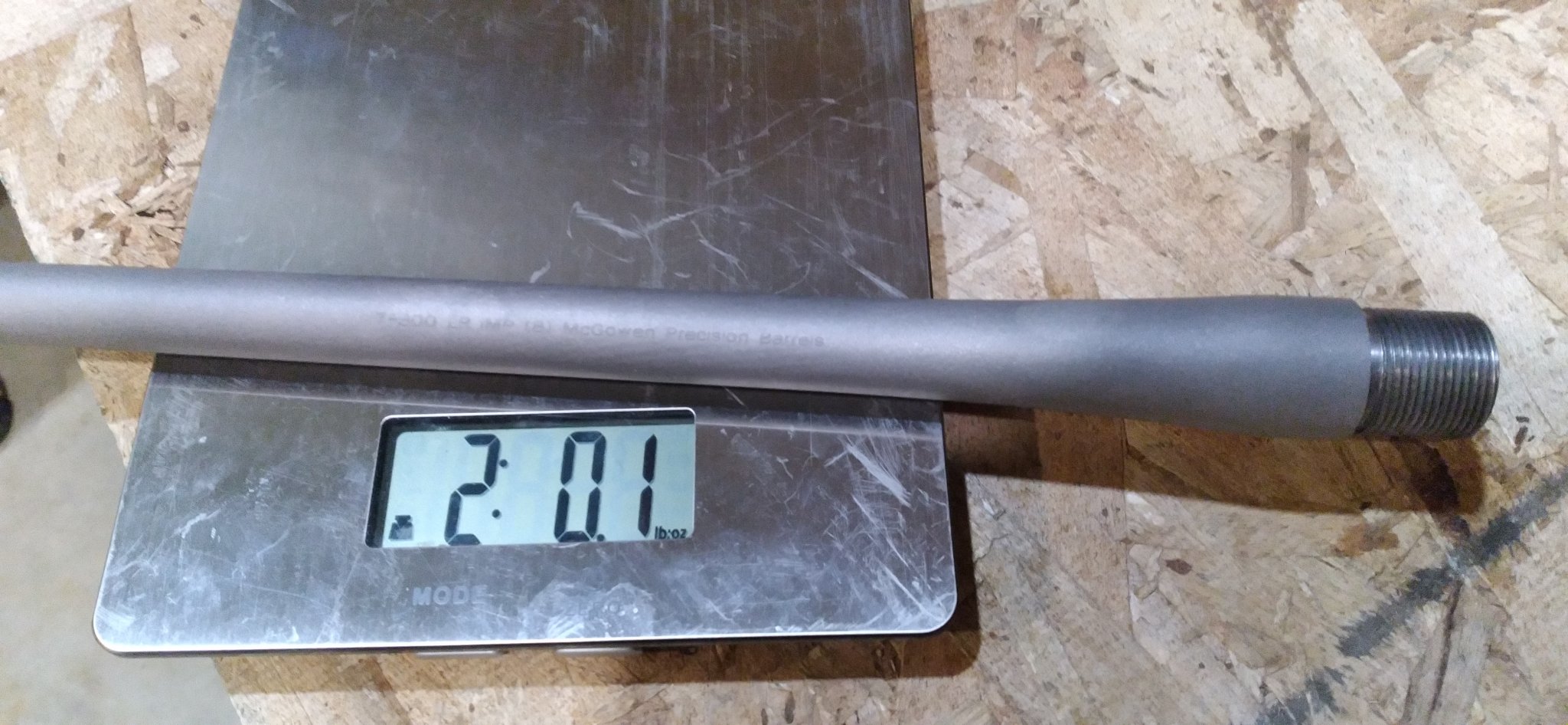

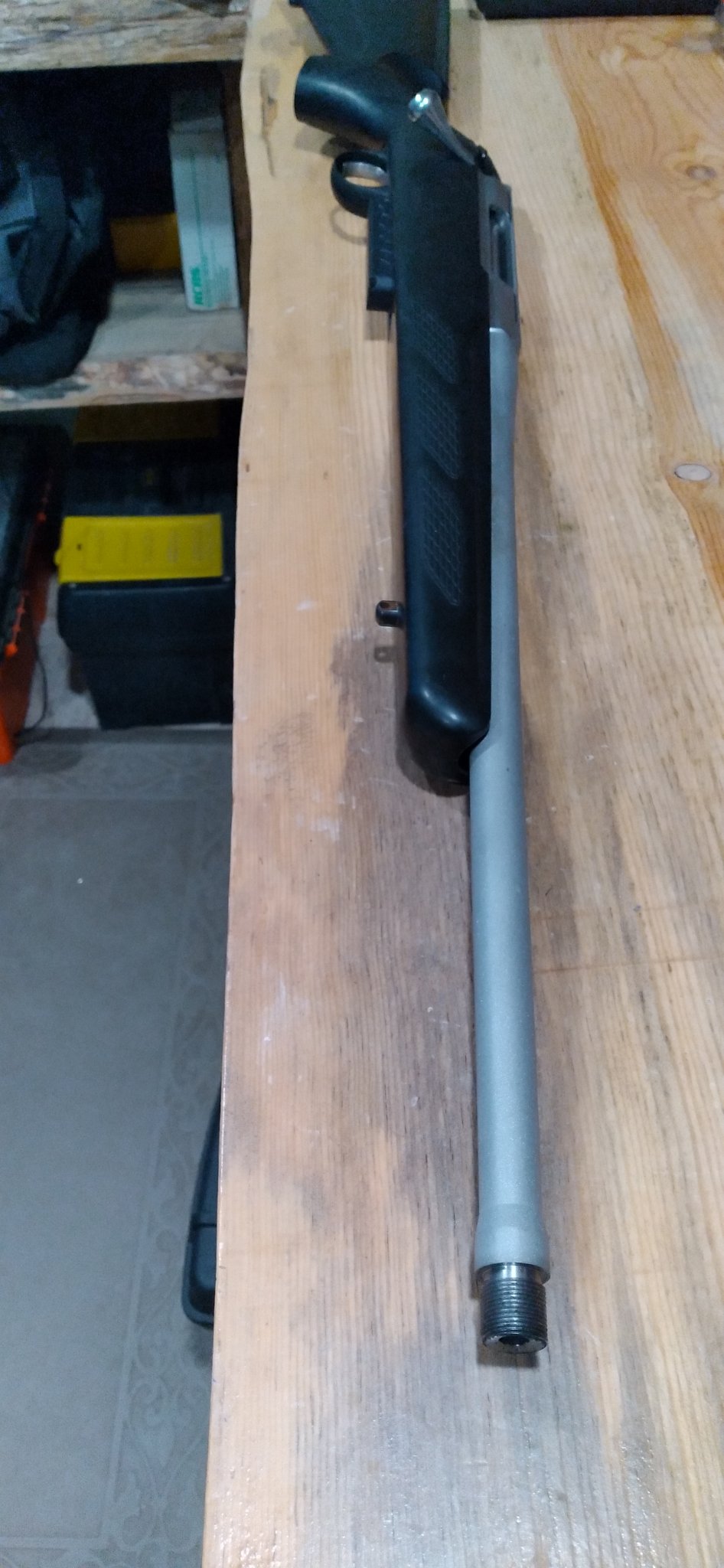

I've gone back to steel barrels and lighter contours flared up at the end to .730
Here's an 18" 7mm tikka prefit that weighs 2lbs.
It's shooting silly good out to 1340 yards
