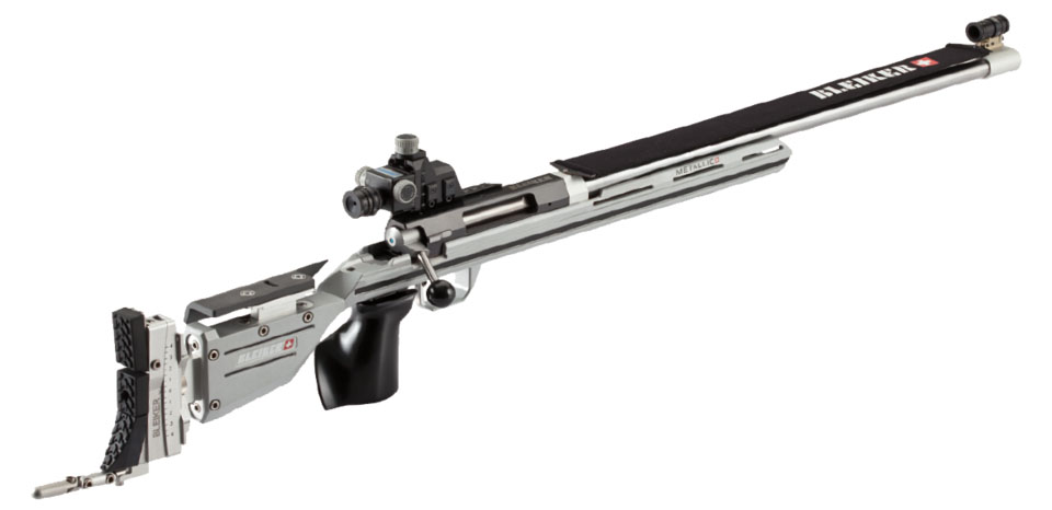

    Yea, they look like this.....and smell like $10,000

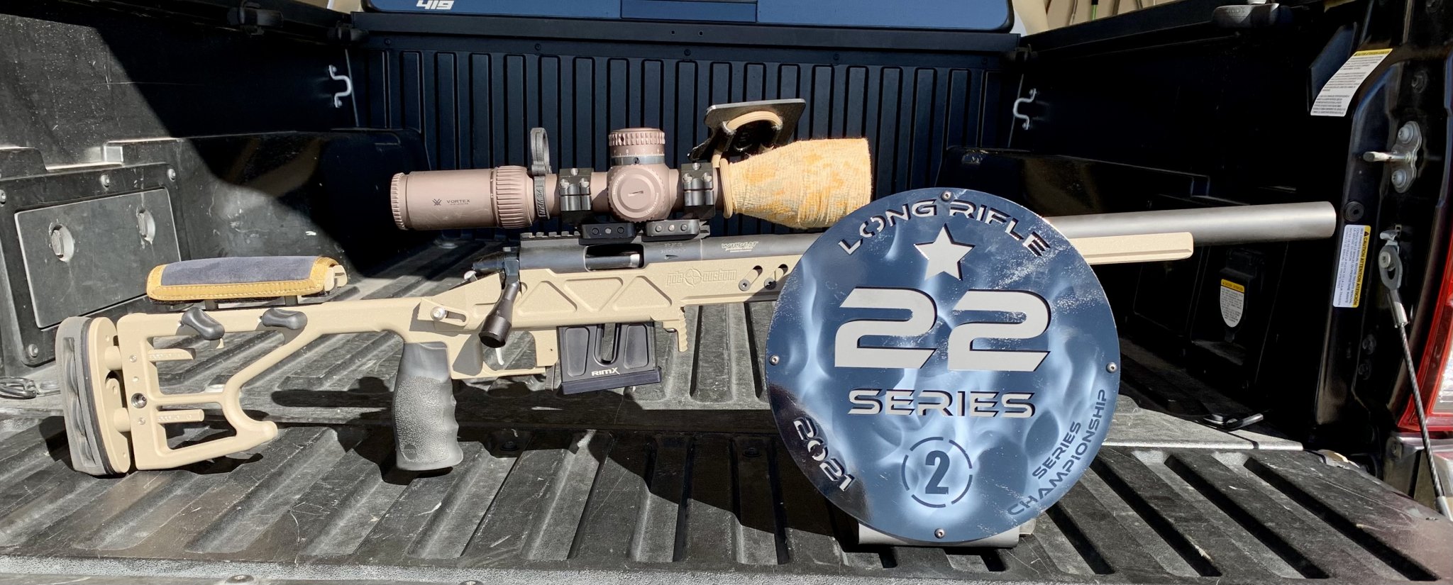

    This is a Green Mountain 1.2” straight 22” on my RimX. It’s the second Green Mountain I’ve had on it. The first was a 18” with the Eachus chamber and the 22” has a Nevius chamber. My shooting partner has a Green Mountain with a Nevius chamber on his CZ 457. I promise you they won’t give anything up to a Bartlein or Kreiger. Look at the 6x5 thread to see what mine does.
