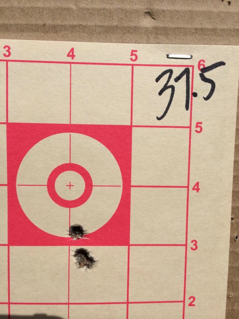

Looks to me it will out shoot the dark knight
Both rifles are excellent shooters. In defense of that posted group, the day I shot the Dark Knight it was pretty windy. The target frame was moving forward and backward in the wind because the ground where the mounting board sits eroded which caused the target frame to pivot due to the extra large gap. The next time I shoot, I won't be in such a rush & over look that small detail. Overall, I have extremely happy with the results of all my bolt action rifles, custom & non custom.
They are both amazing rifles no doubt about it! With that said that's why avg. of all groups really tells the tail not just a few hand picked groups in my opinion and that's why I prefer five shot groups. I've had a lot of three shot groups that grouped very well but not be repeatable or consistent.

A short bit of range work & chronograph today... Reasons like this make me understand the cost of a premium barrel & appreciate a great smith. Extreme spread over 100 fps on 10 shots.. See if you can guess which 3 shots were 100fps more than the other 7.. On the other hand, that 7 shot group measures .404" CTC.
Bob, if you want to do better w that rifle you need to do 2 things,
1st get rid of the match kings and go w something like barts 52 or a Berger the jacket on the matchking is your first killer
2nd when you do load development do 5 shot groups, as you have seen your results w 3 shot groups will not corilate w consistent precision.
Your results have nothing to do with the barrel or the smith, the variables have not been throughly worked through.
I'm not trying to be an internet smart ass but I have been where you are and had to shoot hundereds of rounds to figure out what I just told you

I second the 5 shot groups lets you know a little more for an avg.
Here is my question.. How will shooting 5 shots during load work up resolve a getting a shitty group from a shitty factory barreled action? It is what it is.. A PIG! I failed to mention that the above posted 10 shot group was in fact (2) FIVE round mag dumps. Which, with the results it provided, made me pretty darn happy.. I wasn't shooting for a group, I was more or interested in speed. What one needs to realize, this is alot of powder being burned in that little bore that quickly.
My comment on the about understanding the cost of a premium barrel and appreciating a good smith is chalked up to the numbers this barrel produced. I realize there are many factors that can bring the SD & ES down, (ie. powder, primers, 1x fired brass vs. new brass, copper fouling) but I am not going to invest the time and effort into chasing the "magic" load that will put 5 shots in one hole when this rifle will put 3 shots in the high .1's & 10 shots in 1" with 7 shots impacting in a .4" group. After all, this is just a beater rifle, something to poke at ground hogs with.
This thread was created just to provide some insight as to what can be done for a few dollars to a factory Winchester Model 70. I am extremely happy & proud to have accomplished this project & once again, I enjoy shooting this rifle. It will no longer be locked away in the back of the safe, untouched for decades. I hope this thread provided some inspiration to members of SH as many of the projects I have viewed here inspired me. As stated in the title, it was all about just putting "Lipstick on a pig!"
