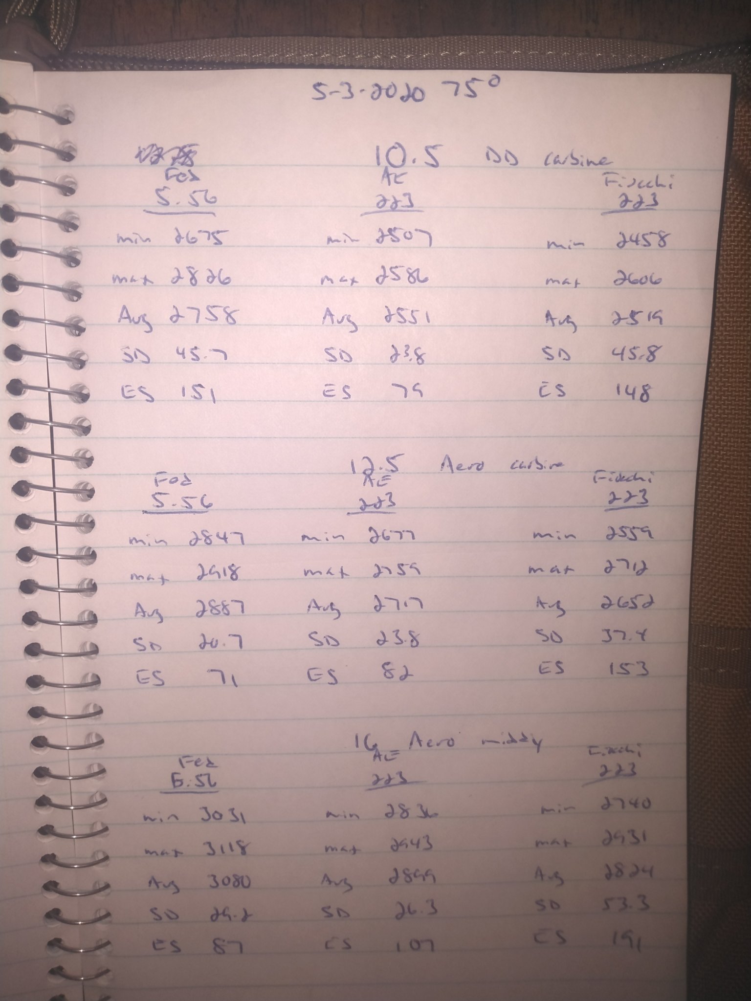

heres some testing i did as another data point. i also did a triarc 12.5 but can't find the data. ill look around.
