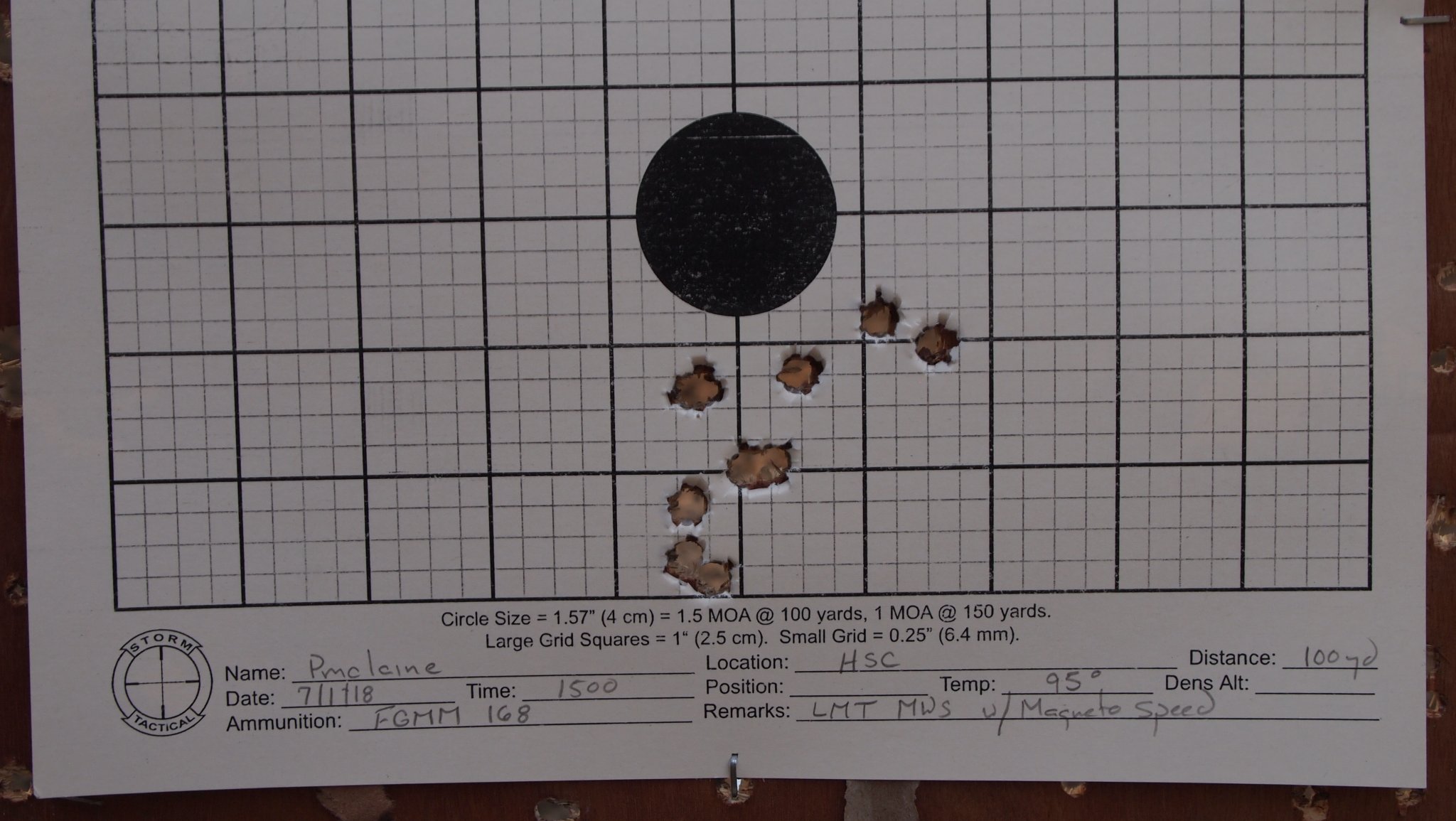

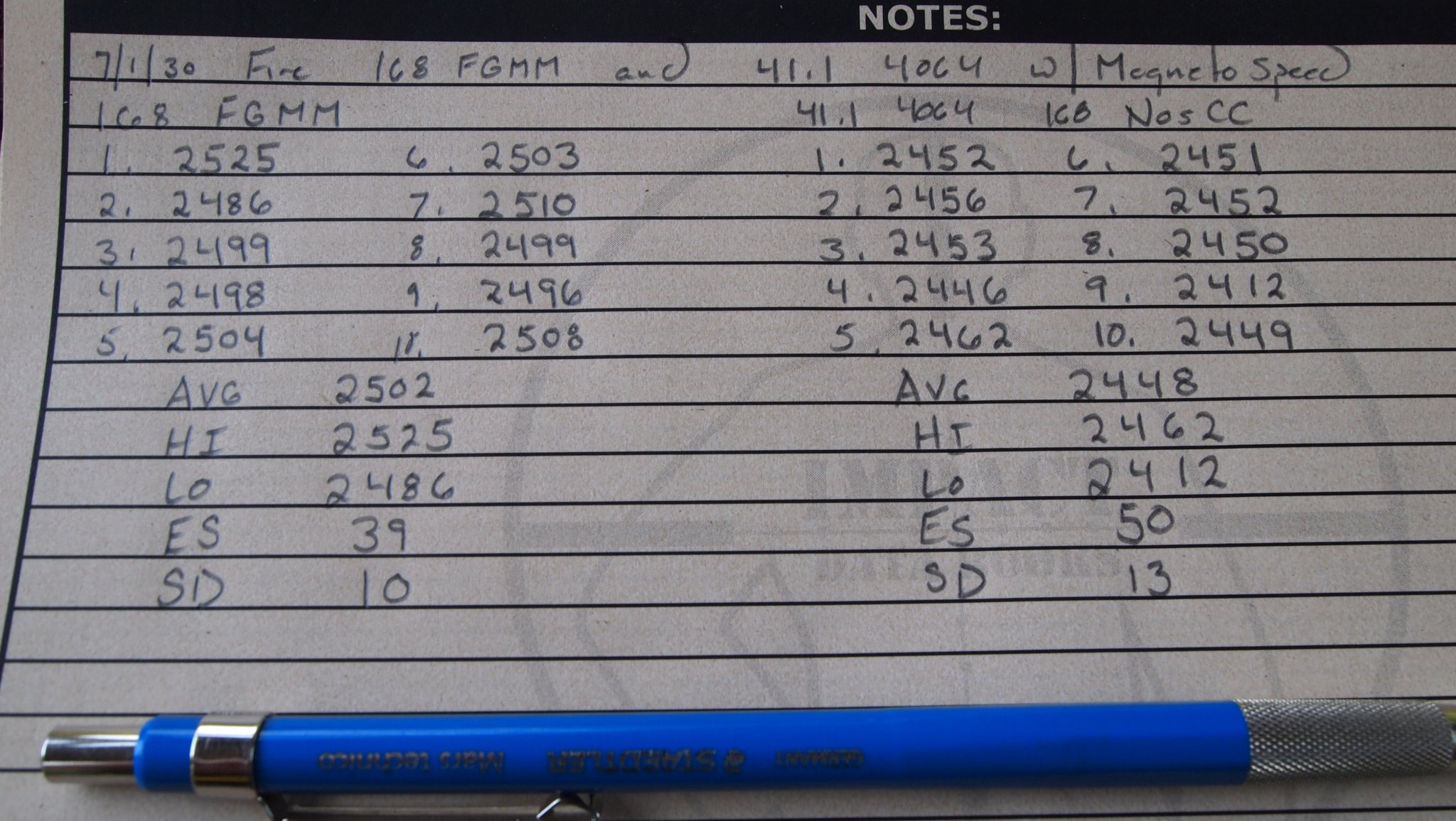

    This is a baseline shoot I made using 168 FGMM and my 41.1 reloads....
    Results on paper....

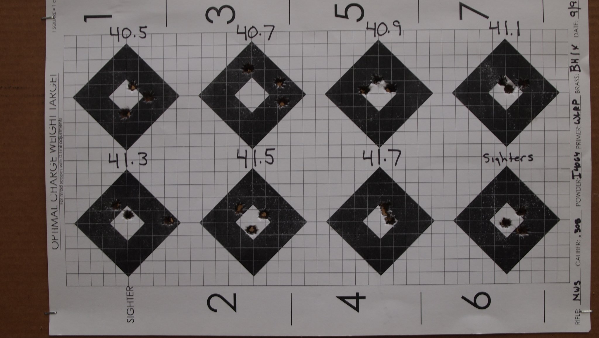

    Yesterday I shot a few loads in +/- .2 grain increments using 41.1 as my starting point. Results on paper....
    Im thinking 41.1 actually looks pretty good as the next targets .2 lower and .2 higher show a similar point of impact (disregard the pulled right on 42.3).

    B. Based on the Magneto readings I think I might find happiness up around 2550. My current 2448 readings seem a bit slow.

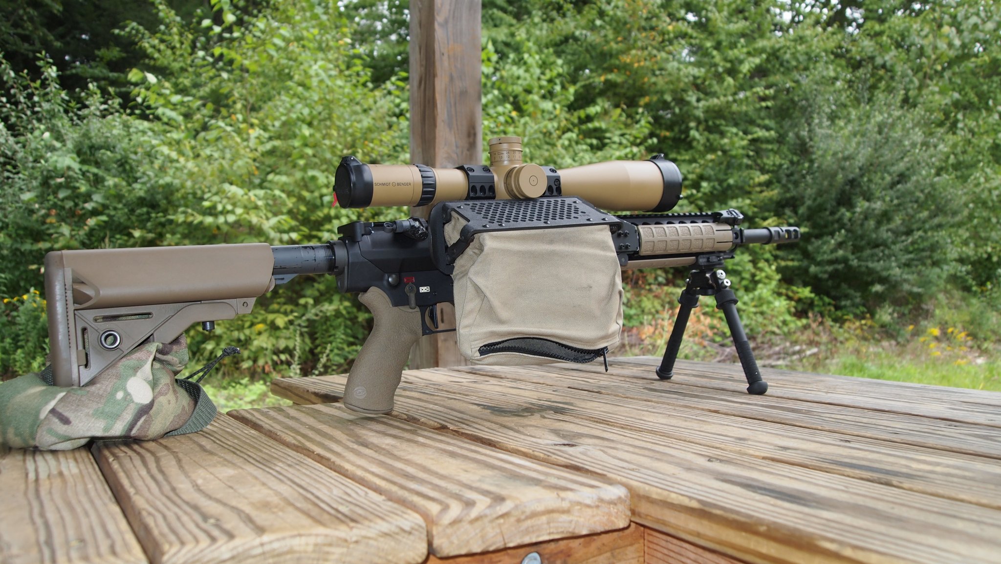

    The rifle....

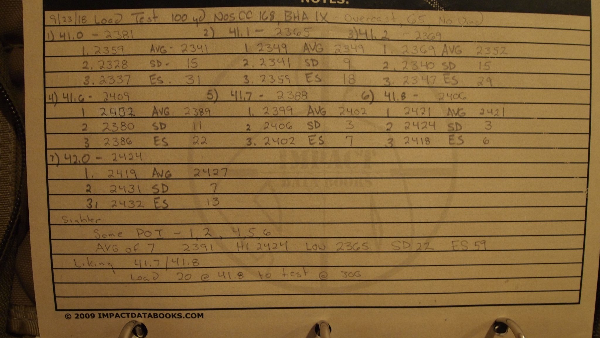

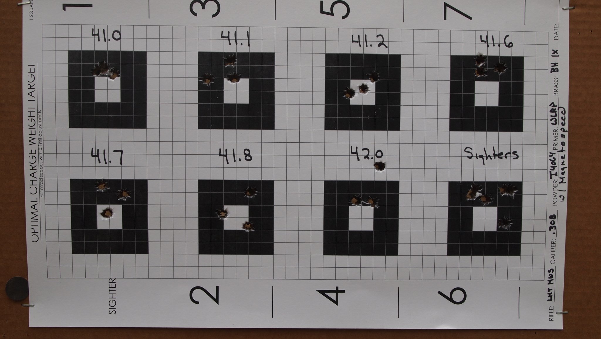

    Made it to the range to test around the 41.1 load of IMR 4064 under a 168 Nosler CC with WLRP in Black Hills 1X brass...
    Target Board....
    Notes.......
    Im thinking my loads are pretty anemic.
    Im going to try 41.7 at 300 and Ill extrapolate what will get me near abouts 2490-2510 FPS and give that a try.....

    Just picked up the magnetospeed a month or so ago so this session of load development actually has some data to work with.
    My old rounds were okay accurate but I see that I can juice them some and maybe get them on target with less atmospheric interference or shooter dropping hold due to extended barrel time.
