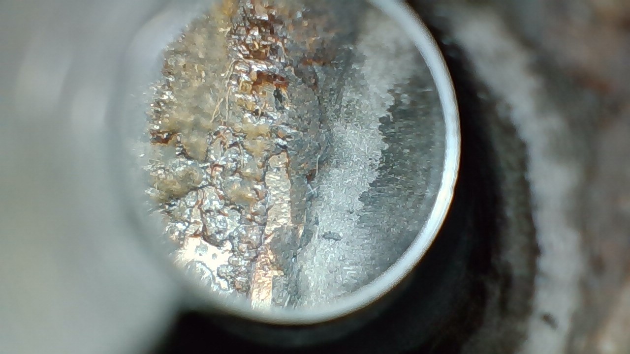

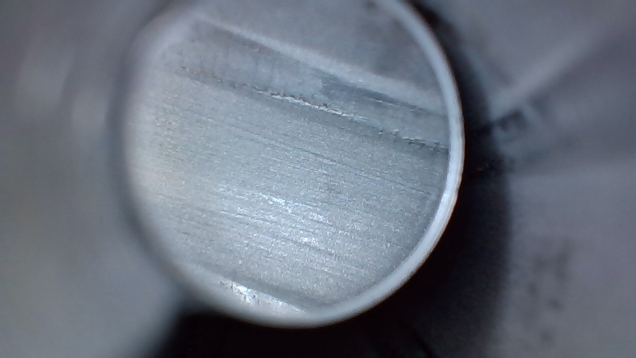

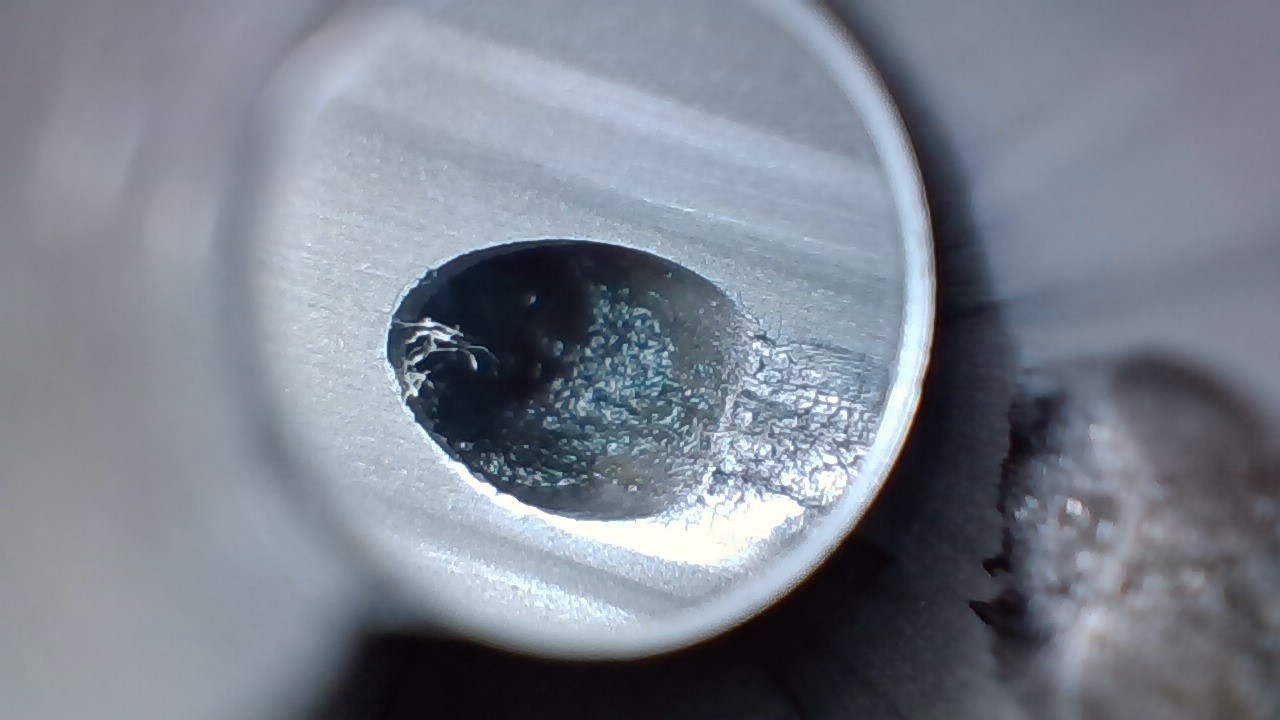

    Edit:
    I've added photos of what it looks like now and discovered this weird buildup in the chamber (neck area) The photos are AFTER about 150 patches or so. I should warn ppl, be careful with CLR in semi-autos because even though my barrel is SS, the extension is phosphated steel or something, and the CLR must have creeped all over it, down the extension, into the barrel mating area and retention screws, seizing the entire barrel assembly tight. I couldn't even remove one of the screws but was able to coax it out with a brass punch. Eventually the barrel broke free and I immediately cleaned off any rust that had already formed, doused everything in alcohol followed by Kroil. That weird buildup must be fumes or rust from the extension that must have migrated down or something. I can't explain it. I cleaned the area out and scrubbed it with Boretech eliminator and the "buildup" came out but the area is stained black. Super weird. Anyhow, the rest of the barrel has this "fuzzy" texture as if it's been powdercoated in carbon or something. Patches are coming out gray-ish, but still not clean. I've never seen anything like this. There is no exposed metal in the bore at all. I've also never shot moly coated bullets if that's what it would look like, but I did shoot a box of Winchester silvertip last year out of it (black coated bullets, not sure if moly)
    Has anyone see something like this? Shoots fine, but if I'm devoting time to cleaning (4 days now off and on) I want a bright bore so I can start over. I know ppl will say to not worry about it, just shoot it. I don't want to leave this shit in my barrel when I put it in the safe for another year.
