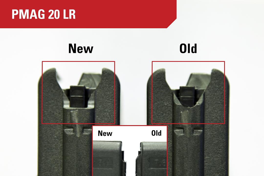

    Magpul redesigned their PMAG20LR when it was discovered some early MWS gun's bolt can hang up on the lip of the magazine bolt catch causing lockback. I'll post a photo when I get home.
    Until this was announced and Mapul sent me replacement mag bodies I was using Knights Mfg mags with my MWS.
    I have a MWS also that I shoot suppressed with a YHM can. I am loading 175 SMKs in front of 44 gr. Varget or 43.5 of RL-15. I am using the Slash x-heavy buffer and spring also. I experienced the same issue and determined the cause to be the older PMAG that I was using. I had already modified the rear of the mag to prevent it from hitting the bolt catch but had not cut the notch quite deep enough and if I inserted the mag hard the bolt would lock back on every shot while running suppressed. If I gave the inserted mag a little tug afetr it was seated hard the bolt ran normally. I ended up just squaring off the notch on the rear if the mag and that seems to have solved the issue.

    I appreciate all the responses....it could very well be an older pmag ,it seems I have other mags new in wrap I will try.hopefully it is not a gas port issue. I know semi autos can run suppressed I'm gona keep trying.thank you for the responses.

    If it hanging on the mag, you should be able to gently remove the mag, and have the bolt slam home.
    Hogshooter...yes now that I think about it I have to push the bolt release or pull the charging handle back to load each round.it does hang up on the bolt catch.
    Aforementioned mag tweak
