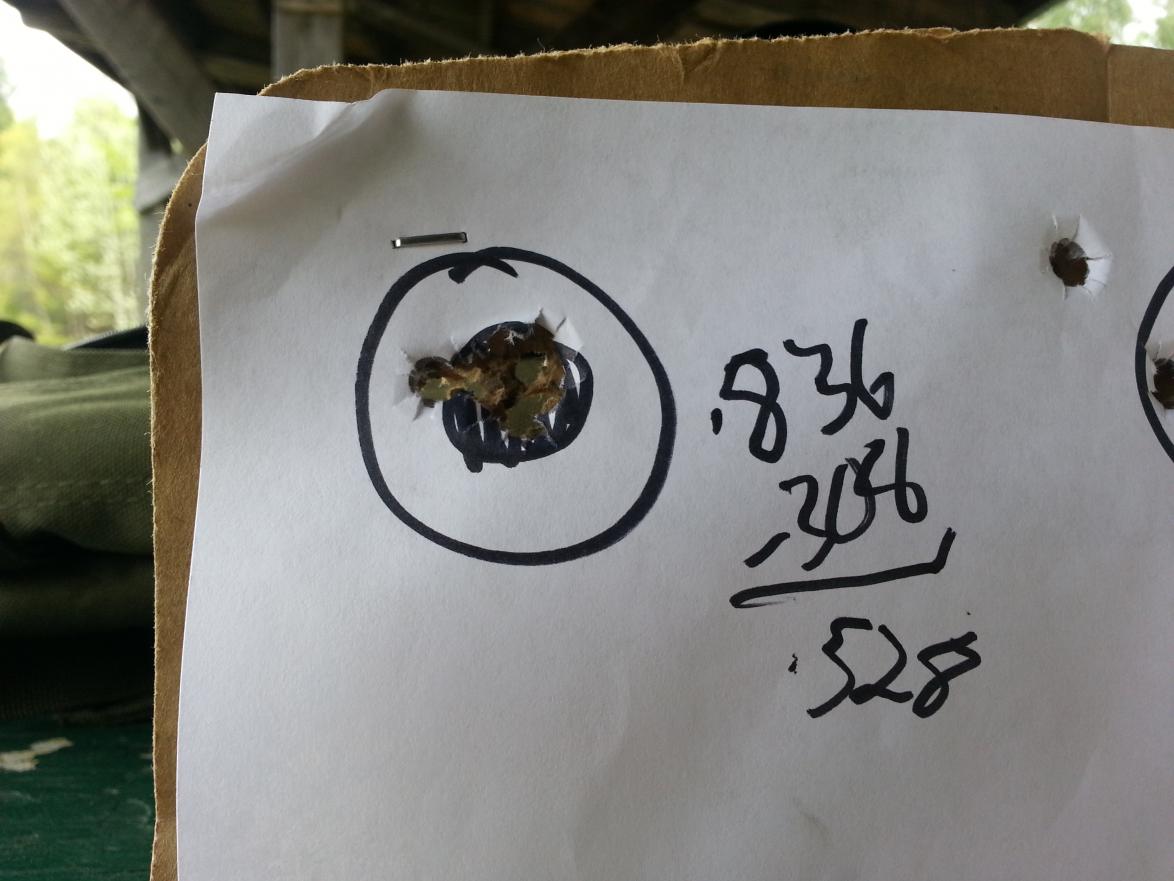

I put it in Shooter and its between .4 and .6 MOA(I re-did it a few times and it was slightly different each time, but largest was .6, smallest .4, depending on EXACTLY where I put the circles). 5 shots at 100. That load, which wasnt even really tuned up for the gun, was a 155 Nosler or something like that, dont really remember. Dont remember powder. Wasnt overly impressed with the round except this one group.
This was another group I shot that day with the same ammo:
I think Shooter put this at just over 1 MOA like 1.1 or something(cant find my saved image files, if I even saved em).

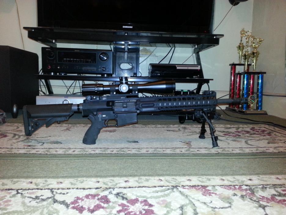

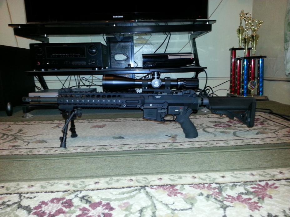

3.) post a pic of your rifle please. Are you using a 1pc scope mount?
4.) there is a definite technique to driving a big caliber semi-auto, but something is way off if you're truly getting 2.5" @ 100yards.
I'll post a photo tomorrow...I just have to figure out how to do it first. I have the same scope mount as you (larue spr 1.5). As for the 2.5 moa, bm11 can vouch for me, he was there.

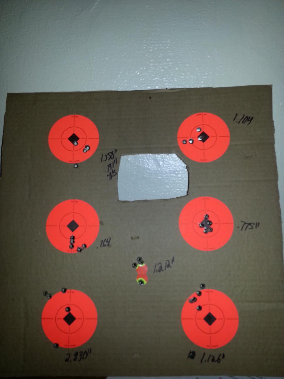

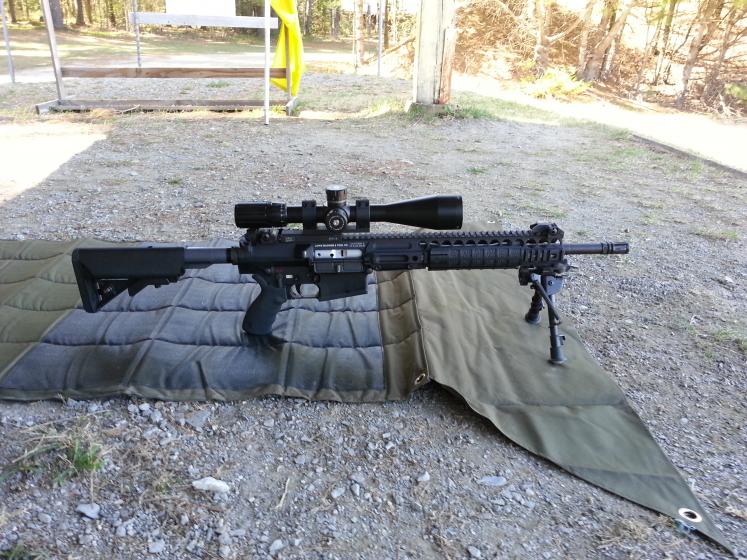

So...this morning I received a 16 inch SS barrel for my MWS. As you all know, I didn't have the best of luck with my 16 inch CL. I installed the barrel in a matter of minutes (love barrel changes with the MWS) and headed to the range with a friend. I put 100 rounds downrange at 100 yards, here are a couple of the groups that I got with the first 100 rounds (man did I pull one of my shots in the bottom left group). I was shooting FGMM 175 gr, the rifle seems to love it and I'm now happier than ever. I really feel that with a bunch of practice and a few hundred more rounds down the tube that this thing is really going to tighten up (not that I mind the current results as they're much better than what I was getting with the CL). I just feel that the rifle is capable of shooting better than my current skill level allows me to.

Thanks! I have a Surefire break on my KAC SR15 and absolutely love it. I had one on my 16 inch CL but am running the SS without one for now. I'm toying with the idea of getting one for the SS but with the way it's shooting I don't really want to mess with anything.

Thanks for getting back to me. I ended up getting a LMT Stainless 16" barrel and couldn't be happier with the rifle now. It doesn't always shoot sub moa but I think that has more to do with me than with the rifle. In the 130 rounds I've put through the new barrel I have seen a decent number of sub moa 5 shot groups which makes more than satisfied. Here's one of the groups I shot yesterday at 100 yards...my personal best with a semi auto.
