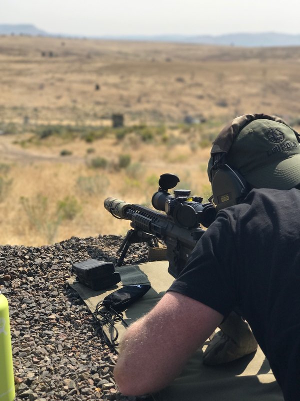

I have a MWS with the 16” SS barrel.
I run a SureFire 762RC on it 100% of the time.
Other than a Geissele Hi Speed DMR trigger it is completely stock.
The gun displays zero symptoms of being overgassed. It runs 100%, cycles smoothly and pitches the brass where it should. It’s reliable as an anvil.
I am left handed and therefore more sensitive to overgassed rifles than the other 90% of the population. I get almost no gas to the face and zero crud on my glasses. The combination of the MWS and the SureFire is a pleasure to shoot.
I read posts about the MWS being overgassed and I honestly don’t know where it comes from. You have to remember that this is the exact gun issued to the Brits, and New Zealand, and, I believe a few are in the hands of Canadian and Aussie troops as well.
I have seen pics of SAS snipers with MWS’s equipped with SureFire suppressors as well. Pretty sure they haven’t switched out buffers, springs or gas blocks on their rifles.
I believe that most of the issues arise from people using cans that exhibit excessive back pressure, a side effect of the mistake of chasing decibels in a center fire rifle can.
Based on my limited experience (sample size of one) if you go with the SureFire, you will be fine. Any other can I can not say for sure.
