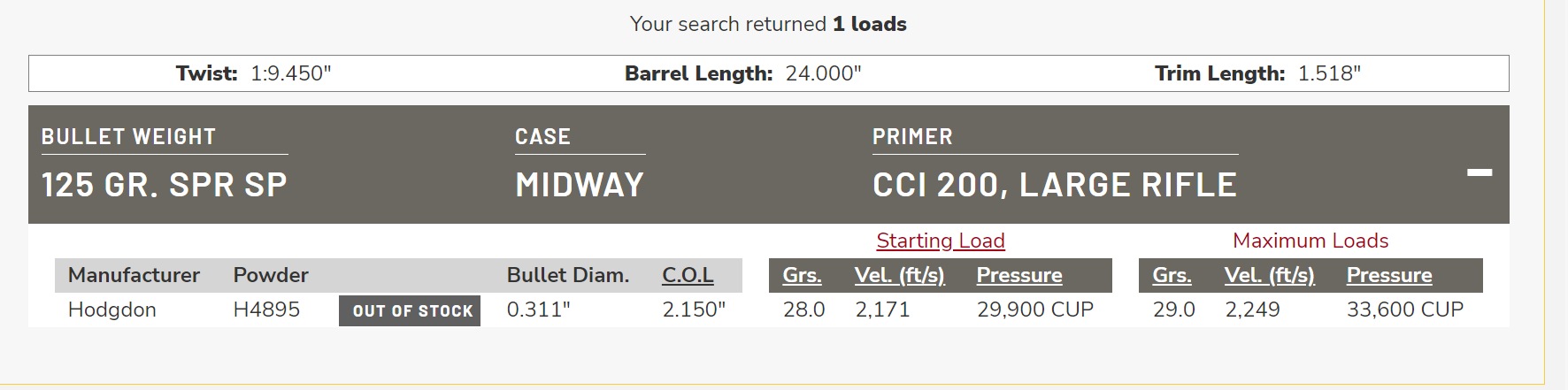

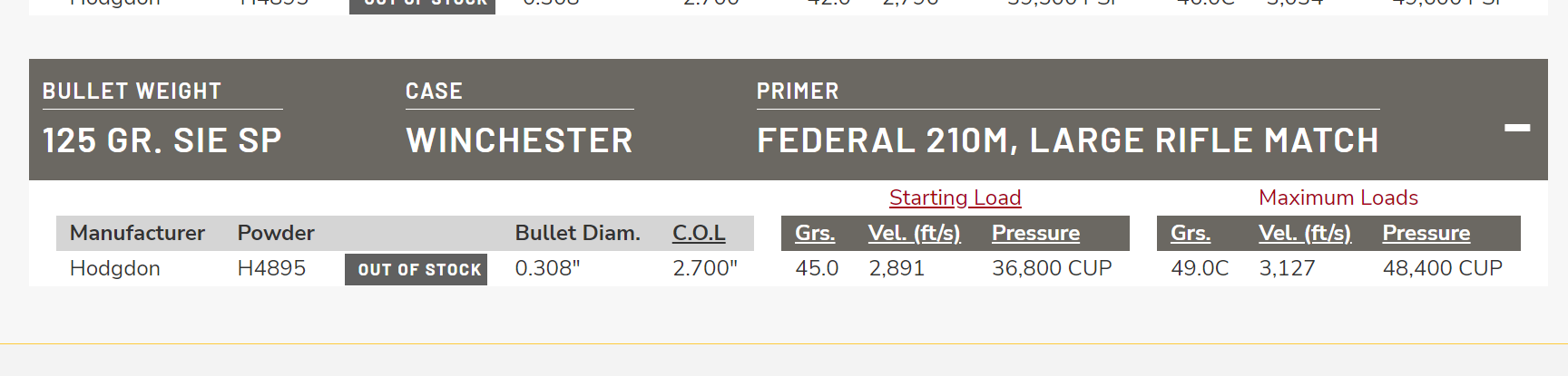

You could use the Hodgdon 60 percent formula for H4895 with a 125 grain bullet . You may be able to load down to 7.62x 39mm levels and still cycle the bolt .
Reactions: acrags
Here is the 7.62 x 39mm load for the same bullet . The max load is listed as almost the same as the .308 winchester max load reduced to 60 percent .

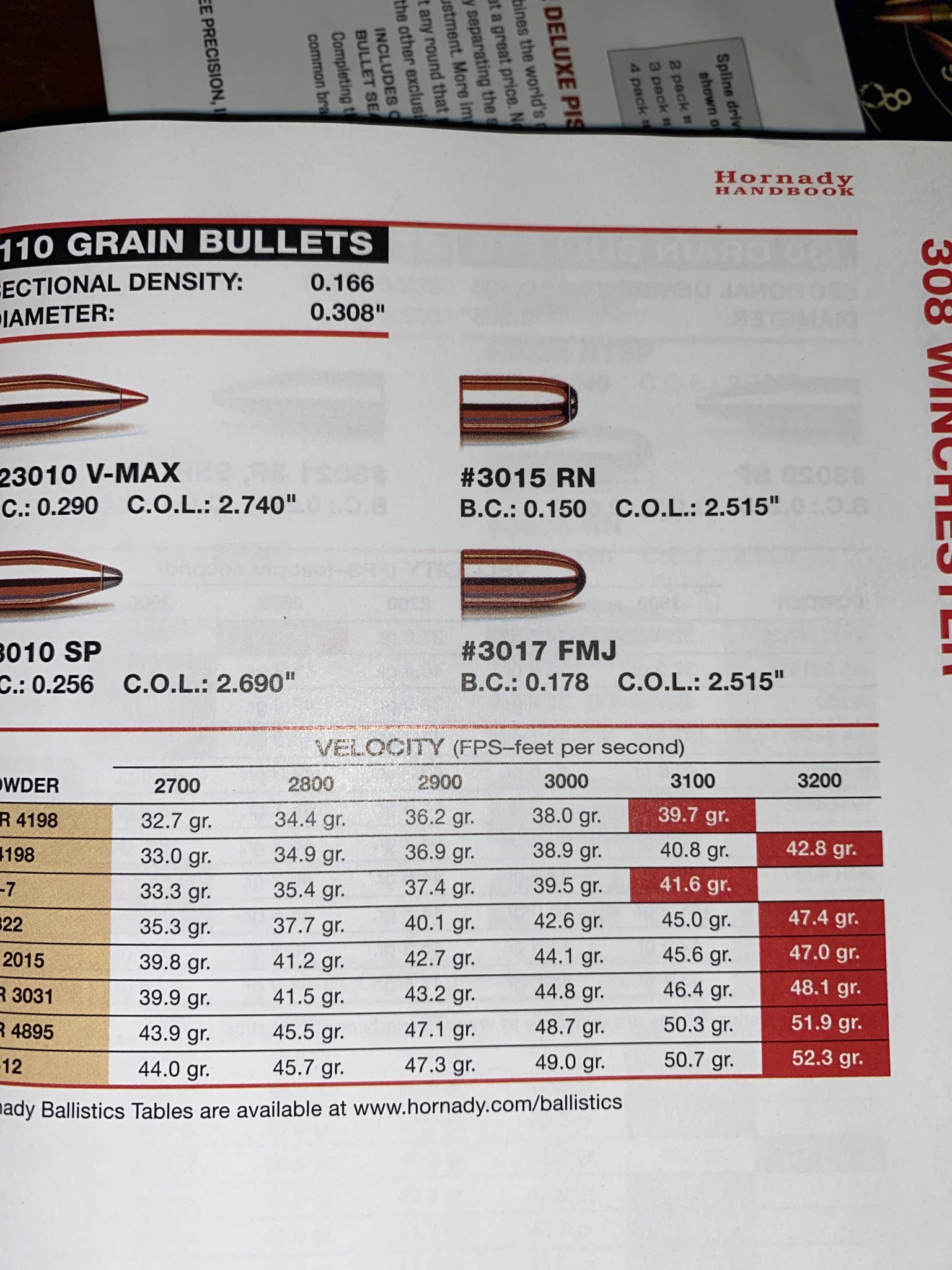

I run a 110 with IMR 4198
I have run as low as 36 grains and it cycled just fine in a few different pieces. 36 grain with a short barrel and a 110 projectile will be very close in energy to a 762x39
I have a ton of Vmax loaded at 39.4. Its a pleasure to shoot, much more controlled that 150+ grainers. Much flatter shooting too especially inside 300 yards. Specifically have this for a semi auto with a red dot to move and shoot.
