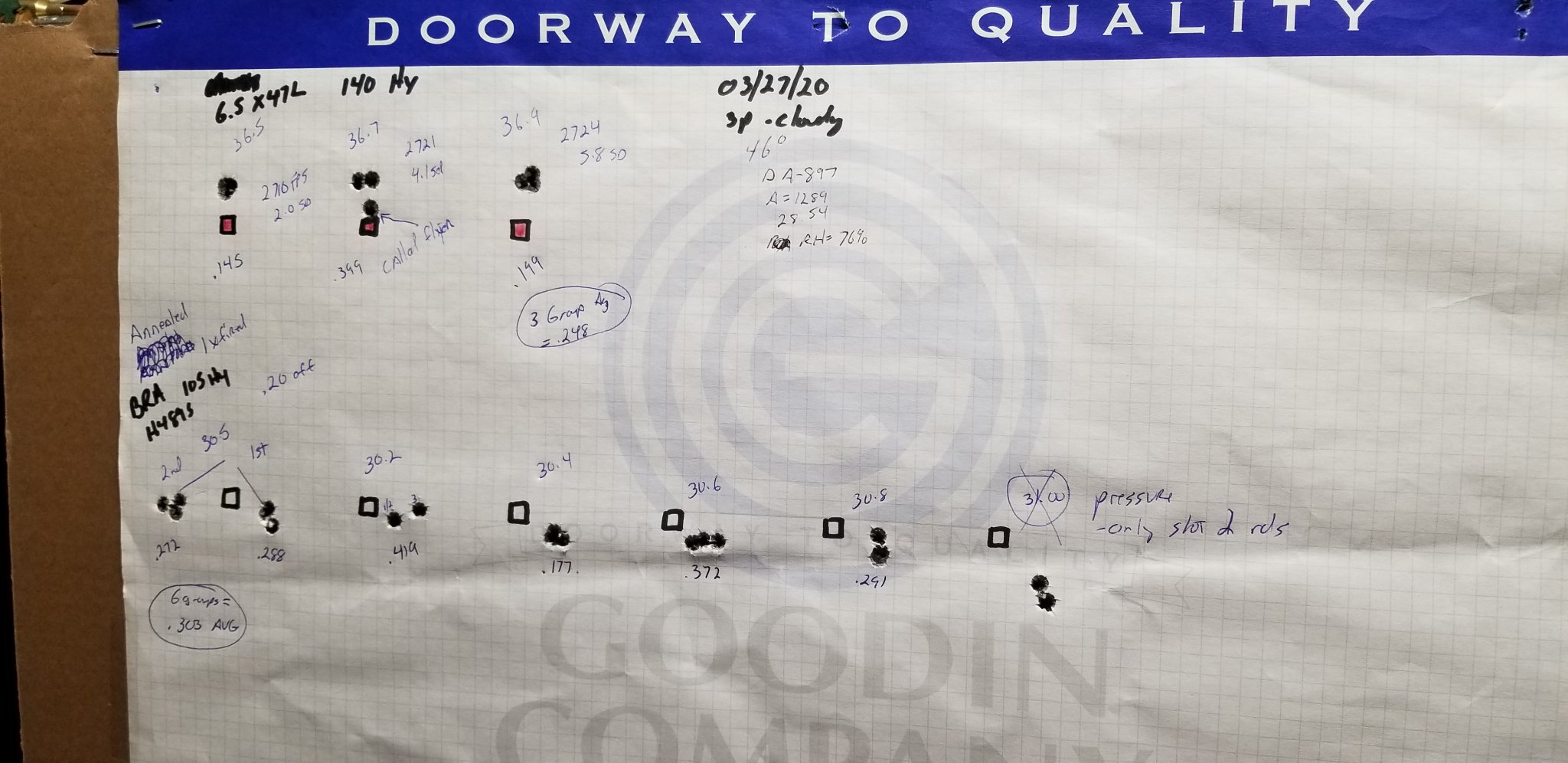

The BRA fire forming loads seem to shoot extremely good IMO At 30.0 Gr of H4895 and a 105 hy, It runs .3 so that is all good. The actual BRA loads where shot using H4895 and 105 hybrids and loaded at 30.2/30.4/30.5(a suggested sweet spot for the BRA) 30.6/30.8 and 31.0(quit shooting these as bolt lift was noticeably heavy...pressure)
The 6.5x47 and 140 hybrids were shot on twice fired brass and at 36.5, 36.7 and 36.9 and shot .145, .399 and .199 respectively. seemed slow tho. All were shot using varget and the speeds were at 2710(36.5), 2721(36.7) and 2724(36.9).
For reference
I run my fire-forming loads a lot lower at 28.6 - I'm one of those guys who wants to ease in the brass during this process.
I'm running mine at 30.7, and will drop to 30.6 during warmer months. My bolt lift hit at 30.8.

For reference
Base on this, I'd do some more concentrated testing around 30.4, .5, .6, and .7.
On my BRA, my sweet spot with 4895 is very narrow. 30.7 shoots lights out - 30.6 just okay. As a matter of fact, I missed the node by doing groups and ladder testing at .2 gr increments. 30.6 shot okay, 30.8 was sticky bolt, and I never shot 30.7.
Then, I decided to play around 30.6 (up and down by .1, and retesting stickiness at 30.8). I discovered the sweet spot at 30.7, validated the 30.8 sticky, revalidated 30.7 with 20-round strings.
I'm thinking about playing with the 109s to see if I can find a wider node with those - just not sure I want to do that right now.

perhaps I am running my ff load to hot???
IMO there is no reason to run them hot. I use them as practice shots to work on trigger management. Who cares if they're fractions of an inch low at 100.
I am actually following your path. I am targeting that 30.4-30.7 window and am going to test in .1 increments both at 100 and with 3 round groups at 600 to be certain of vertical. then play with seating depth and fine tune....thanks again to all for the insight...
I'd add in one more validation step: testing with 20ish rounds over a chrono at the "final" charge weight. You can do this at the same time you're doing the seating depth.
