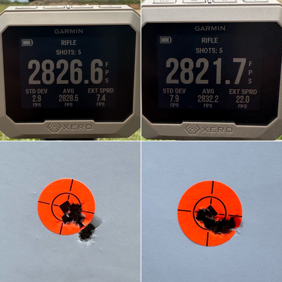

Here is small example.
Left ammo: 6gt Alpha brass. Pulled straight out the box. Primed, chamfer, powder, seat 109 Berger.
Right ammo: once fired alpha from above. Case shoulder moved forward .005”. Bumped .001 in area 419 die with .241 mandrel. Prime, chamfer, powder, seat.
So, for 6gt PRS ammo, I don’t care. This load isn’t even “worked up” for the barrel. Just loaded to speed I want and .030 off lands in fresh chamber.
Other cartridges and/or different uses may vary.
