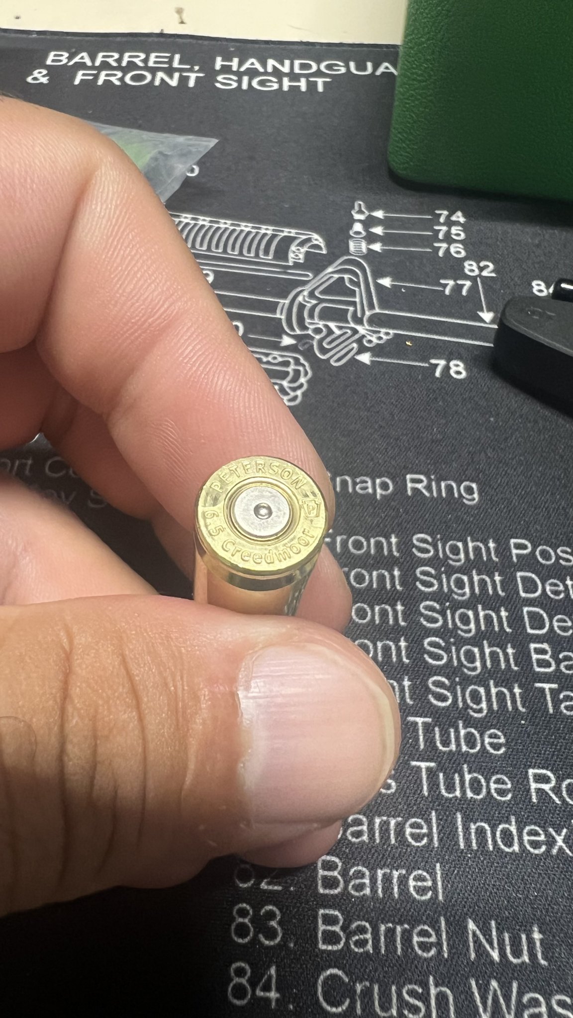

Could you post a picture of the ejector mark you're seeing?

It is very faint mark but I will try to post it when I get home

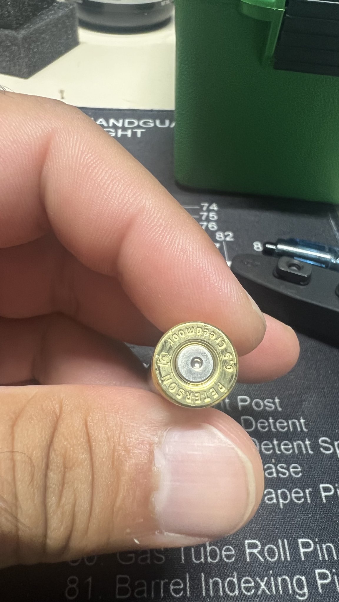

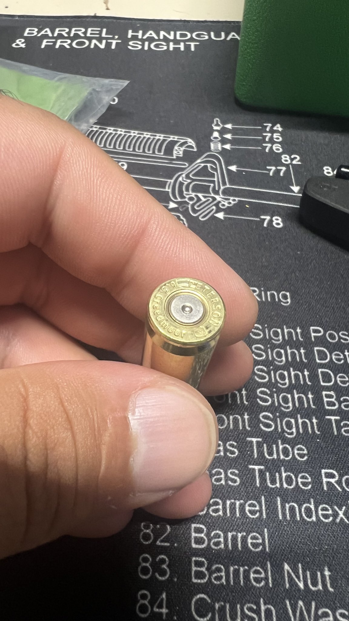

Here is the picture

The picture of the primer looks fine. There is a slight swipe on the case head that I wouldn't worry about yet based on bolt handle lift feels okay and bullet velocity is on the low side.
