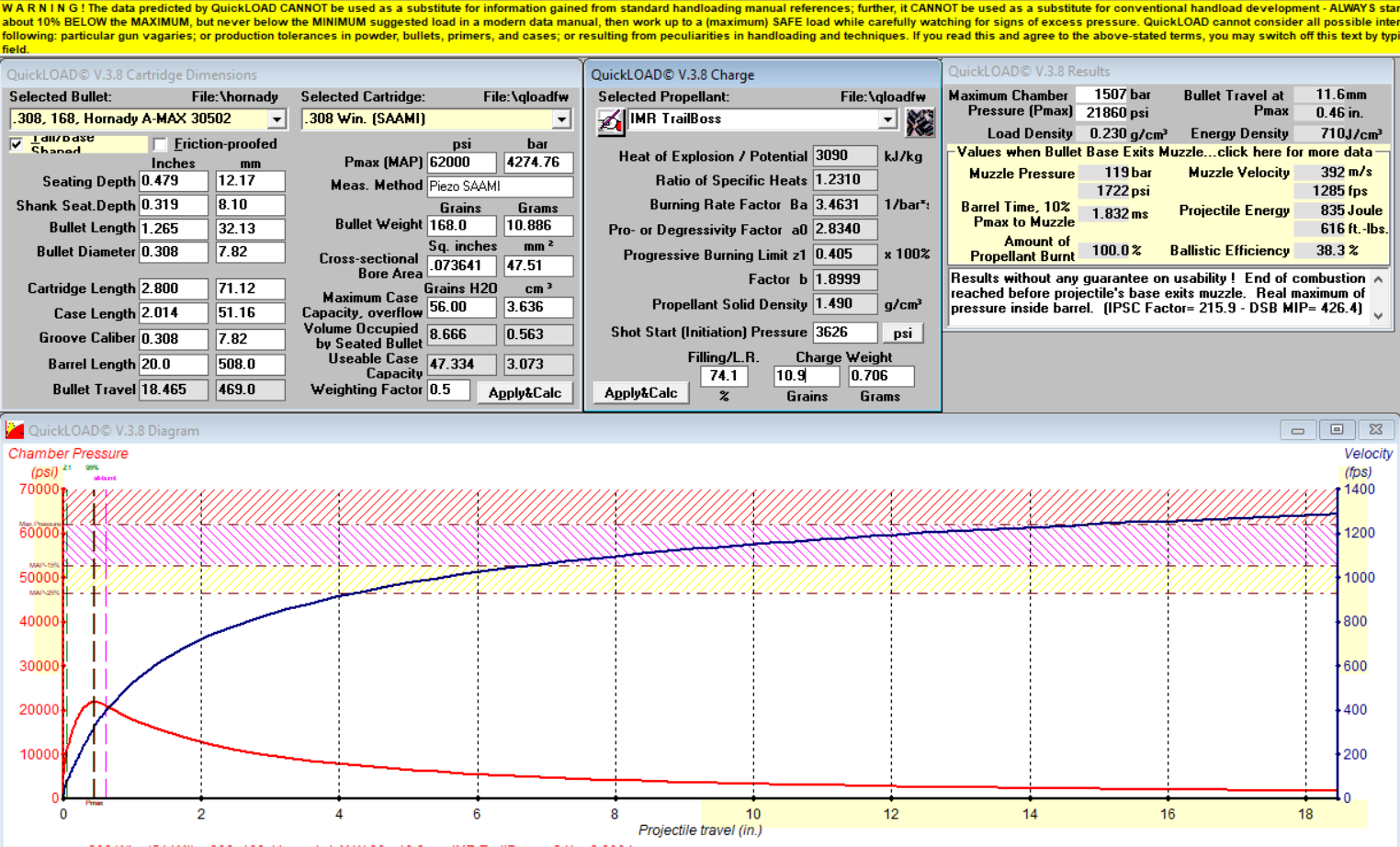

Load for 308 subsonic Trail Boss 168gr A-Max
I'm at 10.5gr with the 200s, so 10.9gr sounds fine. Let's see what QL suggests:
Looks a tad bit on the fast side. The problem is that you're already close to the danger zone of <70% fill rate, so be careful if you back it down a bit. Playing with the numbers, your barrel length is hurting about as much as the 168. If it were closer to 200gr bullet with a 16" barrel...but that's obviously not the parameters you're working with...
