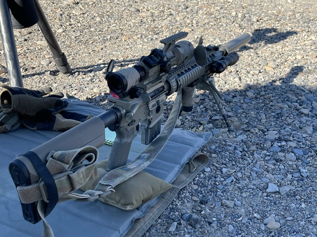

    My Mk12 load is 77g smk over 25g of AA2520 in a lake city case lit by a Remington 7-1/2 primer.
    It’s very consistent to 600m. Here’s a couple groups:
    500m
    600m
    Mk12 Mod 1

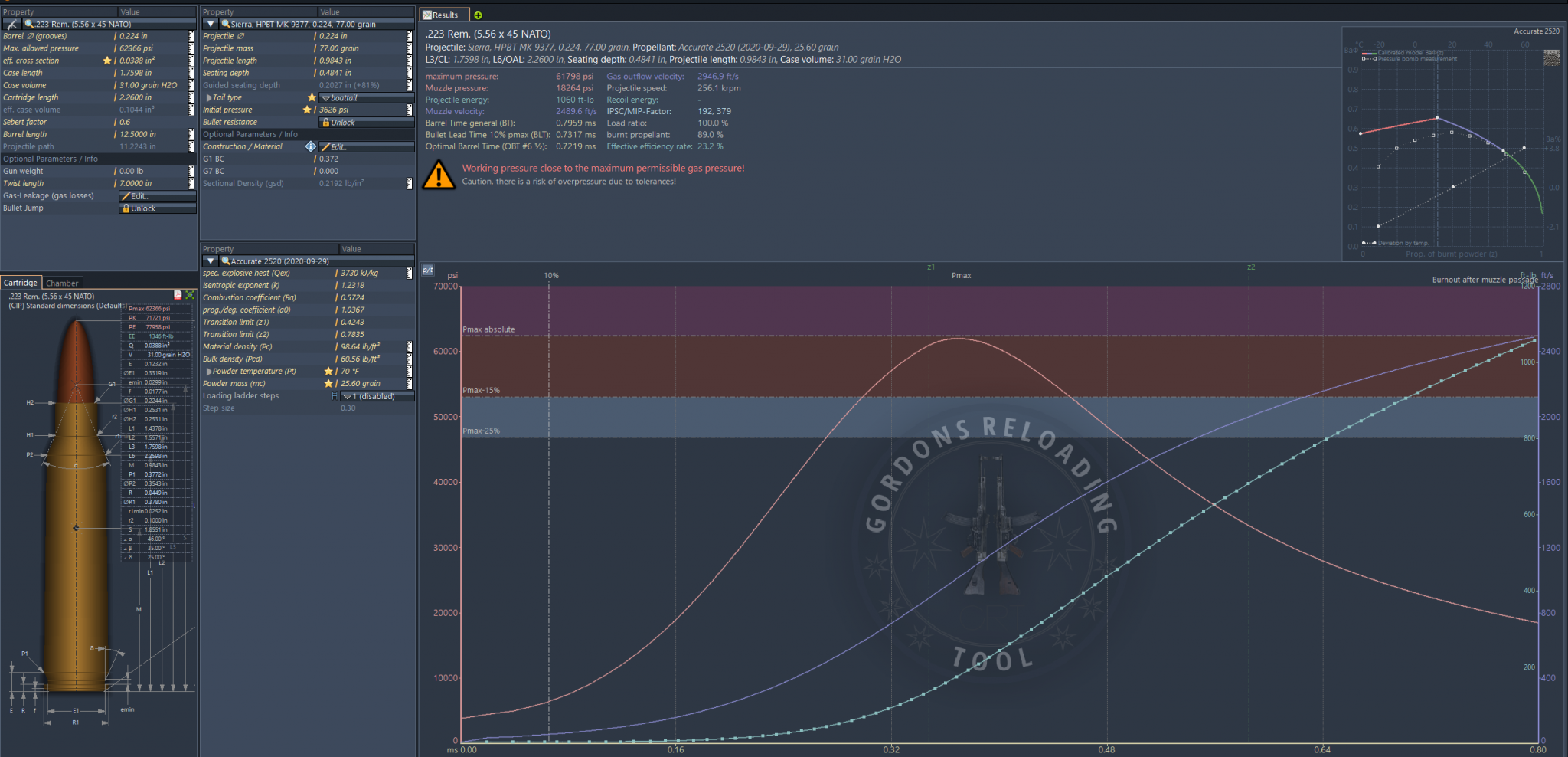

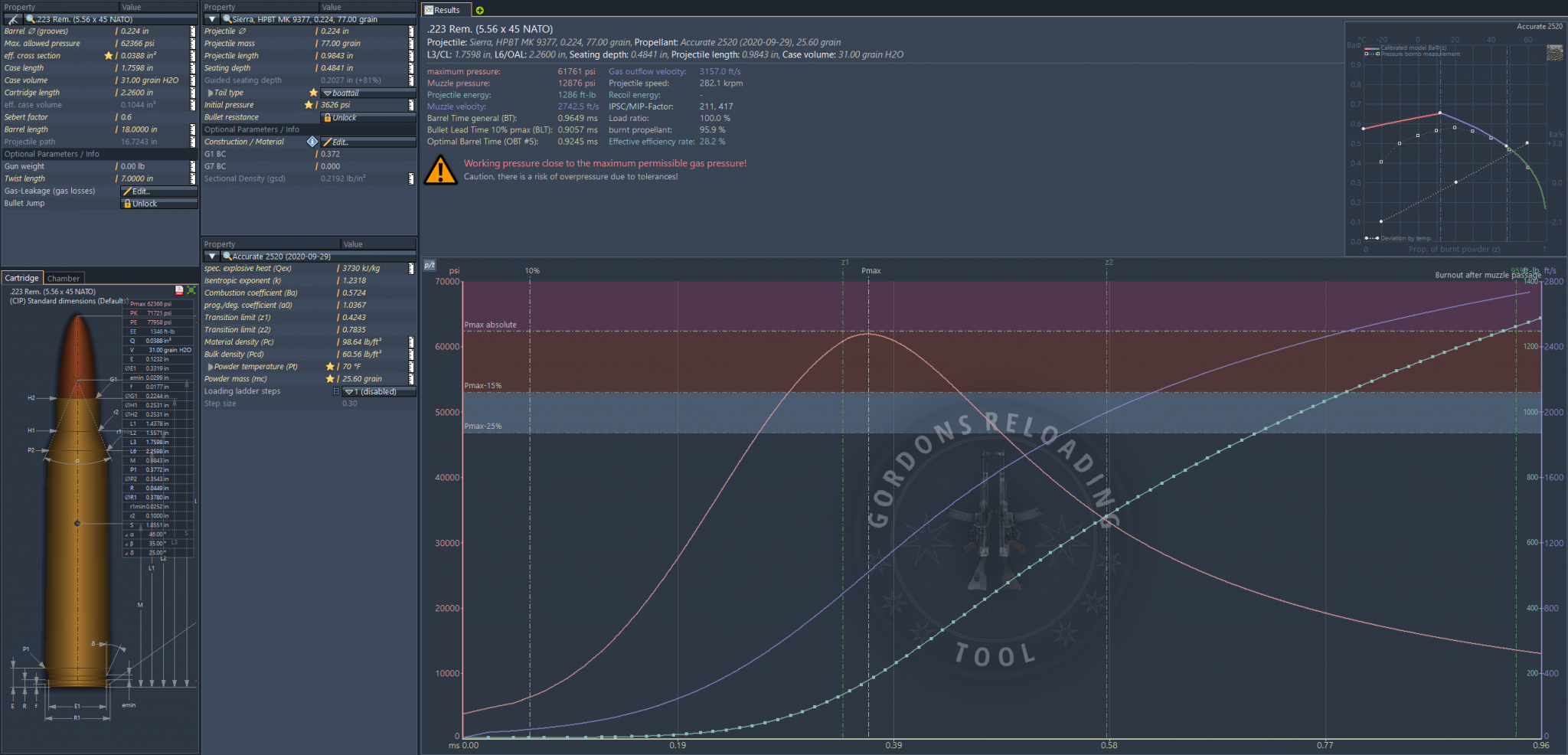

    2600+ is not a realistic number from a 12.5" barrel. Here is a Gordons reloading tool max load of Acccurate 2520 at max load from a 18" barrel, and it gives a similar velocity to the video you linked above (2743 fps). If not familiar with GRT, it is similar to quickload.
    Now cut it down to a 12.5" barrel. it is saying 2490 FPS. I am not saying this model is exactly what you will get, but I would not be aiming for 2600+ thinking it was safe. You might have a fast barrel that can go higher than 2500 safely, but it would be the exception not the norm. IMR8208xbr does give a bit higher velocity at 2510.
