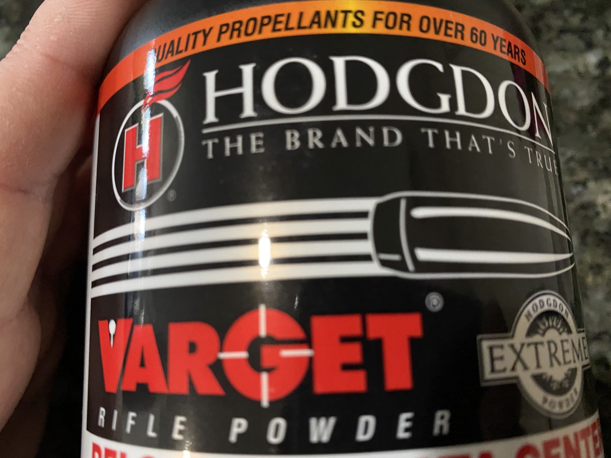

I am also doing a long range work up using Hornady 178gr ELD March Bullets. I’ve been delayed as I ran out of Varget. Found this bad boy two miles from my house on Sat? Needless to say I was ecstatic
