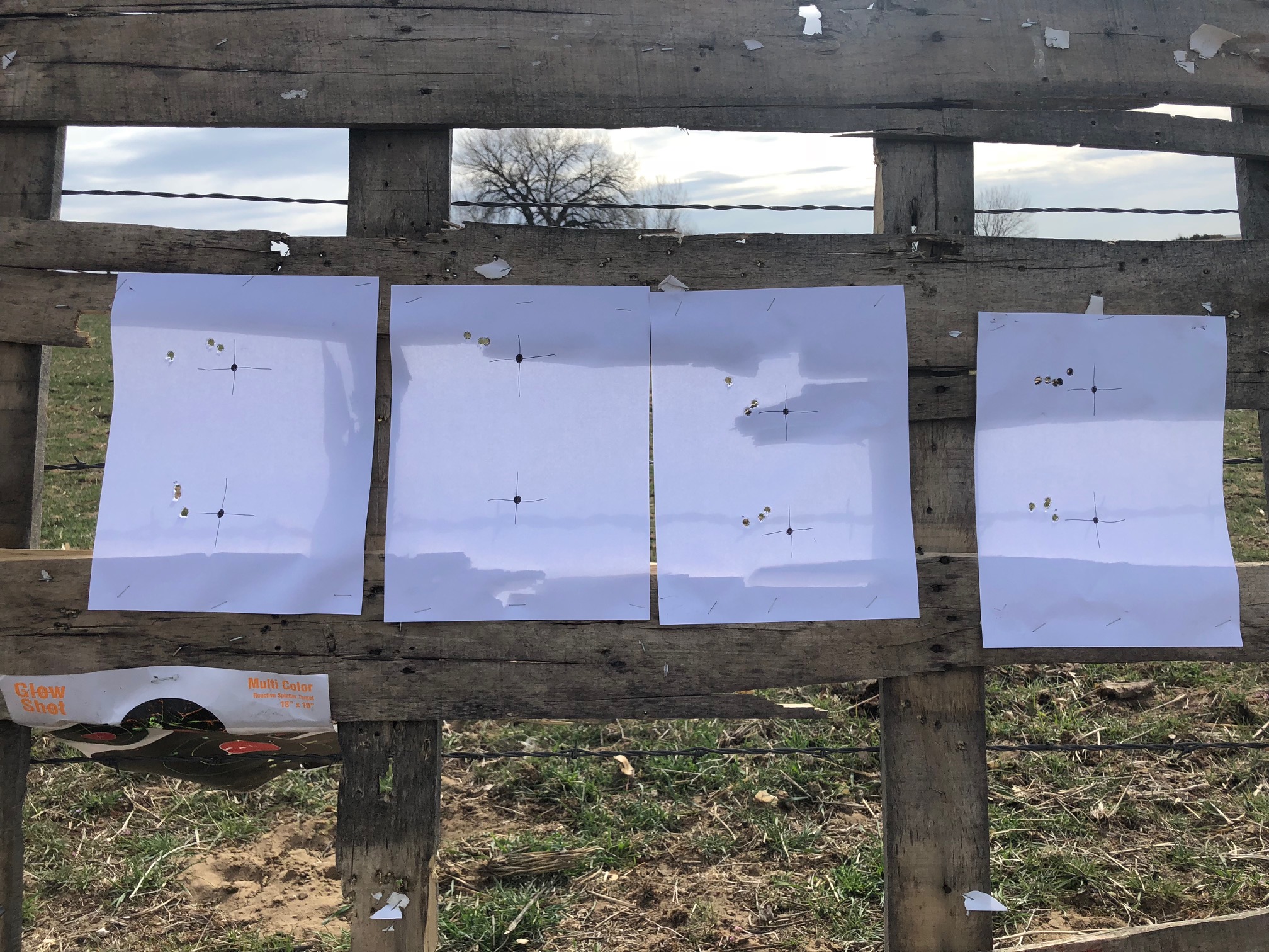

    Pic of target showing jumping at 225 yards. Bullet shoots for sure. left target is 040 jump. only did 1-3 shot group at 050 jump
    third target is 060 jump
    last target has 120 on top and 130 on bottom. I pulled the last shot on the top right group
    Didn't chrono the ammo but I knew window of velocity would be in the 3100 range. I picked 050 for jump. The SD was 3.3 for the first 6 shots out of the rifle. Velocity was 3120.
