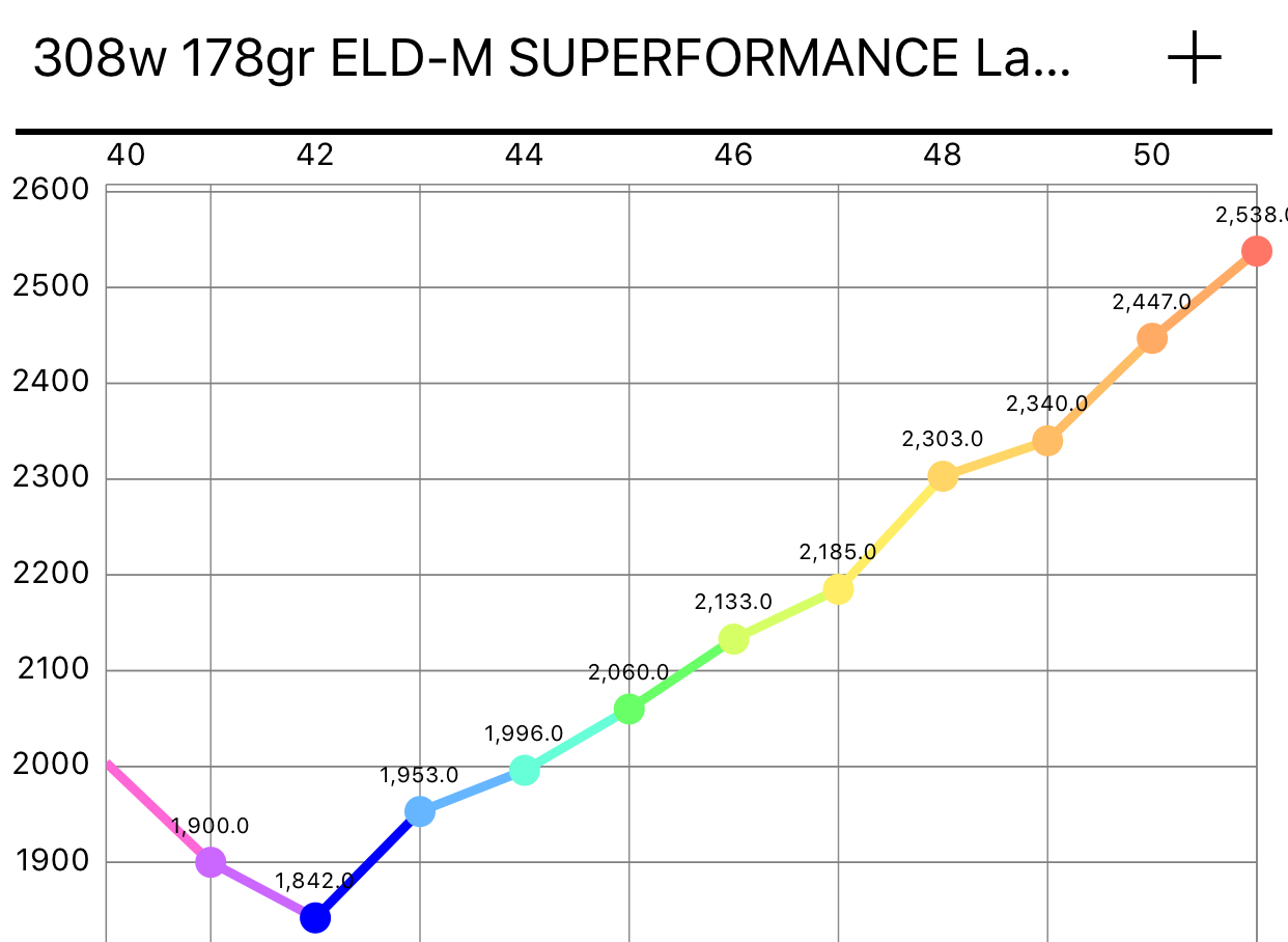

TLDR: it was cheap at $17lbs and went boom.
3 shot avg from a Steyr Scout (18.8” 1:12), Magnetospeed
178gr ELD-M @ 2.83” COAL
Lapua, once fired & neck sized
WLR
Gr / FPS
40 2004
41 1900
42 1842
43 1953
44 1996
45 2060
46 2133
47 2185
48 2303
49 2340
50 2447
51 2538*
*51 grains was very compressed and seated at 2.425” COAL. Under 47gr was very underfilled.
No pressure signs on the primers or cases.
Velocity is low and would likely be finicky. For comparison in the same rifle:
CFE223 46gr 2686, 50gr 2829
RL-15 46gr 2680
AR-Comp 41.6gr 2629
Shockingly, 1200fps video showed no muzzle flash. Where RL-15 is a fireball.
