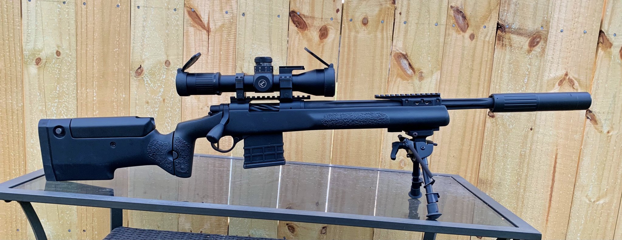

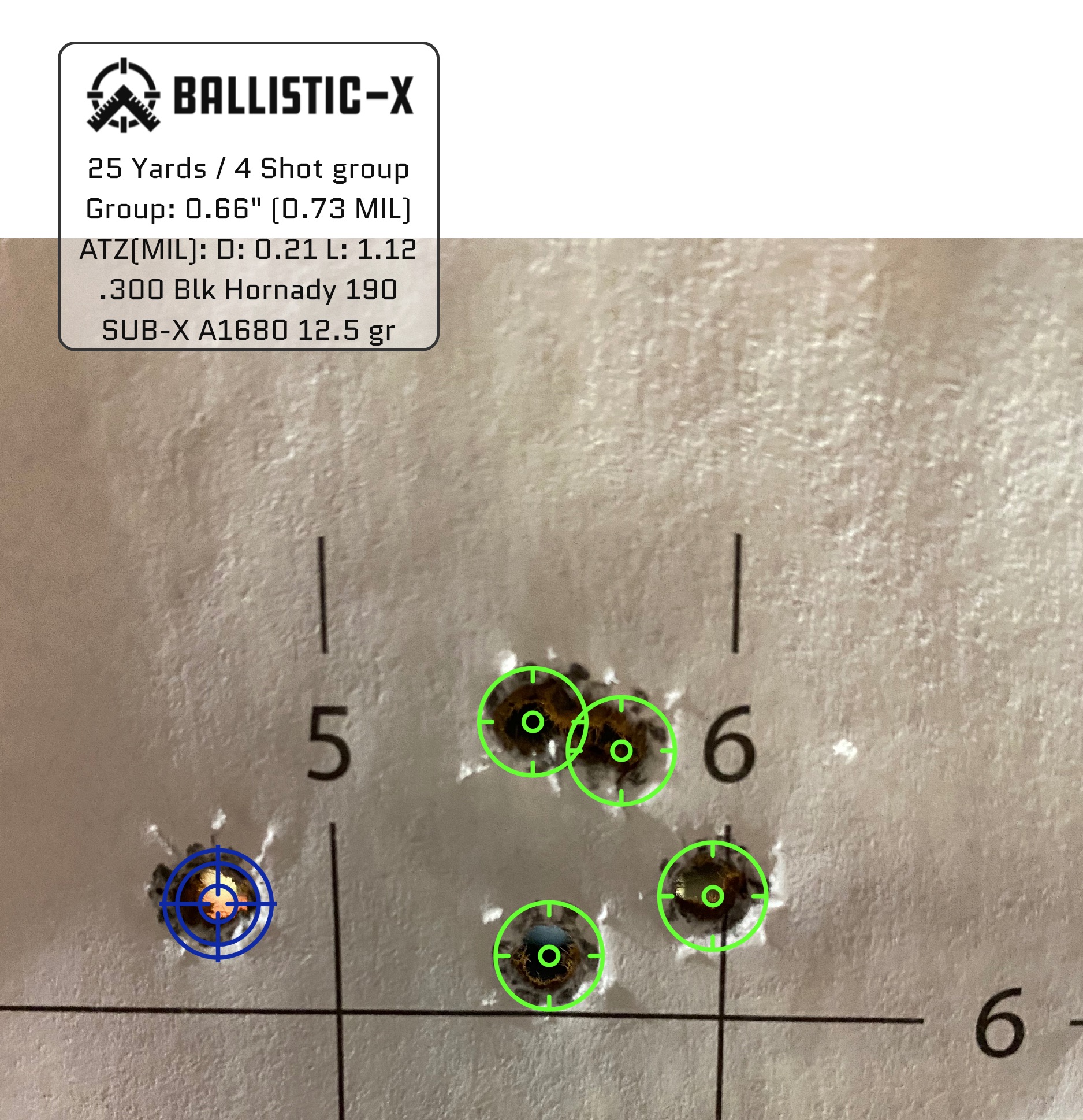

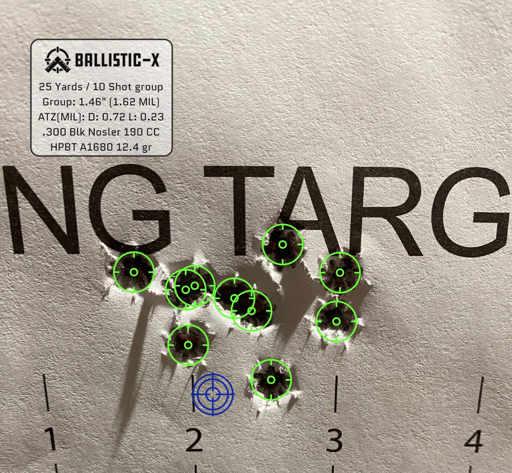

    This is an 8” Seekins with subsonic at 25 yd.
    The 10 shot group is Nosler 190 HPBT and A1680.
    The 4 shot group is Hornady 190 Sub-x and A1680.

    I don't know anything, with that being said that powder has a burn rate similar to that of full load/full power powders for that cartridge, so i would probably look at a fast burning pistol powder. You can't just reduce the speed/charge weight of a normal burning powder and let that be your subsonic load. It doesn't work like that.
    1 moa isn't bad
    i don't see a level on your gun , maybe it's on the other side or you don't have one
    neck turning is for tight neck chambers , if you don't have a tight neck chamber do not turn your cases, the additional case neck expansion is worse then poor cocentricity
    crimping maybe, idk , some people say yes , it may depend on the amount of case neck tension you had, if your already doing .010 then i dont think crimping would help but if it was .002-.005 maybe
    idk about berger hybrids, but the berger vld's have less than forgiving tangent/ogive and you need a chamber made to match that, the sierra's are more forgiving. but if your gun shoots both just fine i guess it wouldn' matter.
    I've shot 220gr Berry's bullets using Accurate 1680 powder at 1144fps that hover around an inch out of a 16" Rainier Arms match barrel. Nice accurate and quiet load, I haven't tried to improve it any. I don't mod .223 brass I shoot Starline FWIW.
