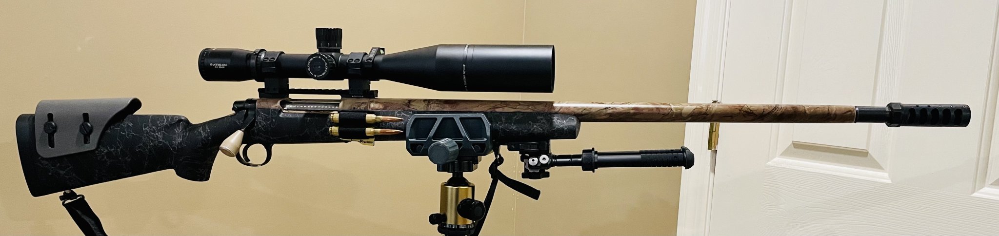

I have a wyatt’s box in mine. It holds 2 plus one in the chamber. Max coal is 3.85. I have a 2 shell caddy on the rifle as well. As far as I know there are no box mags that will allow you to load longer than 3.85. My best load has a 4.1 coal. We single feed them or load from the caddy.
