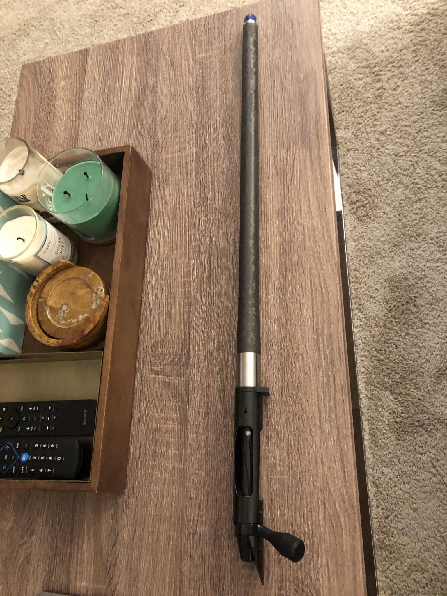

Just received my origin 6.5CM barreled action from bugholes after a 3 month wait :cool:
Time to install my sico asr compatible muzzle brake so that I can use my omega with this rifle. Only thing is I have never personally mounted a brake so I have some questions and would appreciate some advice.
I plan to take it to a local shop where patrons are kindly allowed to use their vice and tools. I intend to secure the barrel in the vise using a towel or something to ensure my new proof barrel is not marred by said vice. I have my sico provided 5/8th shims and understand that I need to get everything timed properly so it lines up.
My question is do I need to use any thread locker or is elbow grease sufficient to keep it from coming off. If I do need to use thread locker is a couple drops of blue locktite before I add torque sufficient?
I know folks like using rockset but I am worried about not being able to get it off and hence hesitant. Appreciate any advice as I have never mounted a brake before. Thanks!
