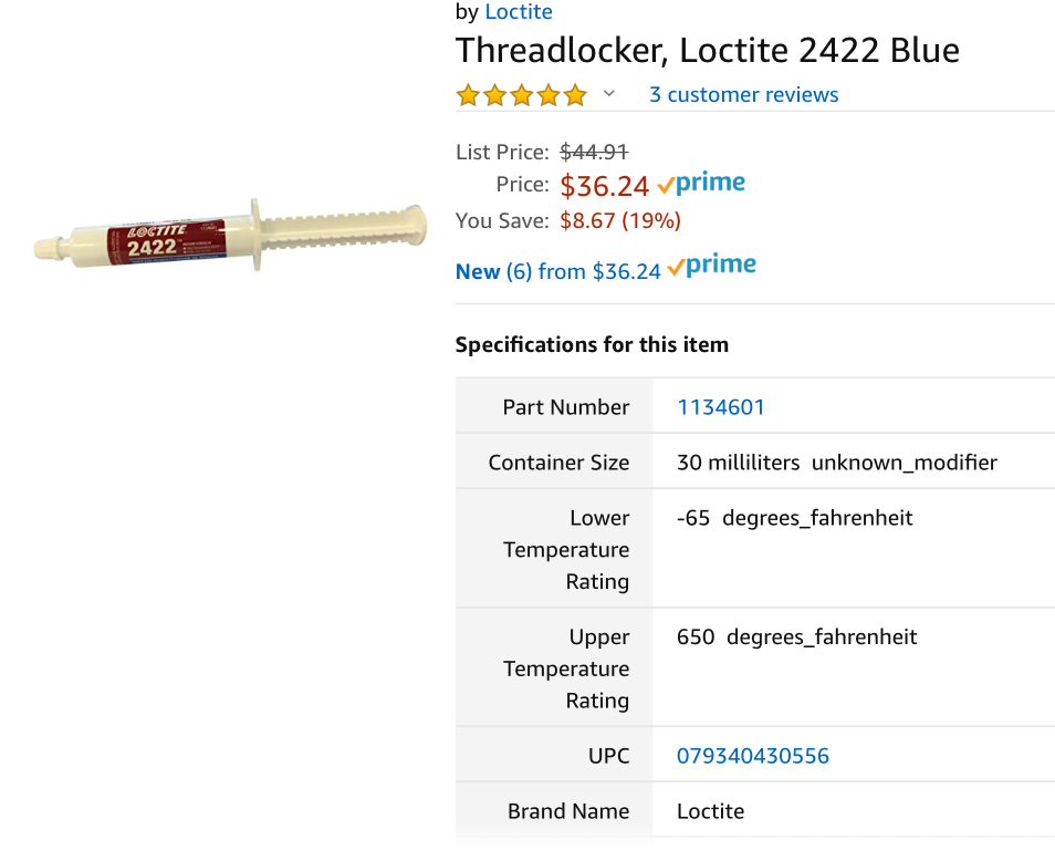

    Goes to 650° F https://www.amazon.com/Loctite-1134601-Tensile-Strength-Temperature/dp/B004RIDDP0

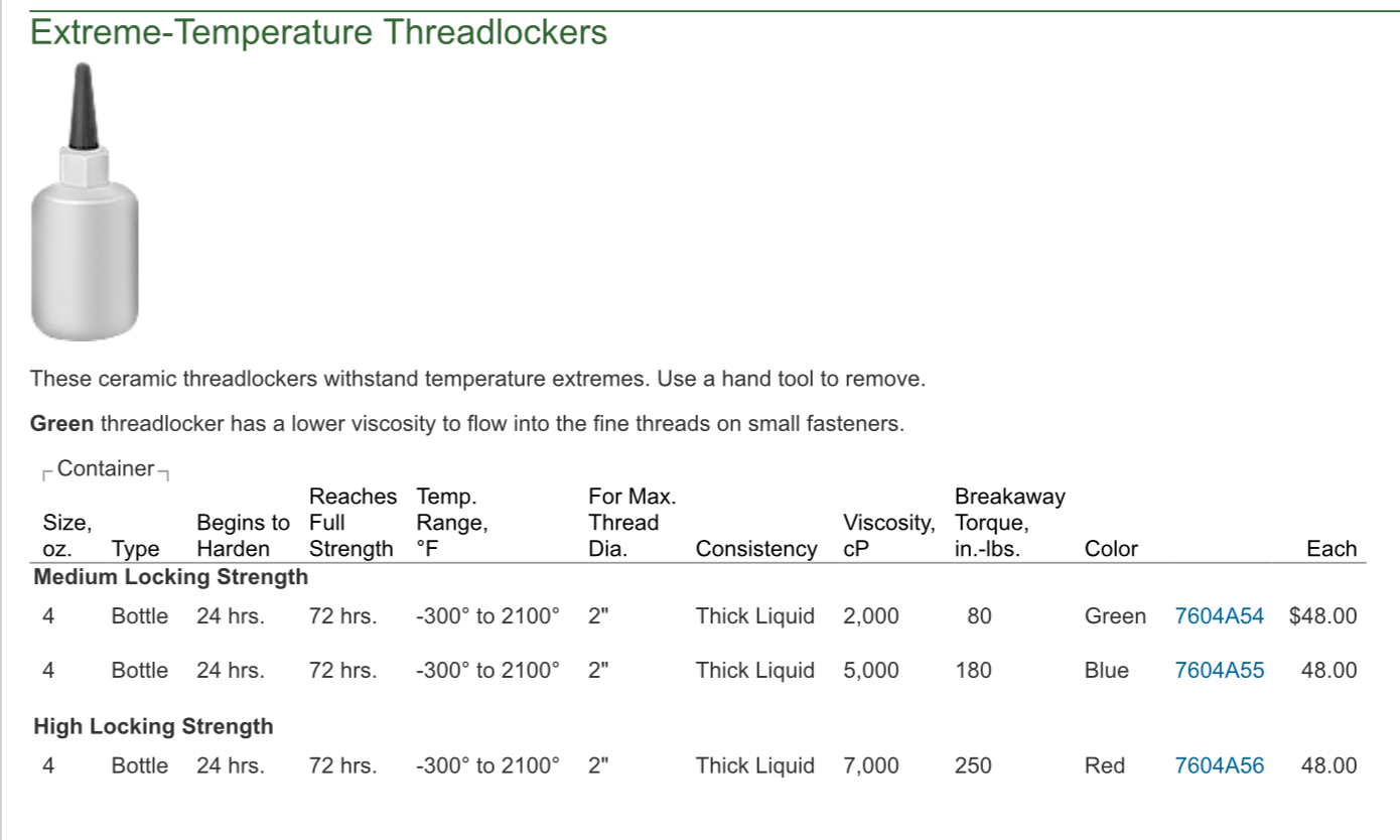

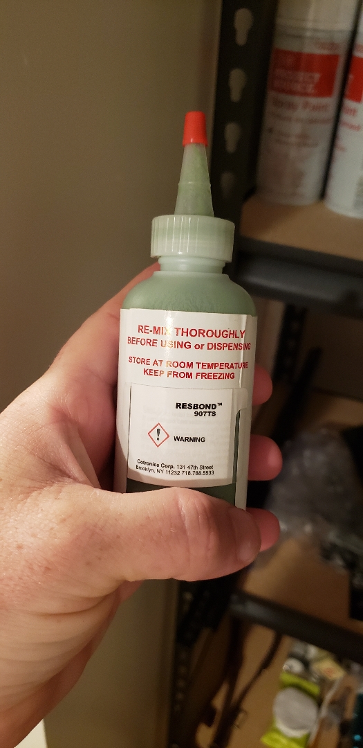

    Ceramic threadlocker. Lowest breakaway 80 inch lbs. rated to 2100° F

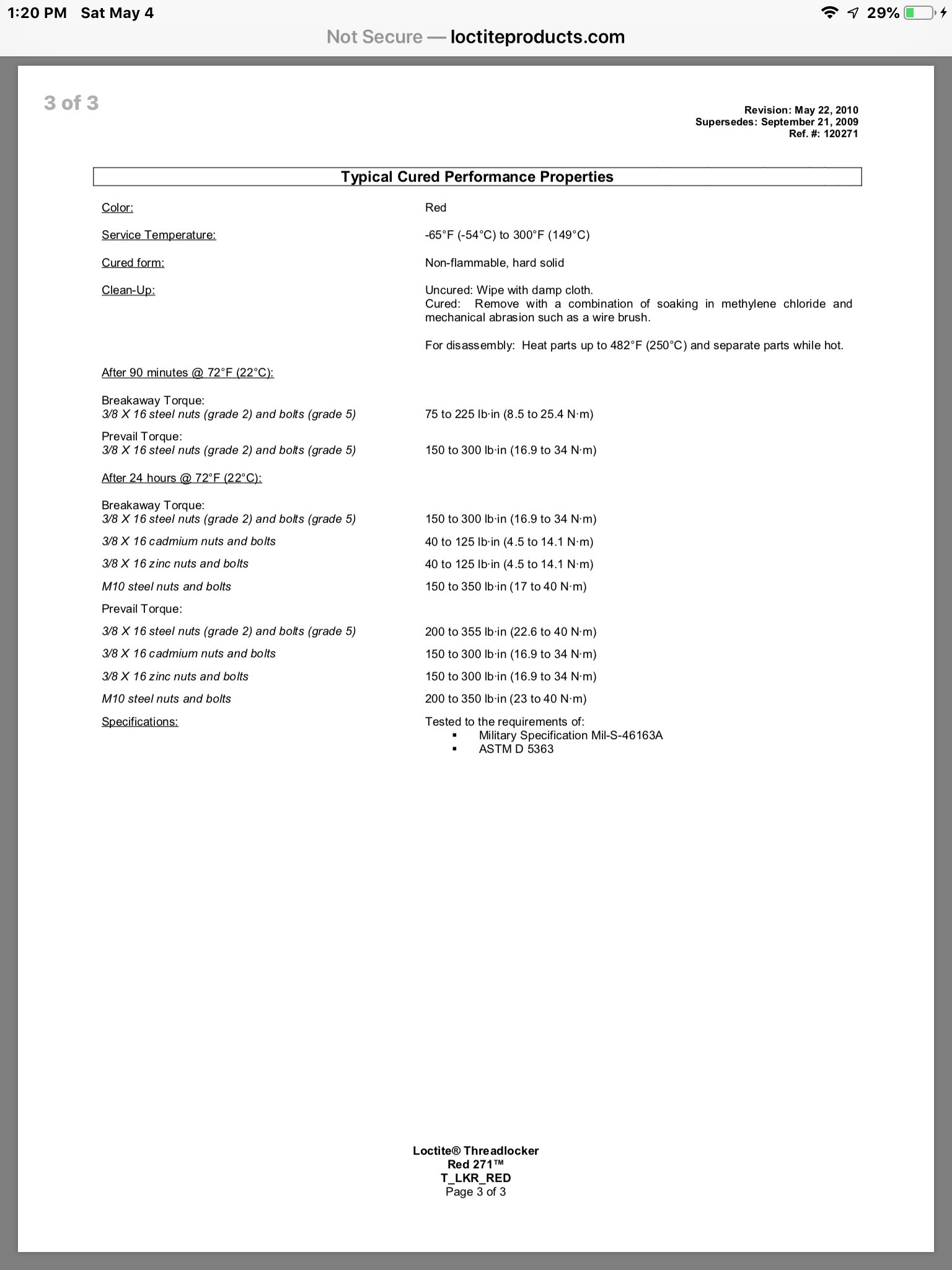

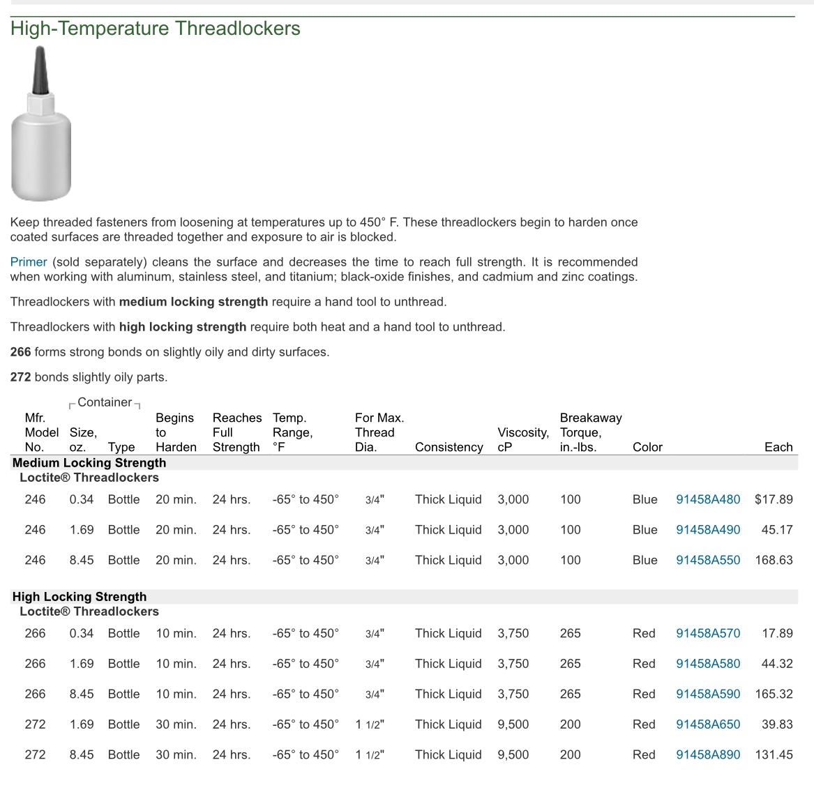

    Were you using 272? As you can see here that only goes to 450° F and breaks at 200 inch lbs. as opposed to 2100° and 80 inch lbs with the ceramic.......

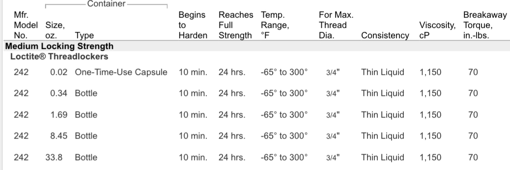

    The stuff he is trying is about 80 INCH lbs. Blue 242 is 70 inch lbs. So the hope is the ceramic stuff he is trying is super high temp blue.

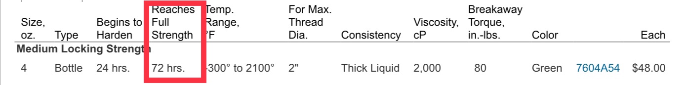

    Should be here today. My plan is to get home and apply it right away, it calls for 24 hrs of cure time and then to the range tomorrow afternoon. Going to run through a few dot drills and positional practices and then check to see if she comes loose again.

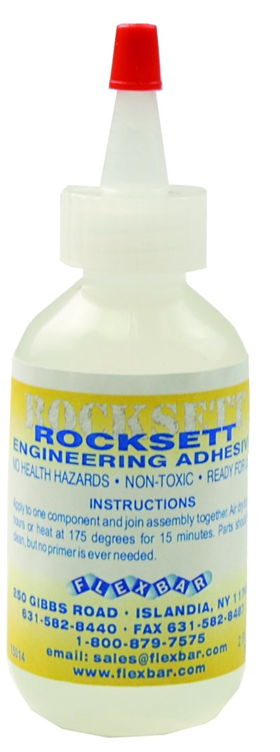

    Rocksett I have used for my ASR brake on my rifles. I've never had to remove them but get the impression that it is harder to remove than I really want. My problem is that the Brake end cap on my Omega 300 keeps coming loose, but I want the option of an easy removal to install my Non-brake end cap should I decide to go that way in the future.
    Careful, “reaches full strength” is “72hrs”........ It only “begins to harden” at 24hrs.
    https://www.amazon.com/Flexbar-15014-High-Temperature-Rocksett/dp/B001C1D800 (edit, just saw its not a prime thing, has 9 dollar shipping which makes it the same price as everywhere else you can find it)

    I just changed out 7 asr brakes to 419 adapters. I soaked the old asr brakes barrel down in a cup of water over night. Put the wrench on them in the morning and a quick tap with the hammer had them broken loose no problem.

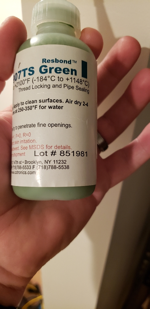

    Well range report is less than stellar. Over all I shot about 80 rounds today, and while I wouldn't say it became loose, I did reach up and test it once at about the 50 round mark and it twisted without much effort at all. Now in the past with nothing on it at all the front brake end cap would actually come loose during fire that I did not see today at all. So I would call it a win, but on the weaker side. It doesn't come loose on its own, but when hot even a small amount of pressure and it will loosen right up.

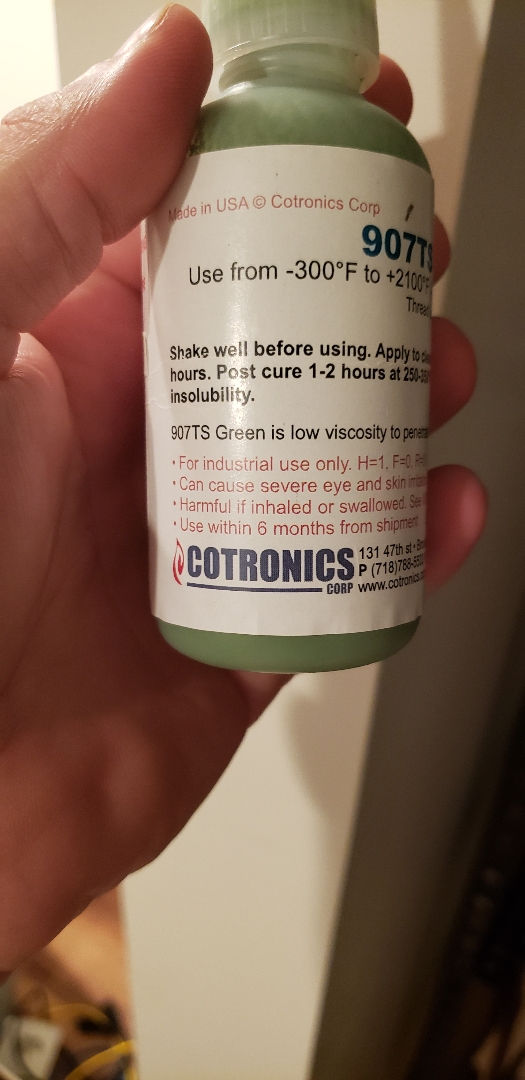

    I think I've found my solution. I do like the fact that it is "tight" but not stuck. It doesn't seem to come loose, during normal use now which before was an issue.
    However should I decide to clean it or want to change the break endcap I feel like I can without an issue which is what I was looking for. Tight but not Locked!!!!!

    The Sico cans can handle water, and all that's needed to break the bond on Rocksett is to soak it overnight in hot water, then soak it in really hot water for a few minutes before taking off and it should come off like a dream. Shouldn't take much either.

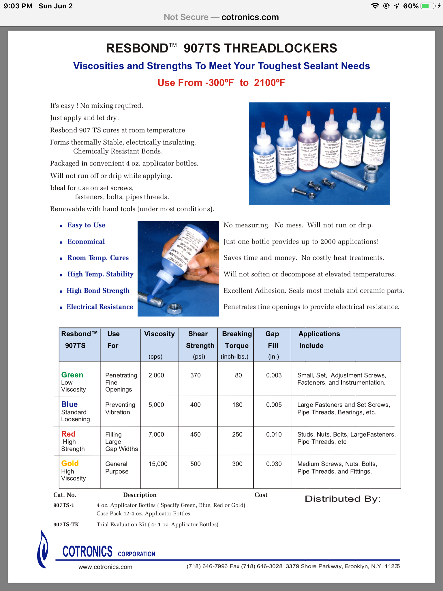

    One drawback: I did not realize that this stuff has a shelf life of 6 months. ugh! In the 4oz quantities it is sold in, that's a problem. Obviously that is before it is applied. I spoke with the Cotronics this AM and they said: :that is the amount of time it is guaranteed for" . My guess is it will actually last a year or more if purchased fresh.
    Huge plus: I also asked Cotronics about cleanup. As you may know regular Loctite requires manual wire brush and/or methylene chloride (or as I call it methyl-death) after it is cured-> *&^$#$% !!!. This product purportedly cleans up with water-soaking after cured with boiling water accelerating the process.
    I still plan to try the blue. If this continues to work well I think a group buy disbursement once a season would be the ticket. Meanwhile I am trying to convince Cotronics to look at this market and consider packaging smaller quantities for us.....
