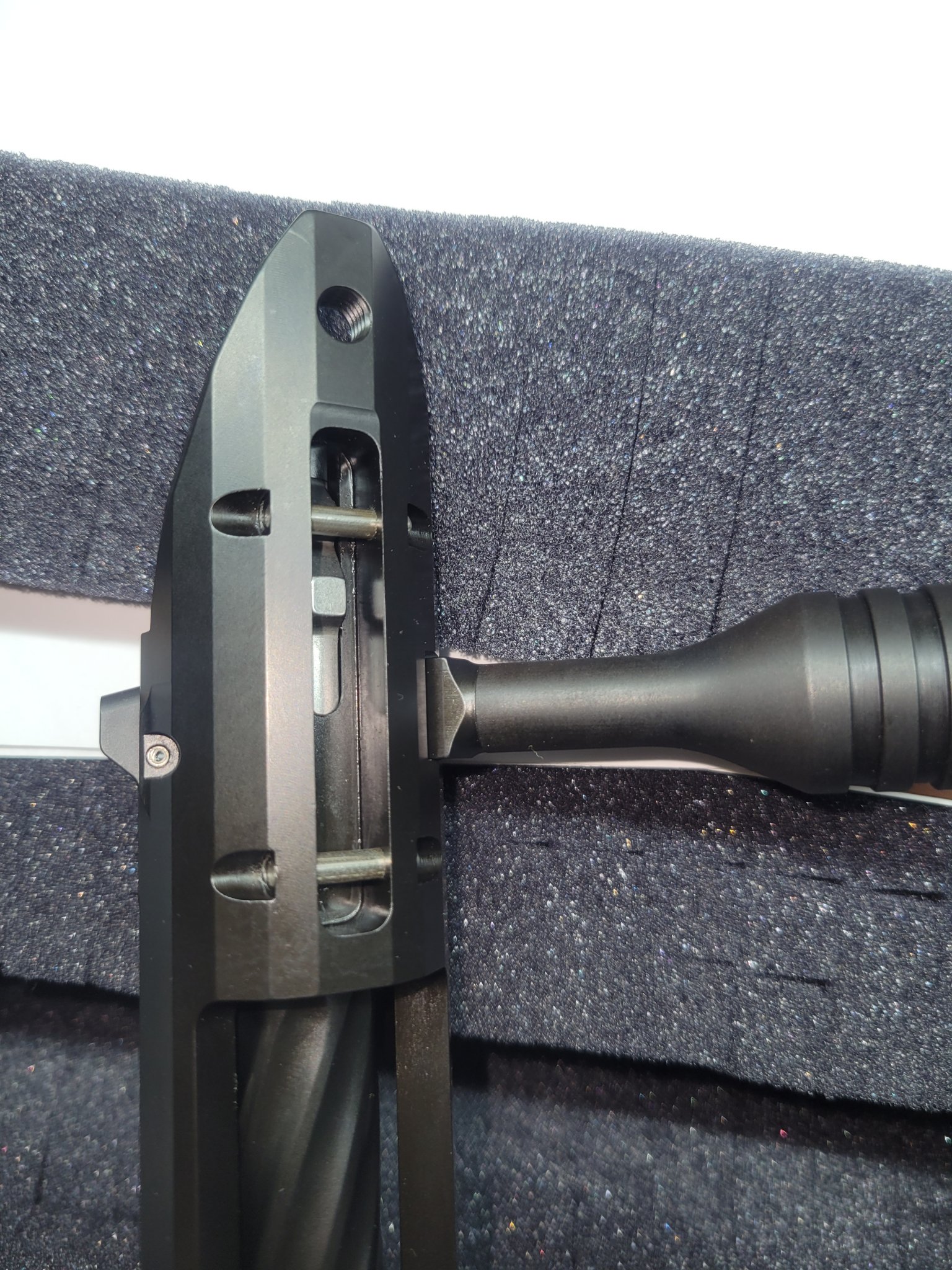

I have a new Fuzion action and noticed the flat spots that were machined in the action from lug to tang. I'm considering all the chassis systems out there like AI, Sphur, MDT etc...
Anyone mount a fuzion into an aluminum chassis system without any issues? I don't want to bed if I have to. The inlets for Remington 700 take into consideration of a round action

I have 3 Fuzions each paired up with a MDT XRS chassis. The core of that is aluminum and no issues with any of them.
You wont have issues. I have 3 on a rotation of chassis and trad stocks
Foundation cuts their stocks to match the action facets perfectly, mine shot very well in the centurion, but also equally as well in a xlr envy pro.

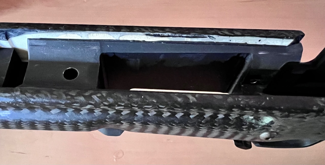

I can pull mine and see if there are wear marks that indicate contact points, if you would like
Fuzions work great in Manners G2 Mini Chassis
That would be an interesting!
Didn’t realize the pics were crap until I had torqued everything back together… sorry
Markings on the receiver wiped off completely (nitriding shows no wear)

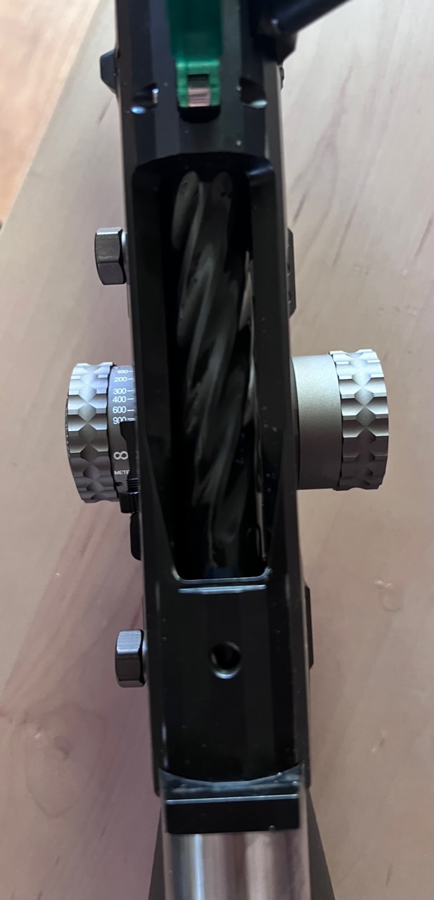

Hard to tell ...doesn't look like much surface area contact...🤔
Would be impossible to tell in the pics. Just wondering How much surface area is in contact with the stock because of the flat milled areas. I'm was worried that because of the milled areas you only gonna get the sharp corners/edges in contact with the stock..which means less surface area contact..which means bedding may be necessary...that's all....
Thanks for taking the pics
It's not a lot of contact on the MCS G2 MC.
There are so many MCS G2 MC/XLR EPs/MDT ACC/Foundation stocks out there, being used frequently by heavy users, virtually none of whom have bedded their chassis... you would know if there was an issue with any of them
