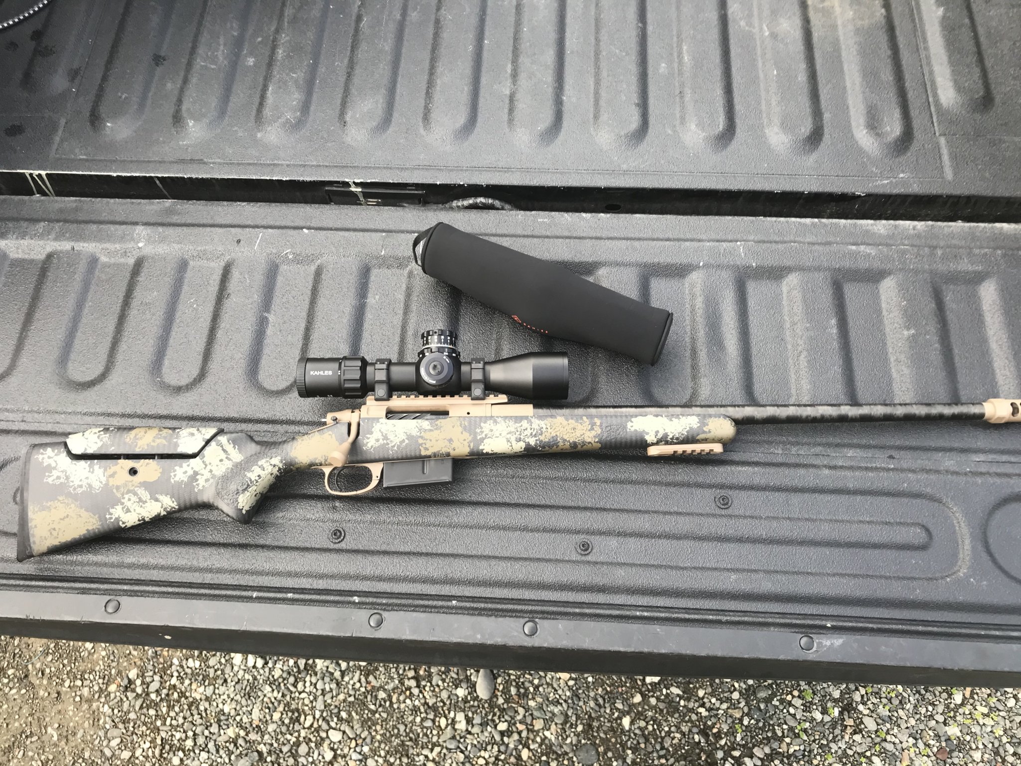

I have a MackBros Ti, it’s what you expect from a custom action.

Specs on mine above: GAP build, MackBros Ti, 6.5 SAUM, Bartlein CFB@22”, APA bottom and break, EH6A, Kahles 318i coming in right at 8.5lbs loaded and sling.
Two of my other hunting rifles 12-14 lbs GAP’s 6.5 SAUM and a 338 WM lighter gun is way more kind when on foot in the bush. The alders are way easier to walk through with 22” barrel still slung and pack on.
