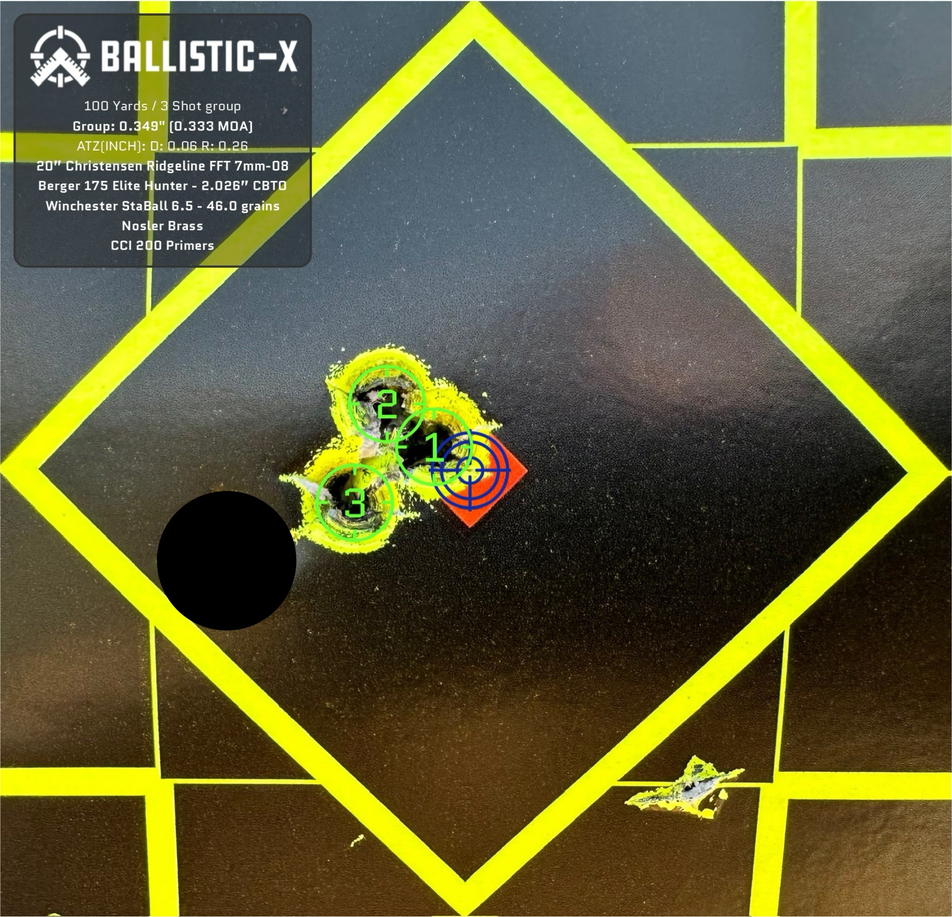

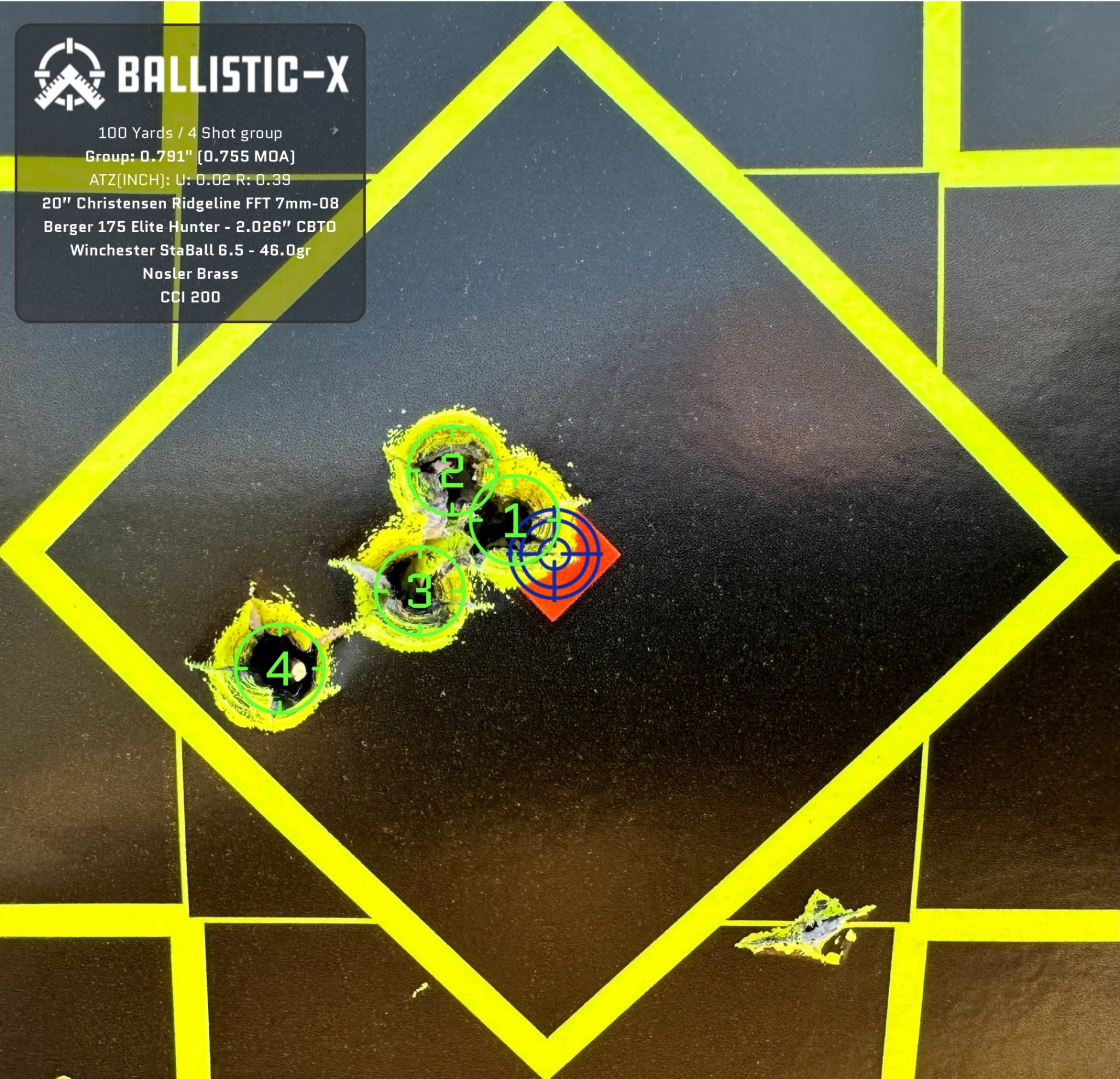

With Winchester StaBall 6.5 I'm pushing a Berger 175 Elite Hunter out of a 20" 7mm-08 Rem at 2,615 FPS MV... Granted, that's max safe load in that rifle, but it shoots 1/3 MOA 3-shot groups and 1/2-3/4 MOA 4 & 5 shot groups. It's a hunting rifle, so it's more than good enough. If you run the ballistics on that bullet at that speed, it's pretty damn impressive.

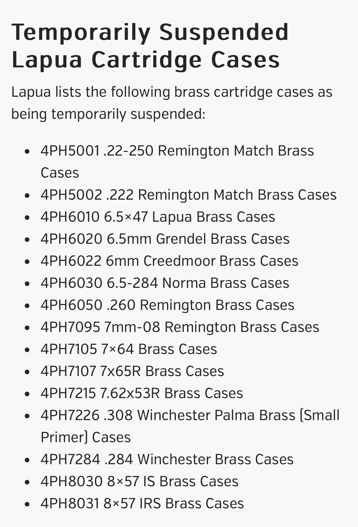

If you want to shoot Lapua brass in 284W you have to buy 6.5-284 and then neck it up. Besides the irony this automatically creates donuts on the first firing so pretty much everyone doing this had to neck turn their Lapua brass. Just something to be aware of.
Lapua makes 284 Win brass, no need to mess with 6.5x284 brass.
Edit: Looks like it's been discontinued.
They will be making it again, it’s on hold due to the Ukraine thing going on. They released a presser about it a while ago. These are the ones they temporary suspended but they are making some of these again based on them showing back up in stock.

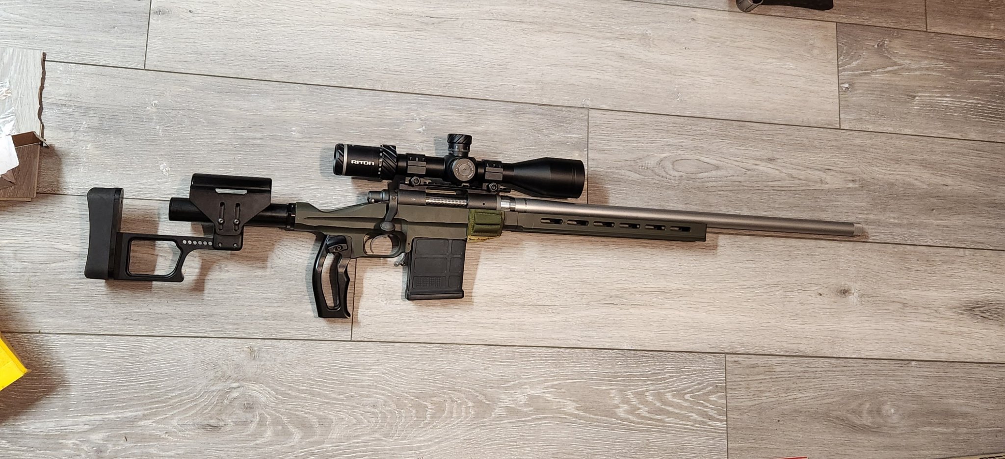

Just built a 24" 7mm SAW 1:8 and sold my 22" 7mm prc. Have this built on a SA but to get the heavier bullets i will swap this into my LA with a standard bolt.
