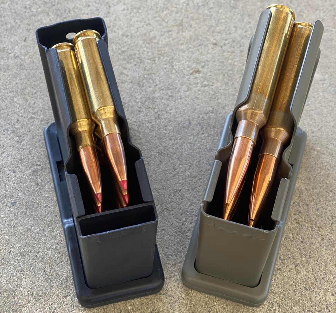

    Realistically I am hoping summer. We printed some protos this week, but have a LOT of irons in the fire now so can't devote as many hours as I'd like to new projects.
    Thanks for the update! Honestly, I’m a little surprised this hasn’t been done yet. If this works, maybe a LA MK Bullpup Chassis will be in my future as well 😉
    Sorry to keep asking you questions - I know you’re busy. Just trying to budget out what I’d need if these mags do, in fact, come out this summer.
    These mags would work in your LA Bullpup chassis, allowing me to shoot SA (308W, 6/6.5CM) all the way up to 300 PRC and 300NM, correct? And it looks like if I ran the Zeus LA QC in your chassis I’d just have to run the cheek piece a little higher due to the integrated scope rail on the Zeus action.

    Correct that mags would all work in the LA chassis-there is an insert to take standard or CIP length mags. And yes on cheekpiece being raised up a touch to clear the rail. Or just sit it on top of the rail to be honest.
