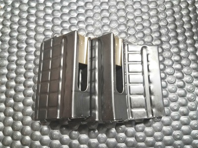

No idea if these will feed 5.56 but they are available along with the oversized recievers

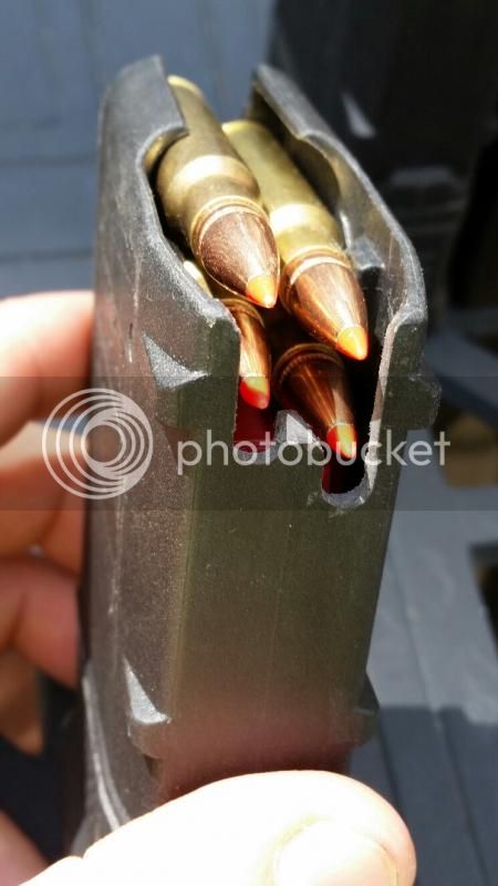

The new Magpul [6.8 SPC] mags will allow for an OAL of 2.32"
https://defensereview.com/magpul-pm...ci-m6-8-uciw-ultra-compact-individual-weapon/

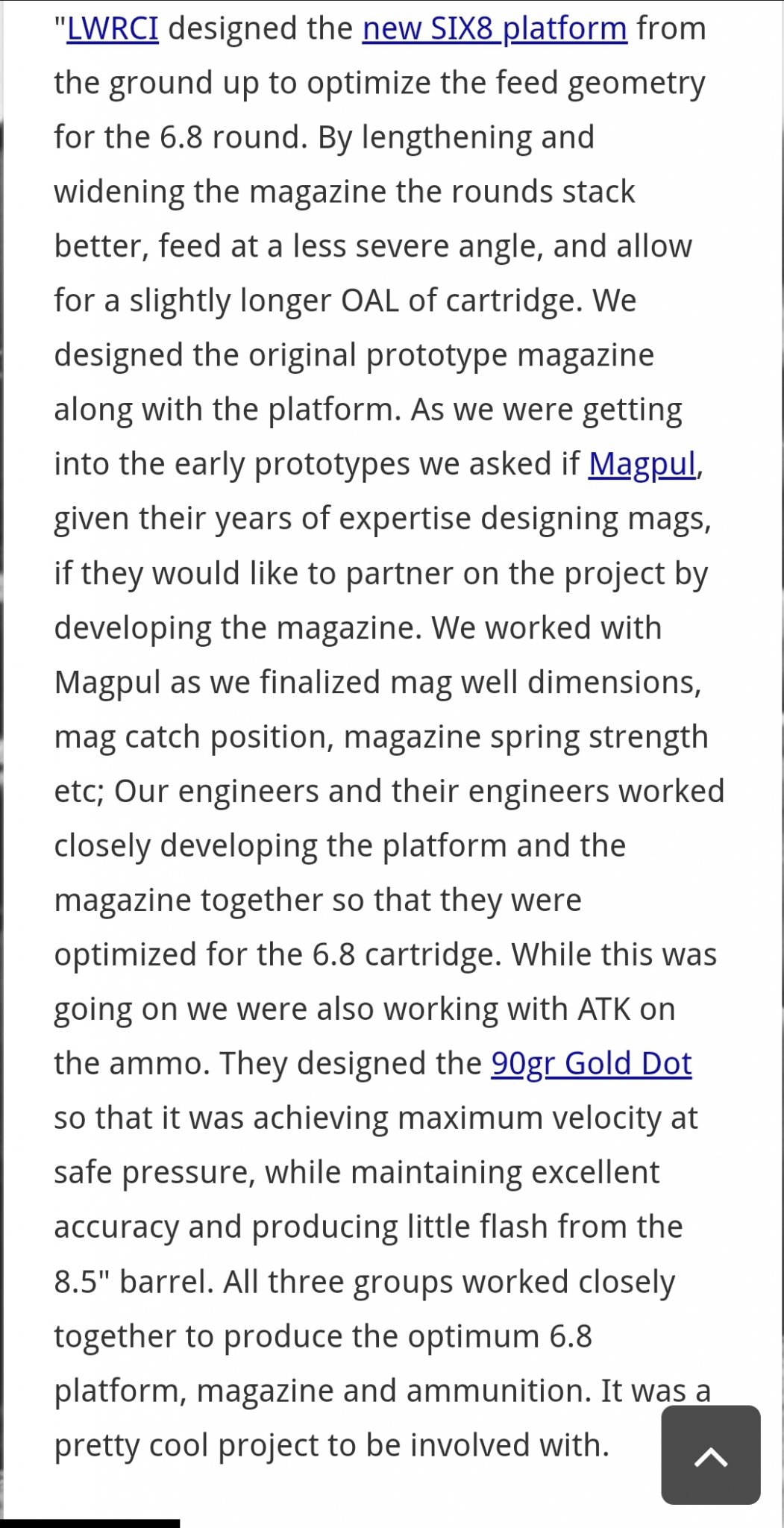

A metal Six8 magazine would be awesome, as it is the plastic Magpul ones are still fairly COAL limiting aren’t they?
These are the special ones for Saudi with non standard dimensions that require a special receiver set.

Wow not much to gain at all. Didn't realize you could get so much with a stainless mag
Why I said a stainless Six8 mag would be cool, but no one’s dedicating the resources to that when the receiver sets are hardly ever available or in circulation and the production rifle isn’t even popular. No market.

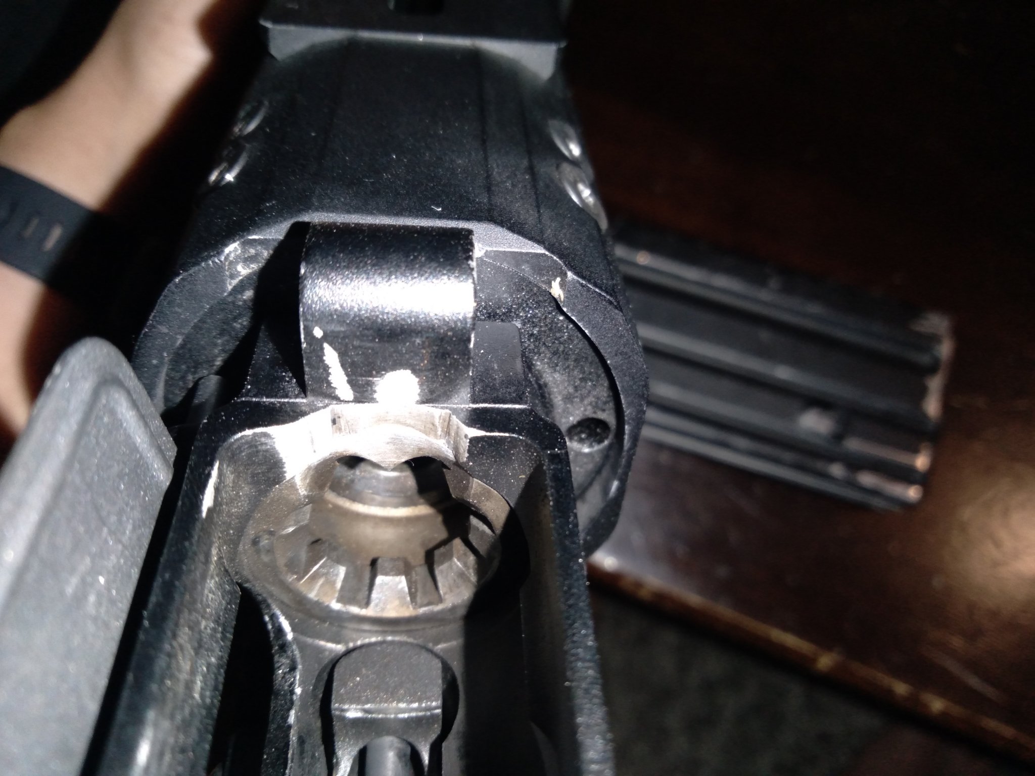

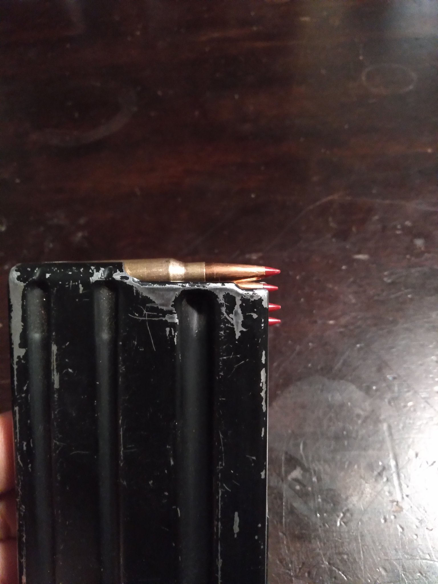

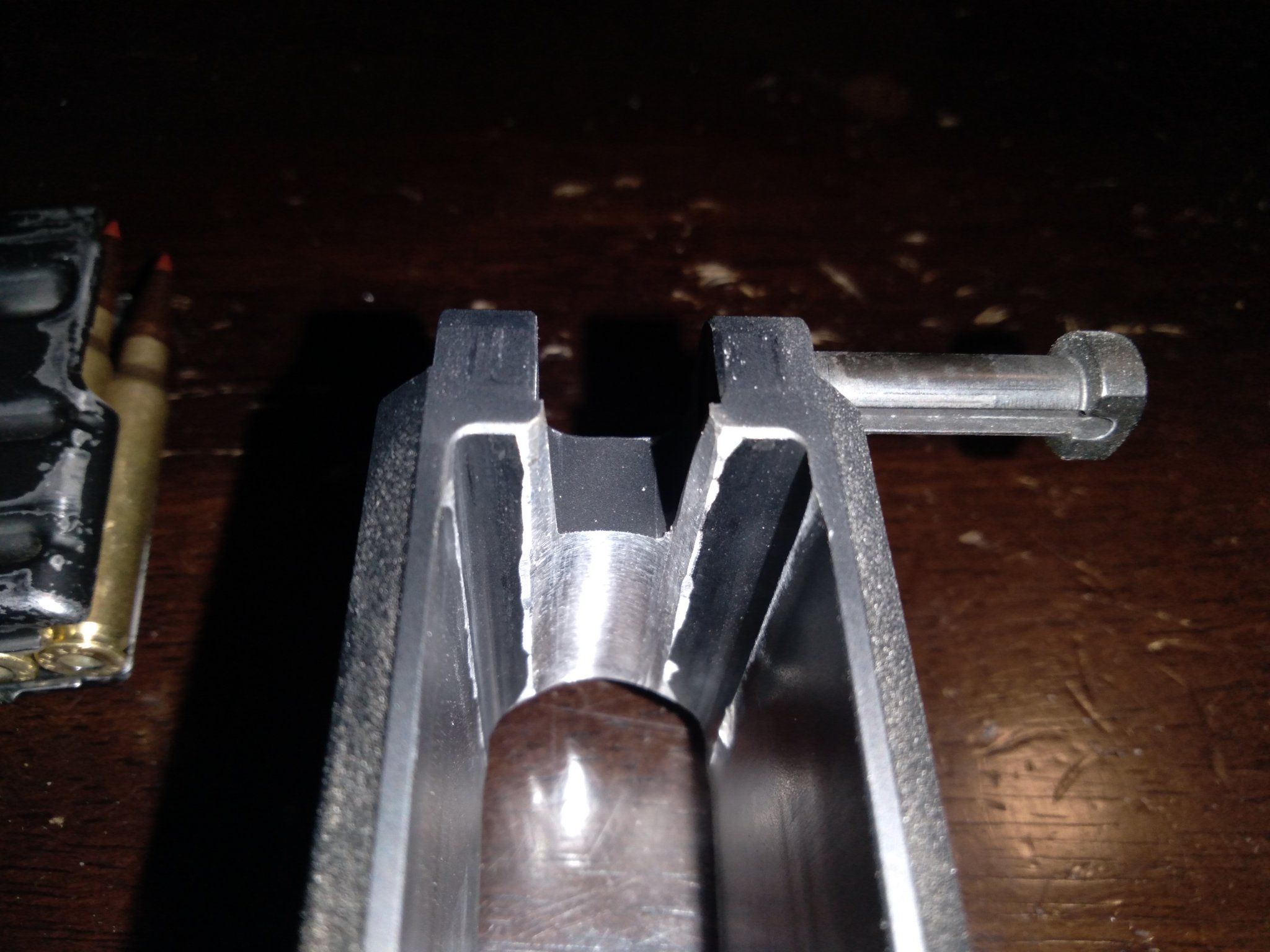

I have also cut the front my mags, my mag well, upper and barrel extension. I load 75gr elds to 2.42oal and shoot them at 2750 from an 18in gun with a modest load of cfe223. Its like they are in a different league vs mag length 77smks. Factory imi 77gr would do 2650 from this gun.
I wouldn't exactly consider it go to war ready/reliable, but it lets me shoot long range matches a cheaper than my large frame guns. Midway has the 75s eld seconds from time to time, but even full price 75 elds are pretty affordable.
I have a 24in barrel i think that ill modify next and put in that upper which should give me an extra ~100fps over the 18in. If i could get to 2900 and keep them 1moa with cfe223, id be pretty happy.
I would like to see pics of your modifications if you care to share.

Its not pretty but it works, and I was able to do it all with a die grinder and file. I may do another like this and next time ill do it a little more proper. I could load all the way to 2.45oal, but thatd be in the lands for this chamber. I think right now im .020 off or so.

The Cavity Back magazine is easy to do yourself if you just have to try it and like to tinker. I suspect everyone knows they use a PRI mag as it's welded front and back. Not sure what my exact max OAL for them are as my notes are in the shop, but 2.35"ish is doable if your magwell will allow. Juice might not be worth the squeeze but for me it was. I know I can seat a 70/75 VLD out there and they like it.
Did the same with a PRI 6.8 magazine for one of my Grendel's and it was also a success. My definition of success is closer to lands, more powder (within reason), and very good accuracy.
I haven't been brave enough to hog out the front of the magwell and scoop out the barrel extention yet.
