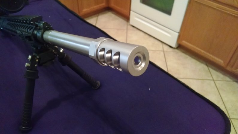

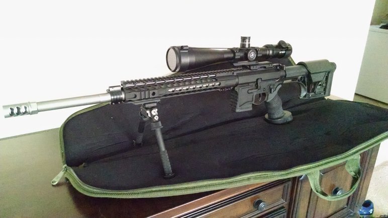

He has them, tell him Jacob sent you, his are far Superior two BAT Barrel extensions. Also JP doesn't sell small frame Barrel extensions just large frame...
Here is a link to my build thread so you can see what they look like, it's the second one down in the picture with a mirror finish..

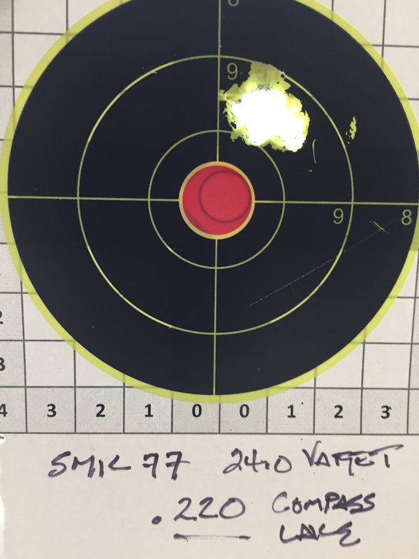

100yds , benched , scoped, bagged front and rear, 168gr FGMM, 7rds ( I didn't want to fubar it ) out of a filthy barrel.. 2-300rds
I'd say the Loctite 609 and receiver face truing worked.

Agree with just letting Compass Lake put one together for you. - great people. Ordered a CLE service rifle w/ Krieger 7.7, Geissele trigger and matching lower. Had it at my door 2 days later.
Have had it about a month now and it's terrific. 5 shot group inside .25", consistent sub .5 MOA the norm.
And I'm new to all this.
