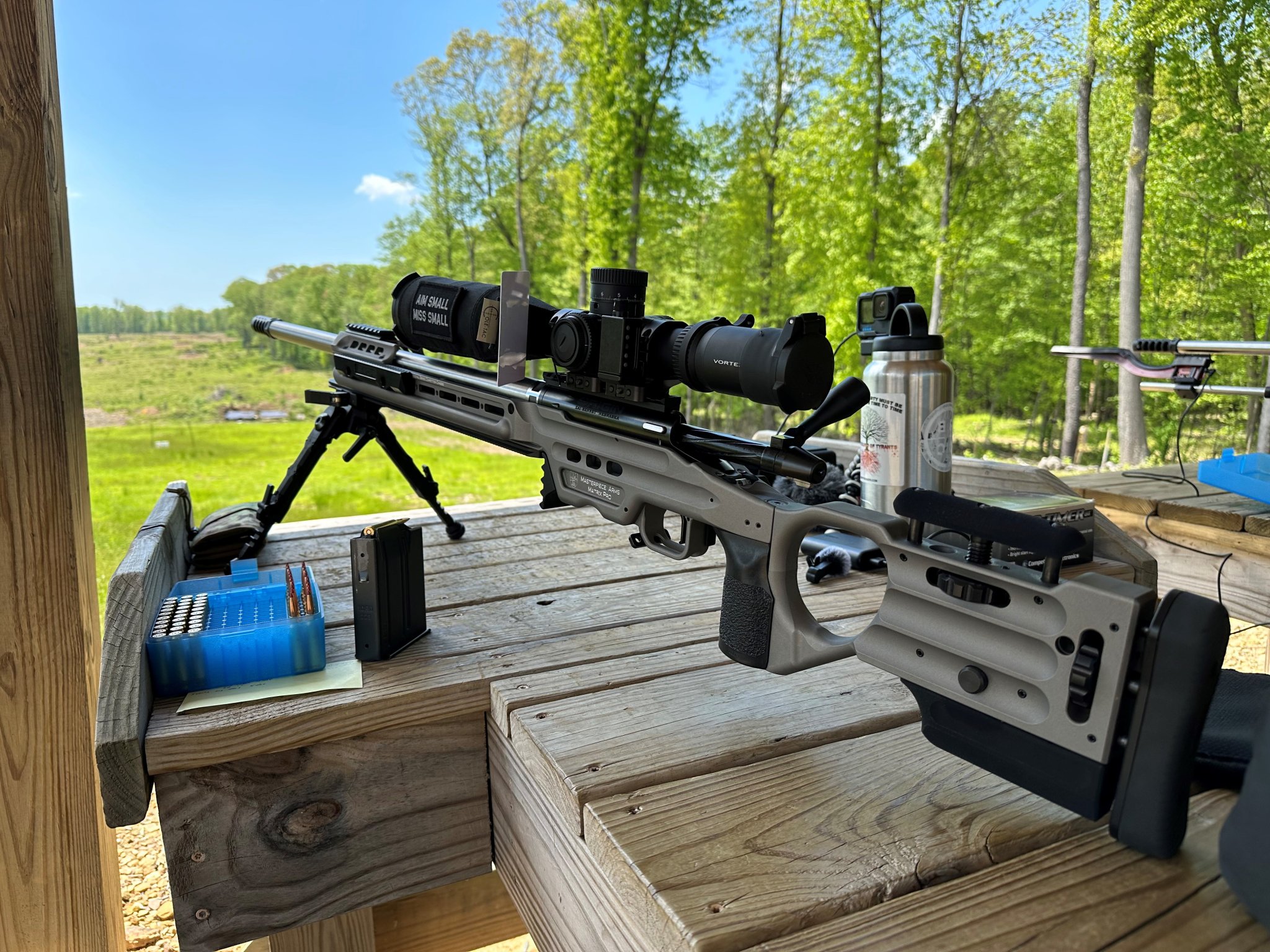

I've seen Phil Cashin from MPA show different accessories generally made to go with a Spuhr mount that can also mount on to the side of a MPA BA scope mount like Data card holders and flip out levels, etc. I was wondering if anyone knows if the Long Range Arms Send It MV3 with S90 bracket can mount on to the MPA mount like it does the Spuhr mounts? I know they use the same size screws, just curious if anyone has tried this set up and if it works, has its faults/doesn't seat right, or just doesn't work at all.
TIA!
